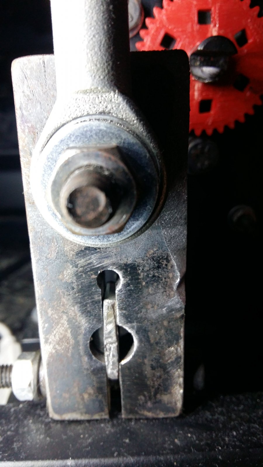

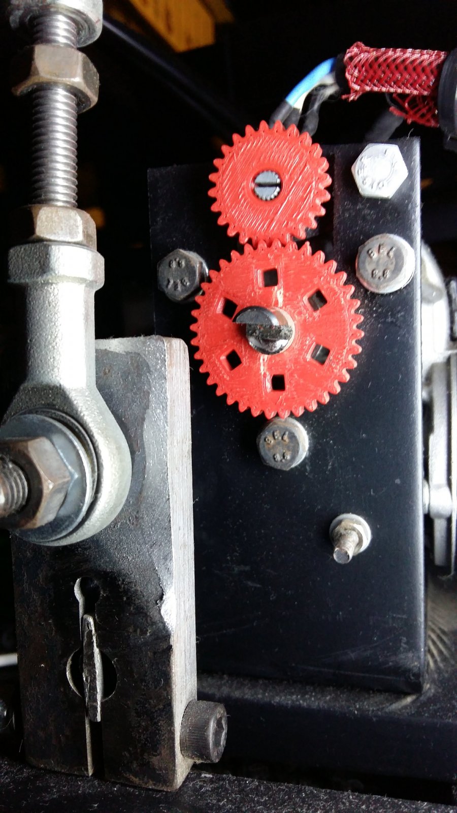

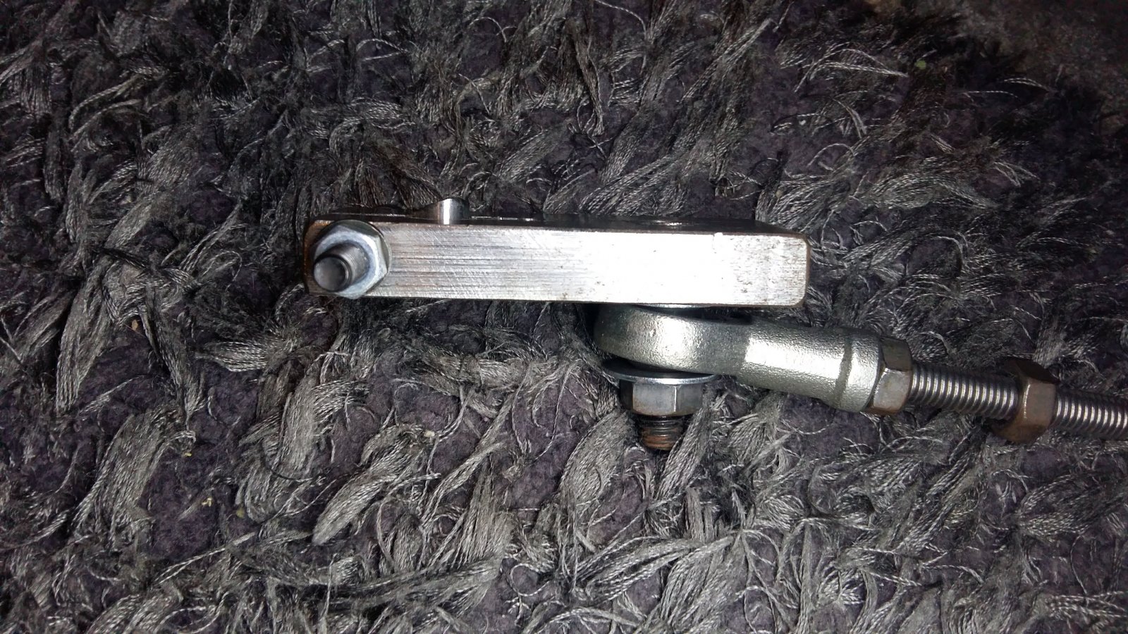

    well... after some months, my motor is broken ( no motor rotate or eletrical... the tip of the shaft !! ) anybody have a sugestion for better construction? see images

    What exactly is broken, the gears? The lever? The axle?

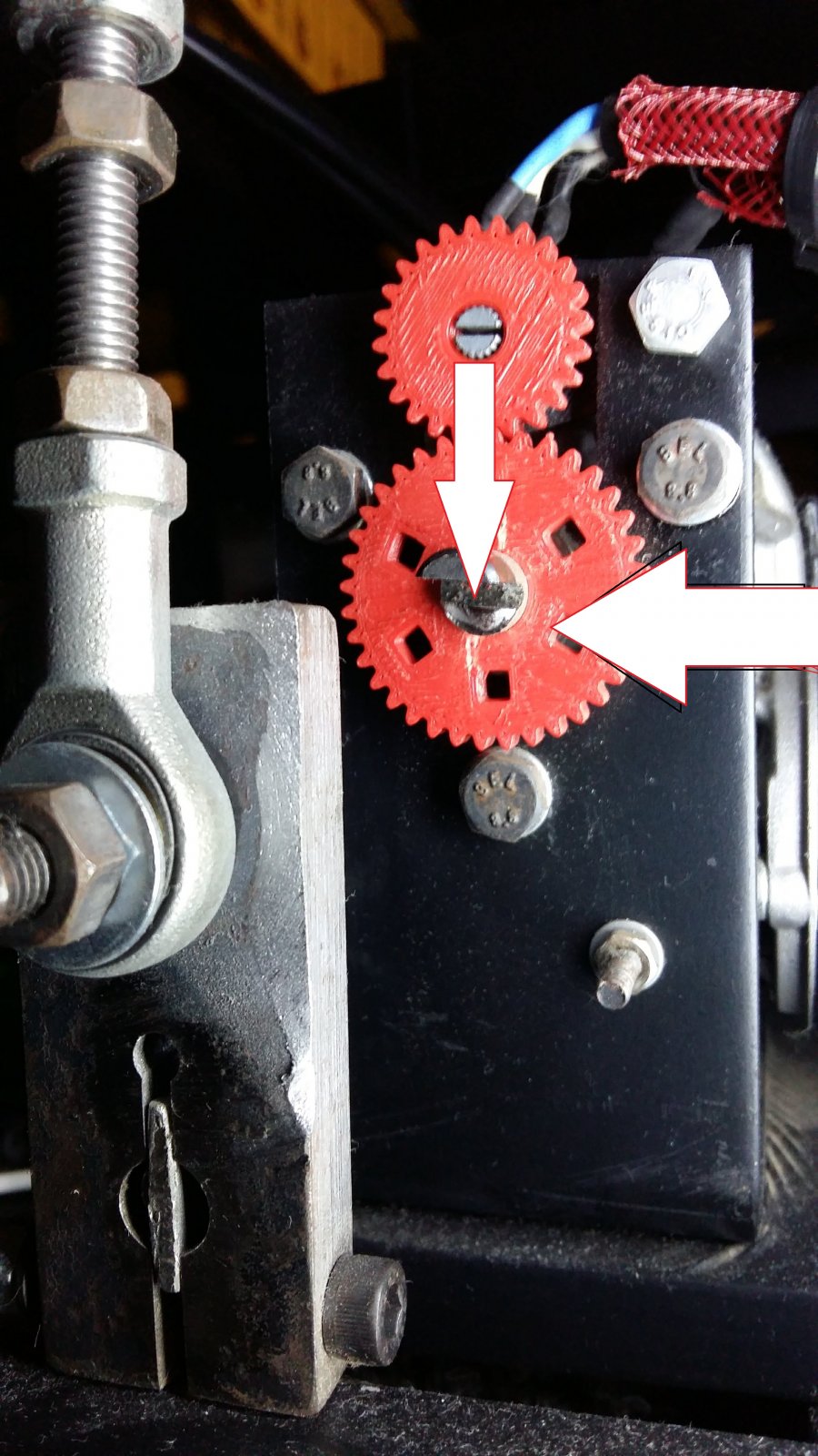

    as show on the first pic... ( big gear ) was the tip, and the piece stayed inside the lever ... now I'm wondering if I do it again the same way, or think of some other way stronger or with less wear.

    if you know a good welder he could repair it. Not in the same way as it was, but repairing the axle should be not impossible.

    Well... i try to fix it now on a "welder" but this axle dont support structure anymore. So i choose change motor and gear ( this one, i print on a 3d printer ) unfortunelly, i couldnt print a motor rs... tks anyway !

    +165 / 2 / -0
