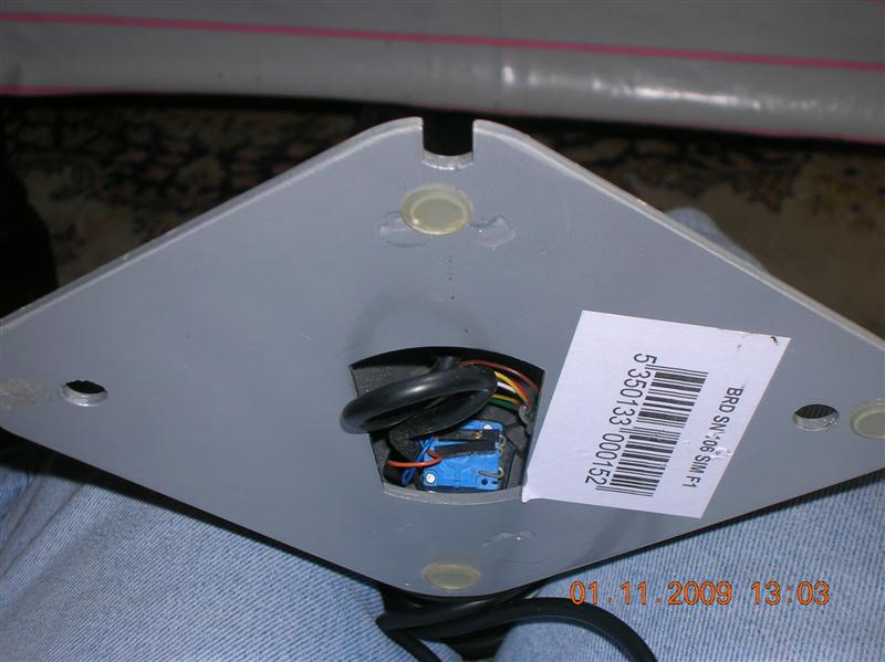

    In 2006, I bought a new but very cheap gameport steering wheel from BRD (Ballracing development). Because I don't have the space to build a motion simulator just yet and because I don't have any hardware at the moment to play race games, I'm not going to buy a new wheel. So I want this wheel to work for now.
    Problem is:
    * I don't know how to get this wheel to work with XP home SP3. I don't want to buy a gameport to USB converter, it's not certain that it will work.
    * I don't know if the wheel itself still works. But 4 LED's on the wheel flashes when I connect it to the gameport (I bought a Trust 5.1 soundcard with gameport onboard) and when I press the buttons.
    * I installed windows 98 and still no reaction in windows what so ever when I connect the wheel to the gameport (found the trust 5.1 win 98 drivers). I even tried with a virtual_machine win 98 installement.
    So my question is:
    Is there a cheap way to convert the 15 pin gameport to a 9 pin serial port and use the X-sim² software to convert the signals?
    I have a R323 to USB converter from Velleman to make the K8063 work and maybe I could use this conveter if it is possible to convert the 15 pin gameport into a 9 pin serial port (R323).
    Will this work? => http://www.x-simulator.de/main/en/hardw ... rface.html

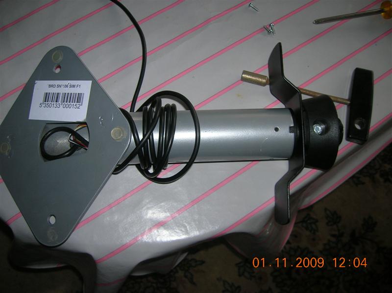

    Yes, it does. I tnink there's something wrong with the electronics.
    I found a solution though. I'm going to convert the steering/pedals into a USB device. It's a non FFB gameport wheel, so no problems there.
    Thanks for the help.
  7. CXCSimulations
    CXCSimulations Member
    Dec 19, 2008
    143
    - 9Coins
    Yes, that's a great idea. If you're not afraid do do a little soldering, THIS product will be perfect for your purposes.
    If you like, take pictures of the wheel internals and and I'll try to help you connect your wheel to the new controller board here.

    Thank for the help! I accept your offer. ;P I've visited your site a few times.
    I've been thinking the same thing. But I dodn't know which one is the most suitable solution for this little DIY project. The BU0836 - the BU0836X - BU0836A or the BU0836 -LC.
    I wrote an email to Leo with some questions regarding his joystick controller but I haven't got an answer, yet. I also registered at his forum but the admins don't activate my account.
    My idea was to use the electronics of a Logitech joystick, the Attack 3. But the potmeters travel, the ones that I bought (100k and 270° turn) is too long and I can't get them calibrated, properly .
    I think I'm going to order the BU0836. But Leo told me on eksimracing that I could pay by bank transfer. As long as he doesn't answer my email, with his bank account number, I won't be able to pay.

    I think the base BU0836 would be all you need for this simple conversion. I would think it would be pretty easy for you to integrate that controller in that wheel.
