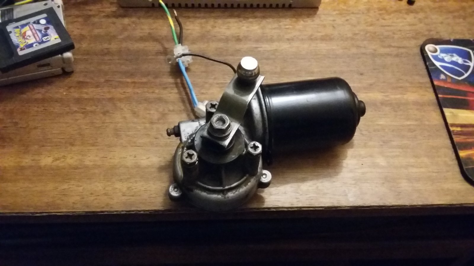

    I've connected both to the monster moto and i've made all the wiring. The isolation was done by cut a black wire from inside the motor to the metal chasis outside, and everything worked as expected except for one thing. One of the motors doens't turn so fast as the other one, also it makes a srange noise and after a while it heats. Before the test i've opened it and I messed up the brushes, and in the gears i've found a piece of it, it was removed but the problem still present. On a last test i've removed the gear and the motor works ok, so, what i can do? i need some lubrication or i need to grease the gear amd maybe the motor itself?

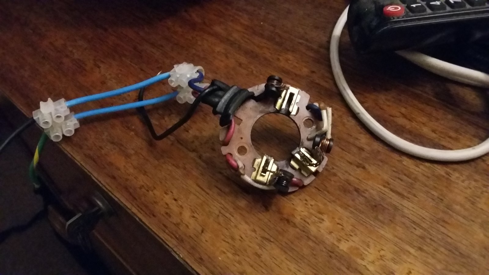

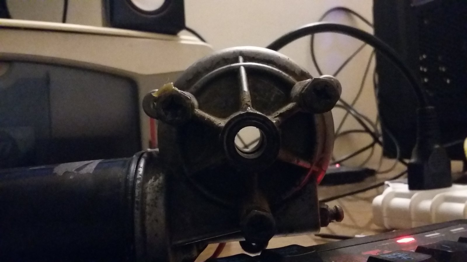

  5. Pedro Pablo
    Pedro Pablo Active Member
    Dec 7, 2015
    119
    Software Developer
    Valparaiso, Chile
    599Coins
    +47 / 0 / -0

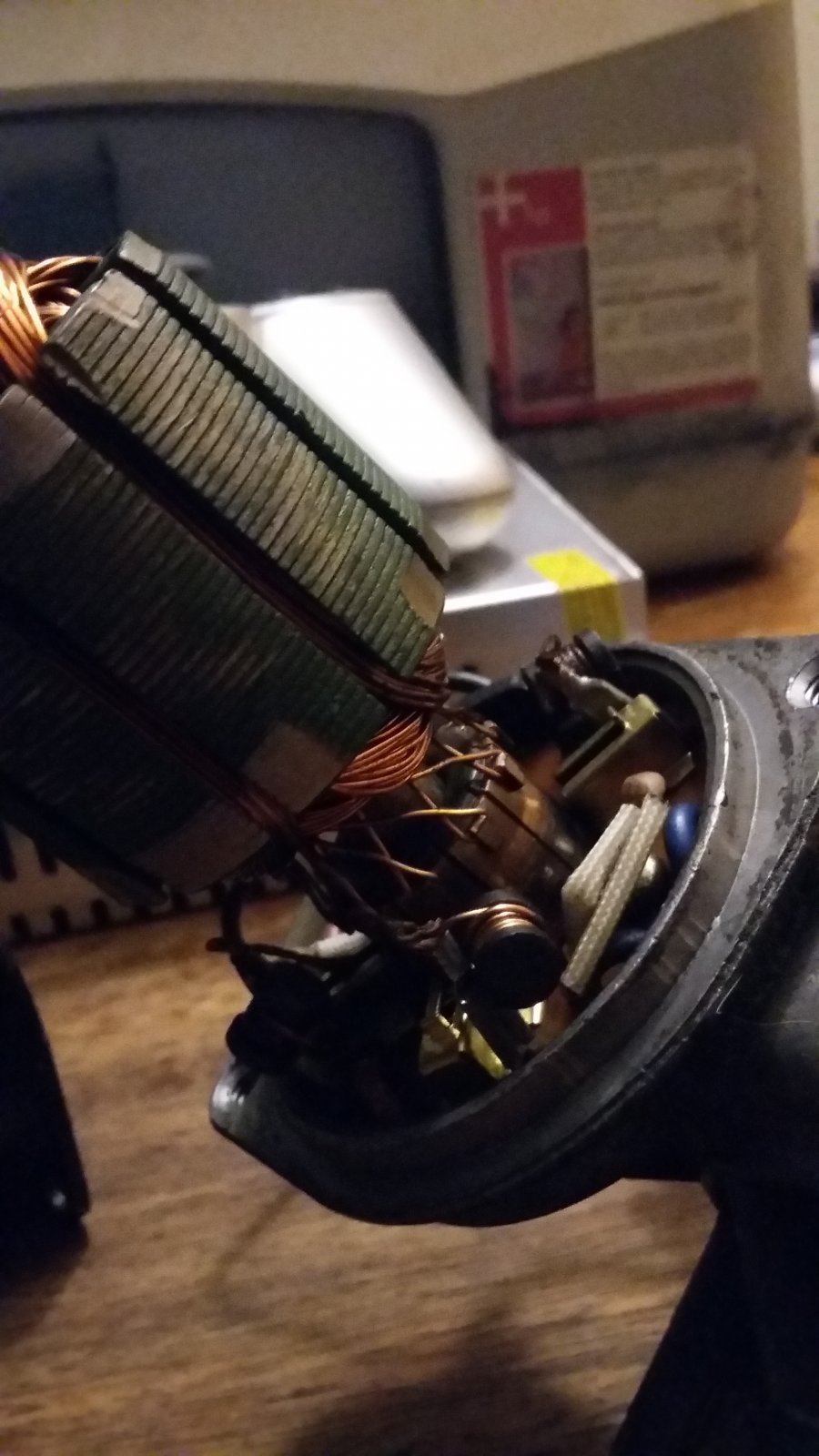

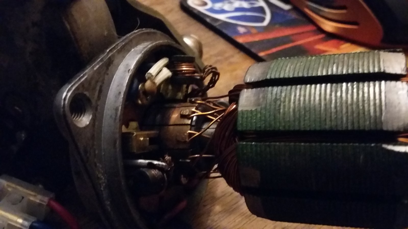

    Hi @MarcNSF. sorry for the waiting but here are the photos of the motor. I've cut one motor brush and also i've took off the black cable, assuming that one is the ground that I need to isolate
    20170713_010627.jpg 20170713_010659.jpg 20170713_010639.jpg 20170713_010647.jpg 20170713_010530.jpg

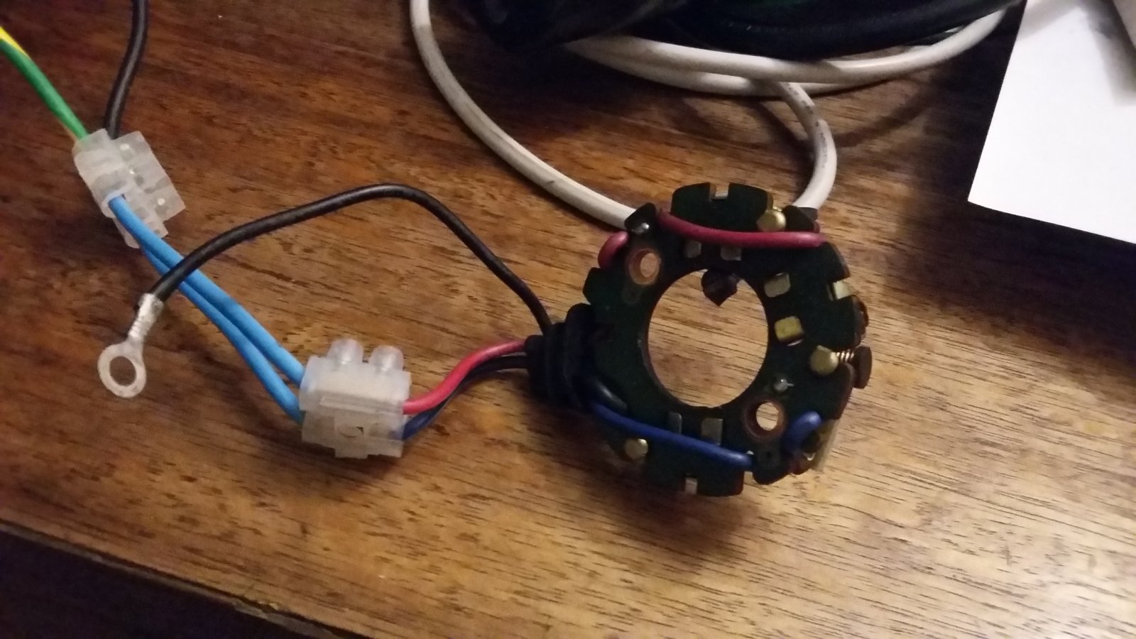

  6. MarcNSF
    MarcNSF Marc
    May 24, 2017
    66
    Lebanon
    - 97Coins
    +42 / 0 / -0

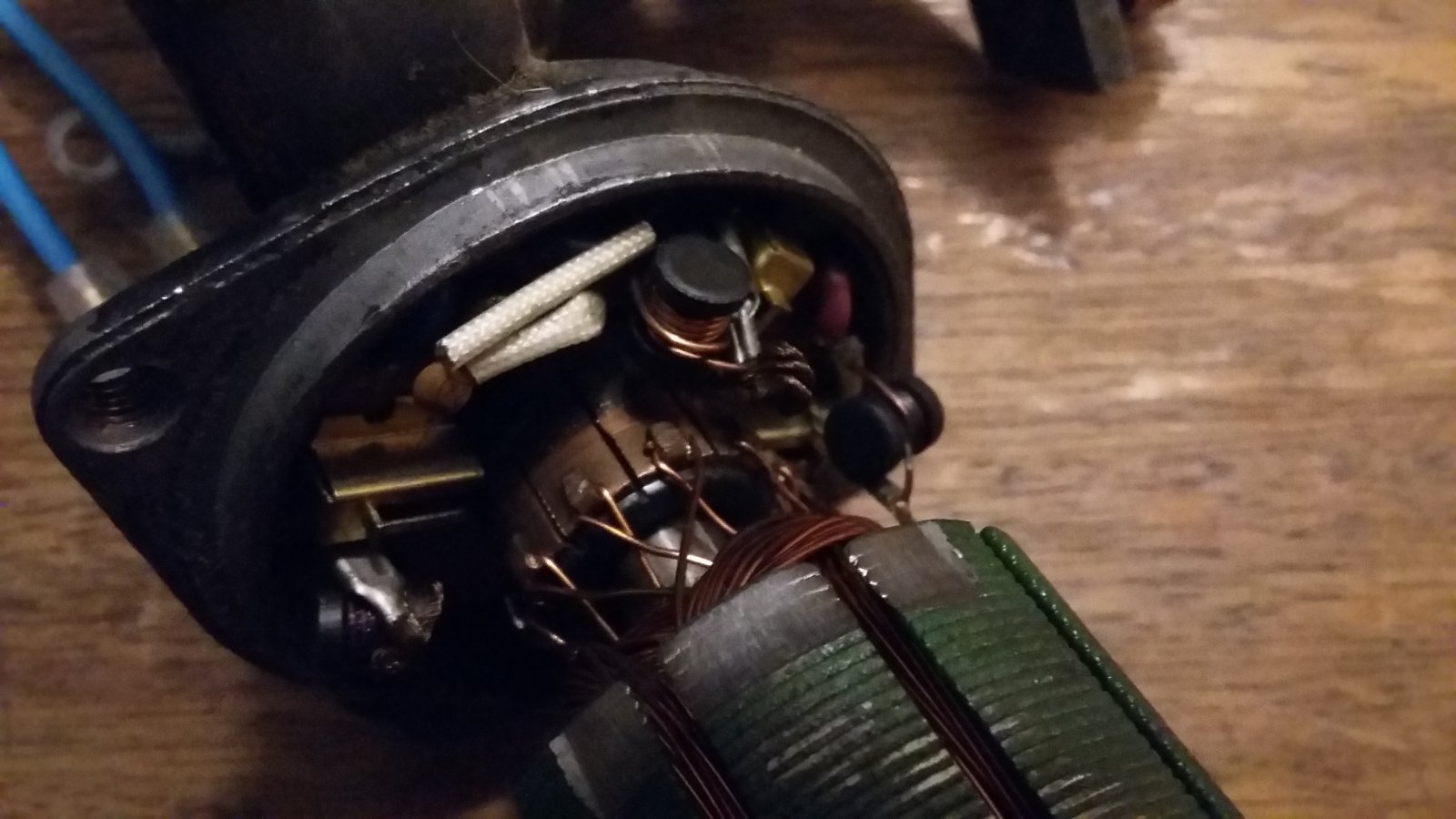

    Lift the board and Check under it, you should find a wire from the brush to the chassis you have to cut it
    The 2 carbon brushes on opposite direction are the ones that you will use
    Keep me posted:thumbs
    Regards
    Marc

  8. MarcNSF
    MarcNSF Marc
    May 24, 2017
    66
    Lebanon
    - 97Coins
    +42 / 0 / -0
    If you connect the high and low speed to 12v that will cause the heat and sound of the motor
    Only connect the 2 carbon brushes on opposite direction ,this will move the motor at high speed
    Marc
  9. Pedro Pablo
    Dec 7, 2015
    119
    Software Developer
    Valparaiso, Chile
    599Coins
    +47 / 0 / -0
    Well, i take of the motor and the board looks like this. So, i have to keep the brushes which are face to face?? Let's say, the red and black one. Well, i've take off the black brush because I've assumed that's the way to isolate the ground. But at least I have some messing around to solder again

    It's me again. I've do another test, now i've connected the motors directly to the PSU instead of using the Monster Moto
    Bad news: The problem still present. The motor from the top still vibrating and it goes more slow than the other one. Only it vibrates when I screw the lever, but also when I put upside with or without the lever. I think that the gearbox is messed up, maybe some grease will fix it up, but i'll try to see another options because like i've said before, i need a lot of luck to find an exactly equal wiper motor. Any advice?
    Good news: Following the wiring advice from @MarcNSF the motors now it doesn't heat so soon. I measure the time and about 8 minutes working without heat, and about 10 minutes a bit warm. Kinda curious because the motor below (the good one) heats more soon than the other one (the bad one)

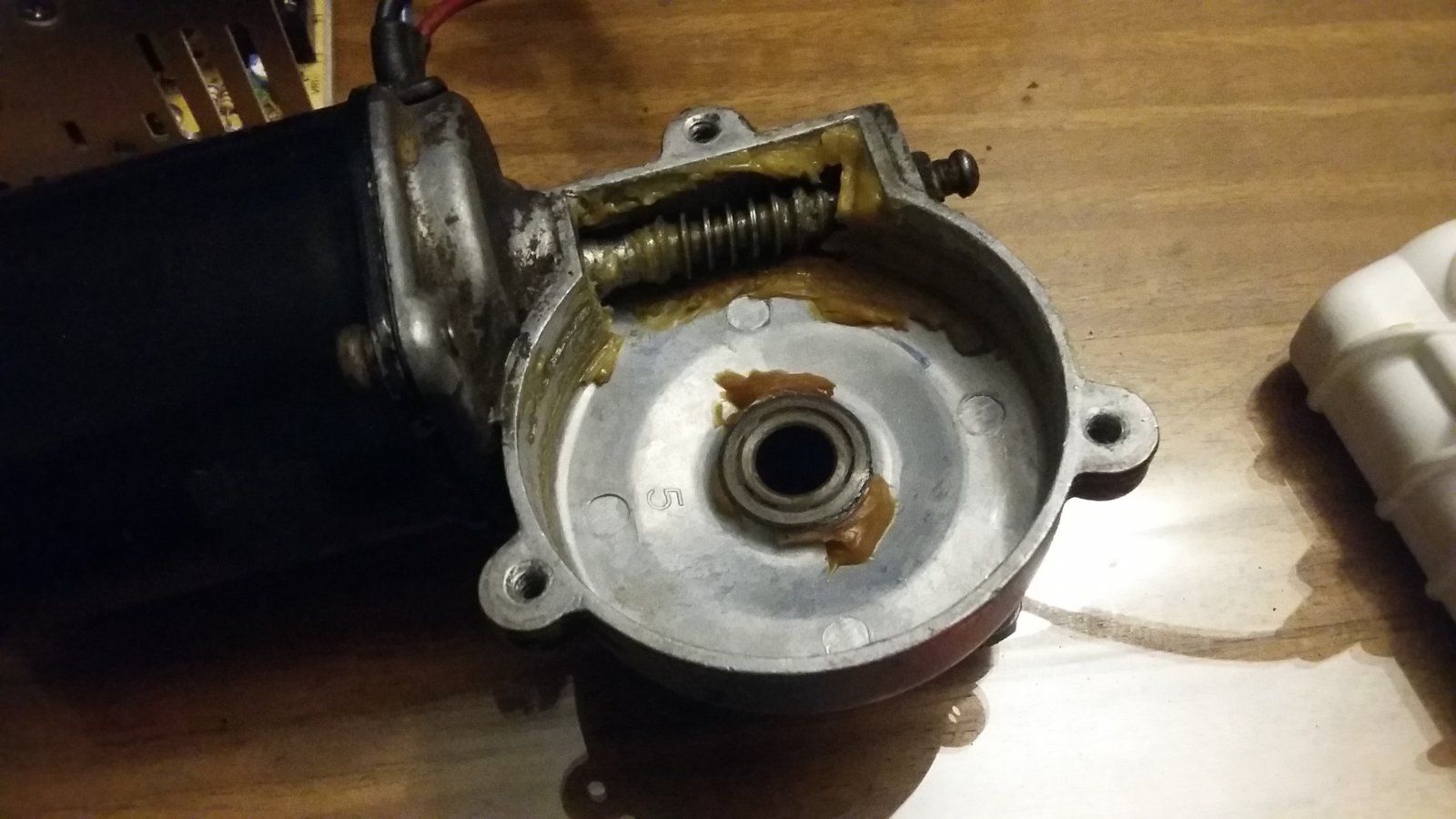

  14. MarcNSF
    MarcNSF Marc
    May 24, 2017
    66
    Lebanon
    - 97Coins
    +42 / 0 / -0
    Hi

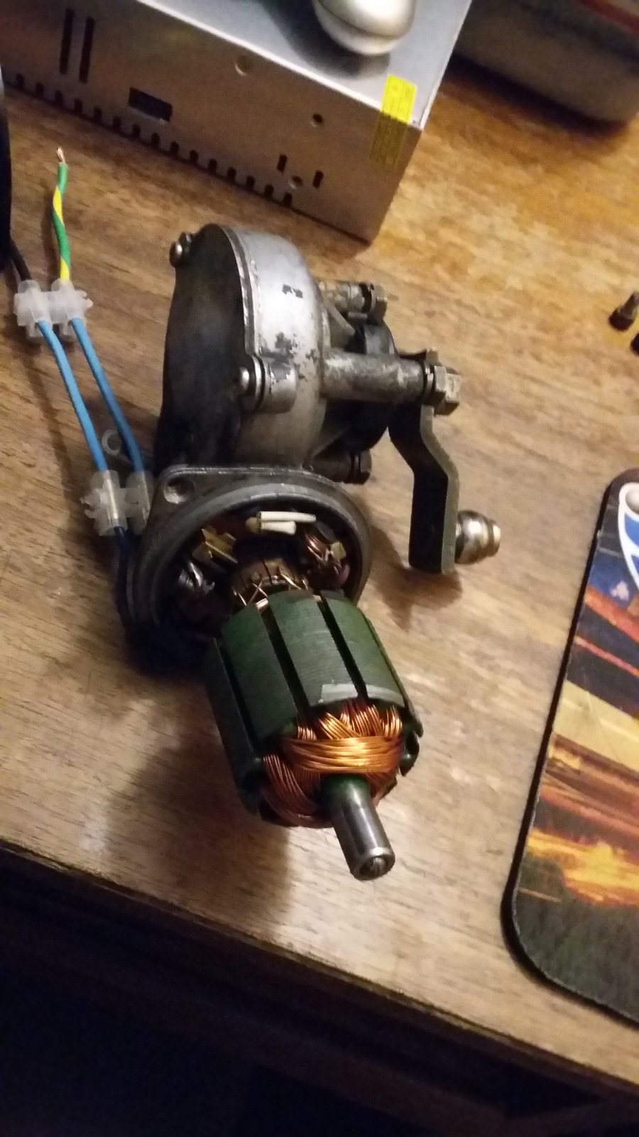

    Ok . First remove the gearbox big gear .
    You will see the worm gear axle that is attached to the rotor we want to check if the bearings are OK and there's no friction between them and the rotor
    By hand check if there's any .
    Now under power check it out in both polarity (left and right) and watch the worm gear axle if there is any forward and backward movement (some wiper motors have a screw on top of the worm gear axle and can be adjusted)
    Because from what you are saying the problem is: the rotor is touching the body when you power it in a direction
    Marc

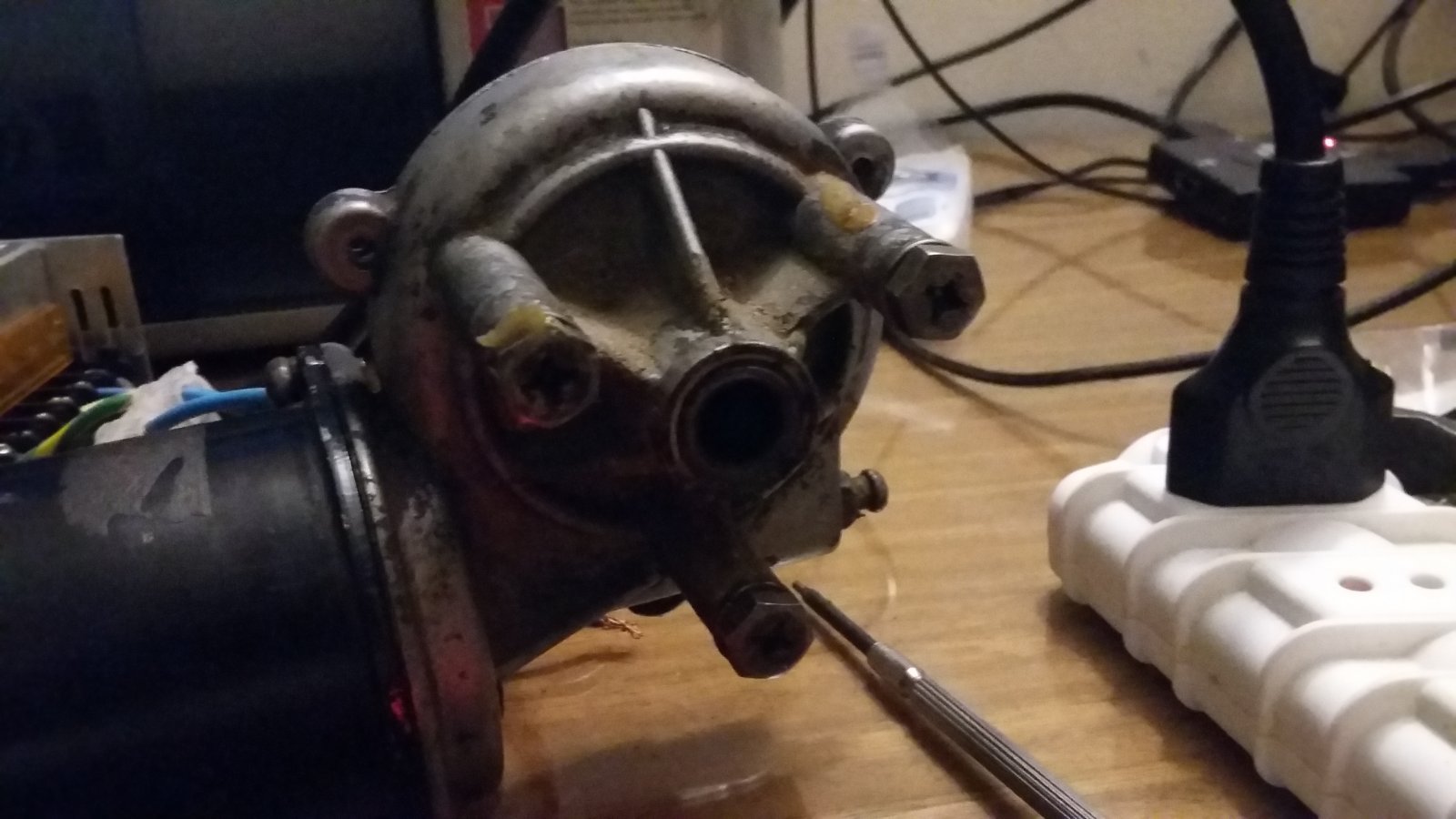

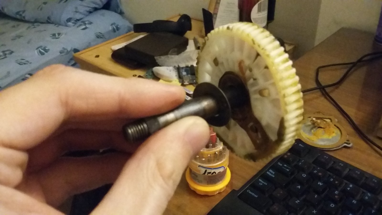

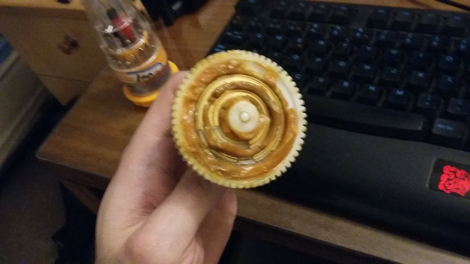

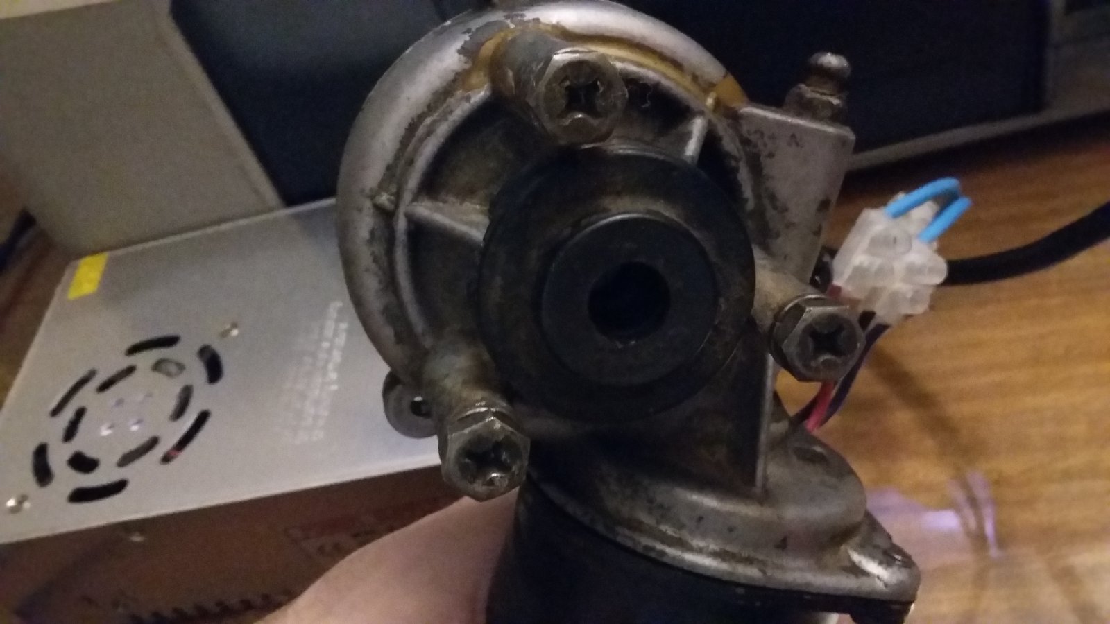

  15. Pedro Pablo
    Dec 7, 2015
    119
    Software Developer
    Valparaiso, Chile
    599Coins
    +47 / 0 / -0

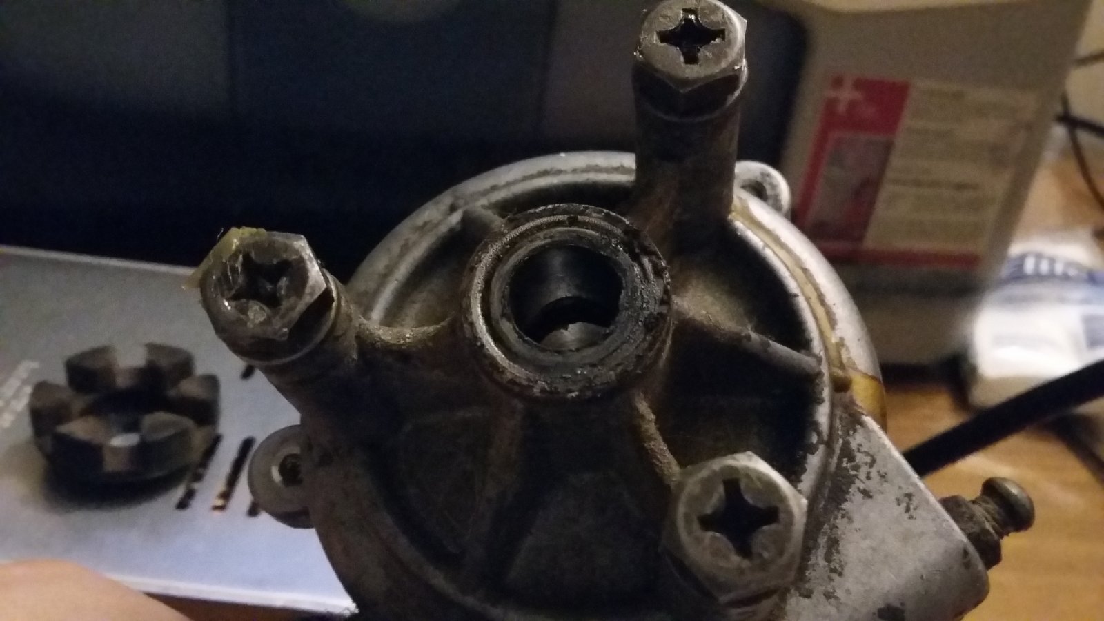

    Ok, before going to bed, i've took some pictures without the gear. I didn't see any bearings, but there's a space where the shaft and the gears goes to. There's a lot of black grease, and i didn't see anything that could provoke the friction. On the worm gear axle there's a screw but it's too tight, i move it a bit counter clockwise without any effect. When the motor is connected on the right polarity I put a bit a pressure on the gear with my thumb and I can hear a friction, so i can say that the problem is there, but i still wondering what could be
    EDIT: i forgot to mention, that washer from the gear is not 100% plain
    For now im not going to giving up but maybe soon I will consider to buy another motor, so i'll do my best and i hope to get all the help as possible
