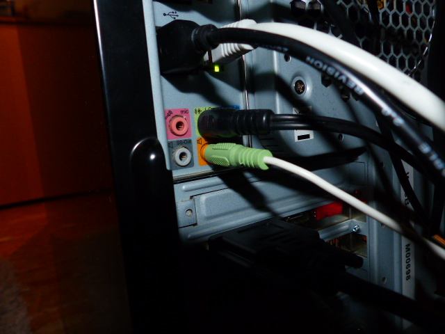

    I'm looking to connect bodyshaker to my computer ,
    I have :
    A computer with motherboard Asus P6x58 with soundcard included : 4 jack out ( front , rear , central , micro) and 1 line in.
    So i use classic computer speaker connected on the green jack on the motherboard.
    I put the jack 3.5mm of my ampli Tpa3116 to my motheboard in the central/subwoofer out ( black jack )
    I go to sound setup in Windows , i select normal speaker properties and modify Stéréo to 5.1 channel and confirm.
    When i use the tool to test each speaker it work great ( 2 recycle car speakers on subwoofer out and 2 normal speaker on normal speaker out "green jack ")

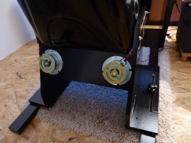

    It is correct assembly? My ampli Tpa is 2*100w . each bodyshaker have his personnal channel .
    on the bodyshaker i can see 100watts 4 Ohms
    +1 to positive 1st bodyshaker
    -1 to negative 1st bodyshaker
    +2 to positive 2nd bodyshaker
    -2 to negative 2nd bodyshaker
    Or need to be in serial?
    When i put the volume on maximum it work no correcly he (griiiiiiingg , griiiinnng , grrrriiiiiinnnnggg ) i think its not possible to play the vibration harder....

    ok i found one of my problem myself...
    The body shakers work with 4ohms if you connect each bodyshaker to each channel you turn in 2 ohms!
    But if you connect + channel 1 ampli to + body shakers 1
    - body shakers 1 to + bodyshakers 2
    - bodyshakers2 to - channel 2 ampli
    so it a serial assembly ... now i turn in 4 ohms with this asssembly and i have not parasite , bizarre noise .
    Body shakers work better with Project Cars 2.
    In Drive Vibe folder i found DriveVibe.ini.
    there is some numbers in this file if you modify the value. For example 0.8 to 0.9 or 400 you affect the sensibility in game .

    Why a crossover ?
    I have a central out on my soundcard . i use central just for bodyshakers because i think this output is already low pass filter....
