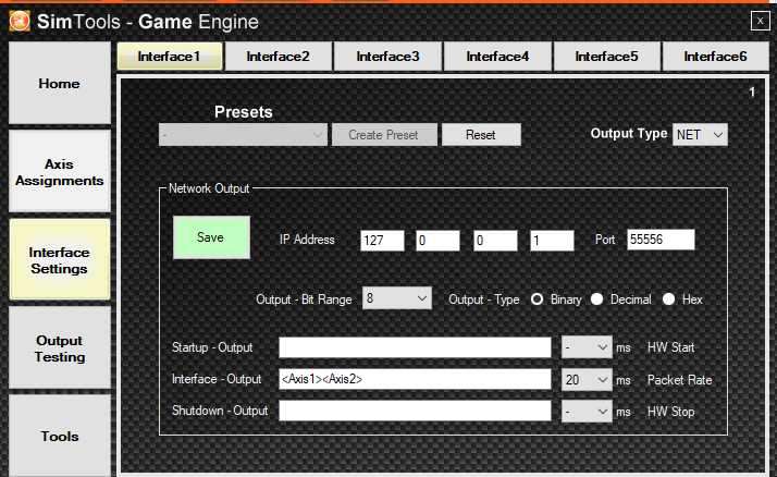

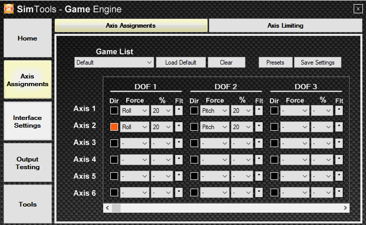

    I try to connect my Blue Tiger 2DOF motion rig with Simtools 2.
    The motion RIG move with the following setup with output testing but the Blue Tiiger stay at the lower left'corner" and could not be moved with the slider "Amount Axis to use"
    with the roll and pitch bars in a center position.
    Did some expert could help me here.
    Thank,s in advance !!
    Regards
    Dello
    21,581
    151,100Coins
    For SimTools 2 the Interface Output is liker this - <Axis1a><Axis2a>
