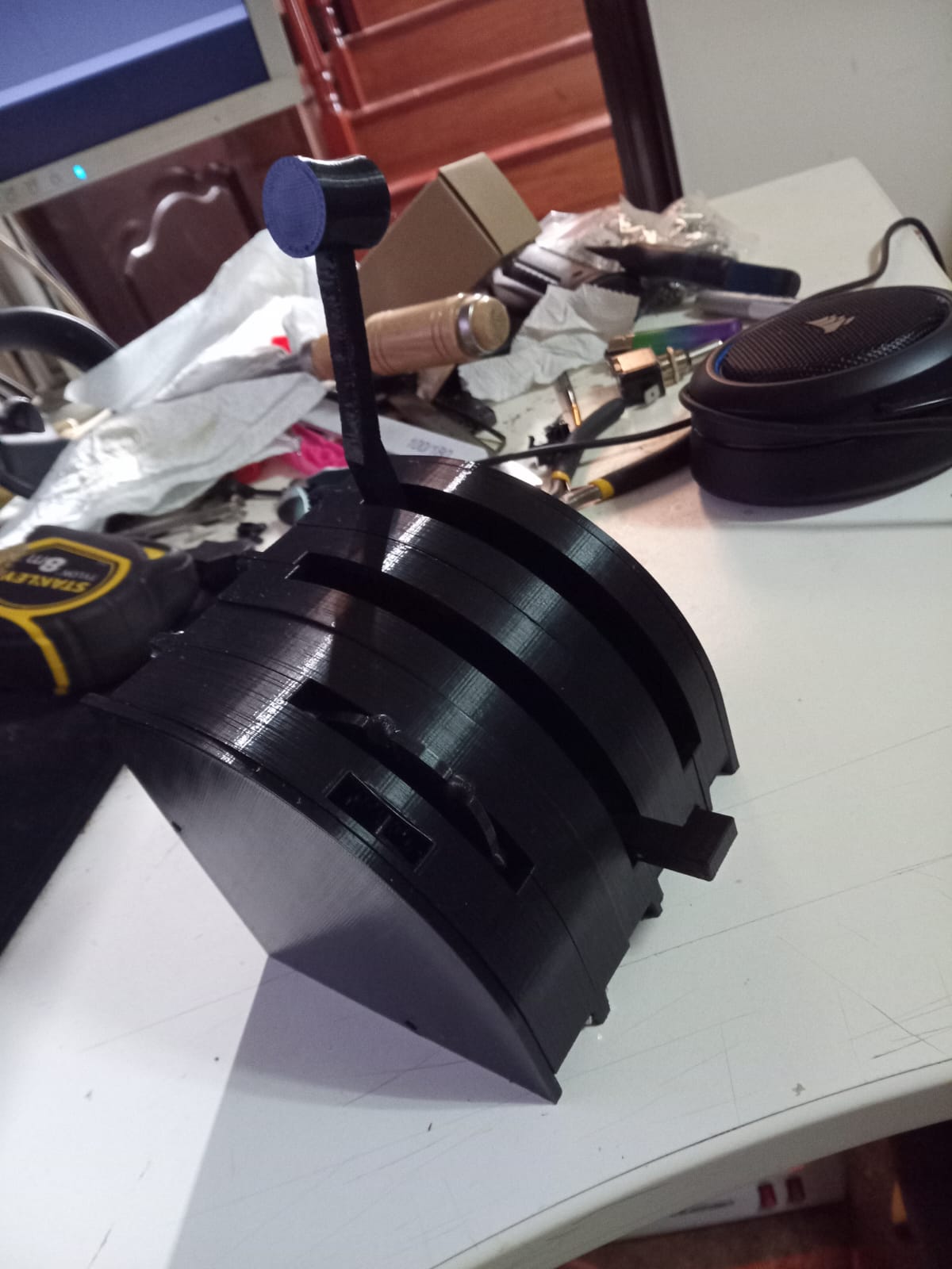

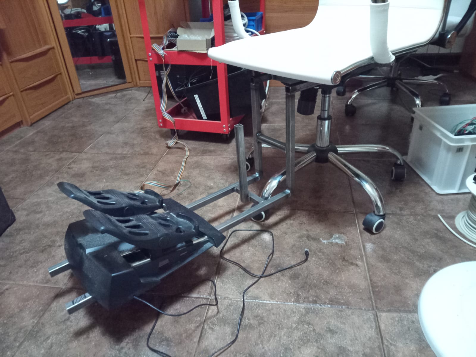

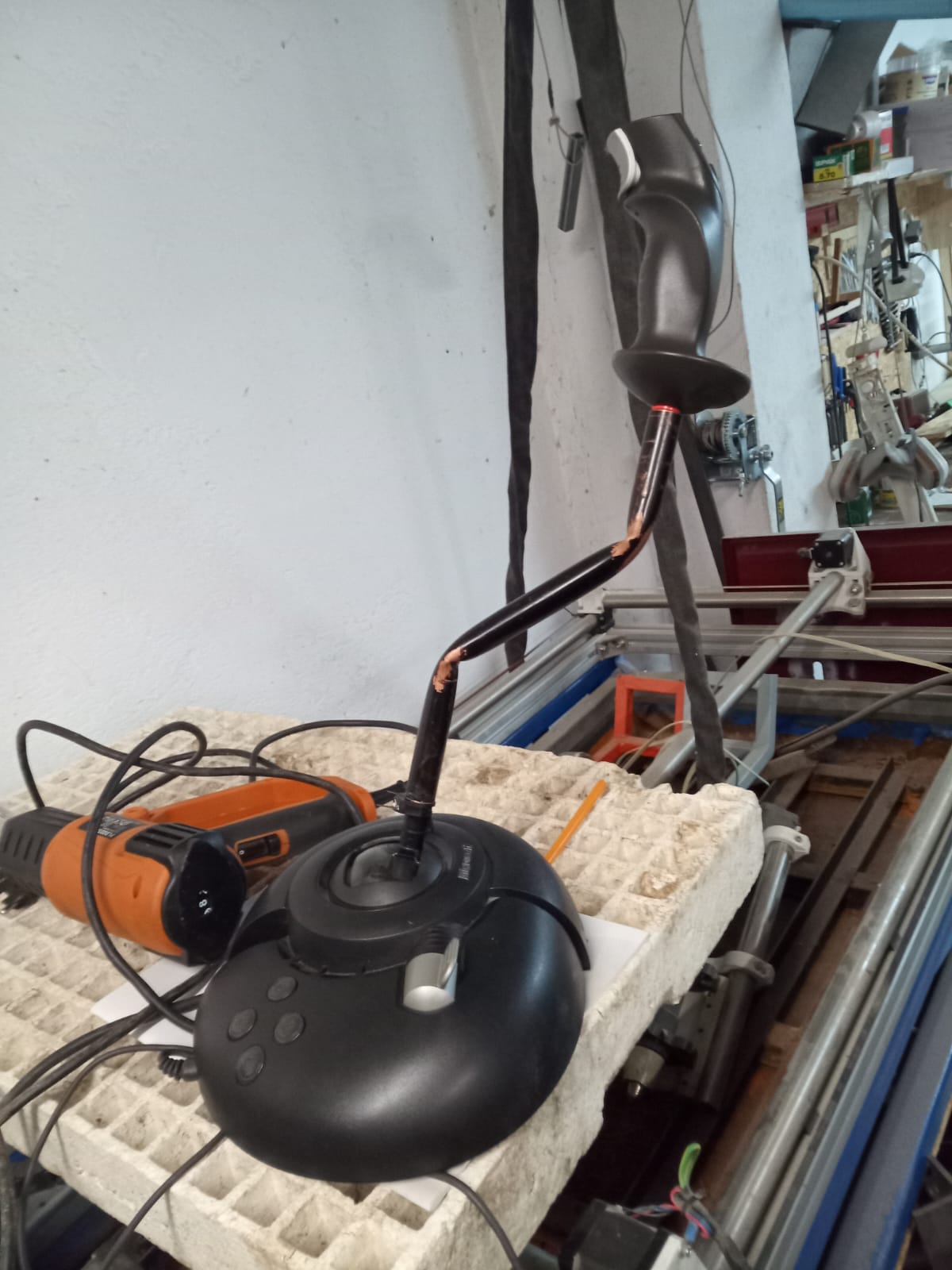

  5. Yeti86
    Yeti86 New Member
    Nov 24, 2023
    21
    132Coins
    yeah, i come to the same conclusion yesterday
    i went for the cheaper option, and am working on the ergonomics and interface until the motors arrive.
    WhatsApp Image 2023-11-26 at 11.49.56_00fc7760.jpg WhatsApp Image 2023-11-26 at 11.49.57_0f39b1bc.jpg WhatsApp Image 2023-11-26 at 11.49.57_f8dc01ea.jpg
    as of yet all crude, but it will eventually come together somehow :grin
    thank you for the Nm spec, that gives me a number to fiddle around and get closer into ballpark.
    i as of yet am not sure if i should make a hinge or rotate the chair itself on a suspended bearing. the later would be less demanding, save me another wheelchair motor and i cold instead use a wiper motor for it. the hinge version also needs additional rollers. but that could be interesting for racing sims, but also would result in a bigger footprint.
    process goes on....
