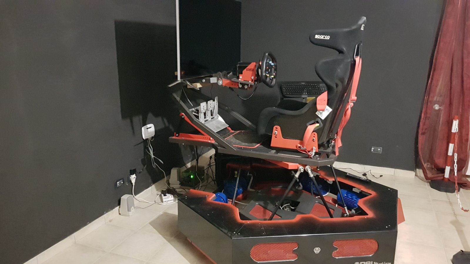

    AC motor, 6DOF
    Hello everyone, in reality it is not a project in progress since when I realized the AMC1280USB was not fully exploited with simtools.
    Now that finally with the new Hexpod plugin you can take advantage of all the functions I decided to update the form and the location so I would like to share from here on.

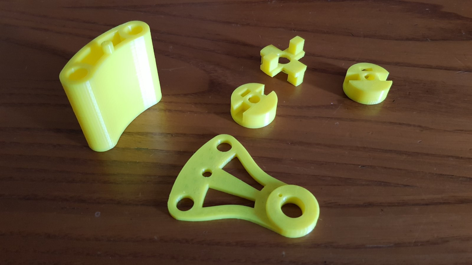

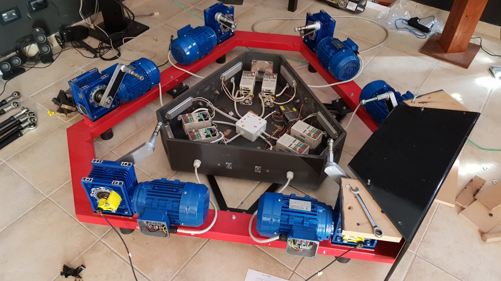

    The changes are not noticed very much but have greatly improved the amplitude of the movements and the management of the simulaotre:

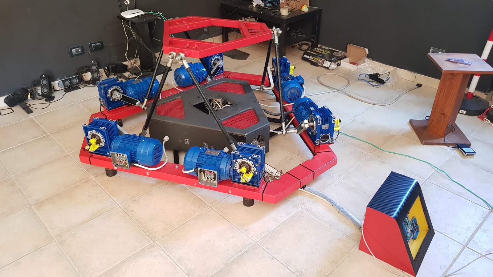

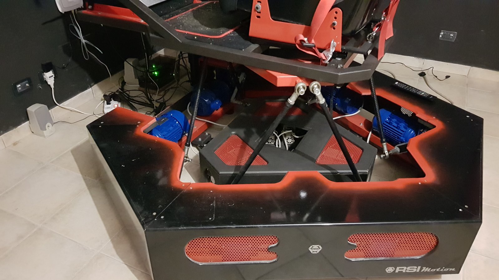

    1) AMC was housed inside the box, a useful solution for space but uncomfortable and dangerous when working on the setting so I decided to remove it to manage it in complete safety.
    2) the support of the electronics has been reduced by about 8cm since in the most extreme excursions the motor rods could reach the box damaging it.
    3) rotate the motors by 180 ° the center of the reducer has risen even more and the engines are now in the lower part so in the braking phase (using both surge and pitch) you do not risk that the post can hit on them.

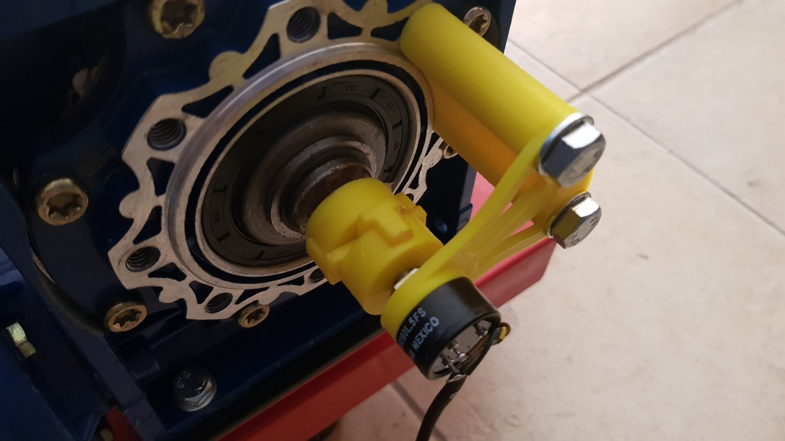

    4) made of supports for the adaptive potentiometers in order to avoid any radial stress on the shaft

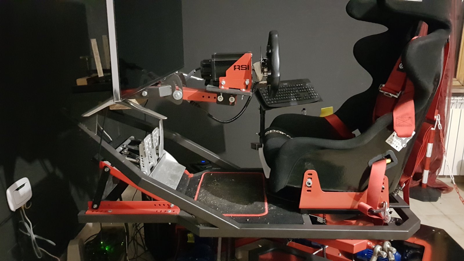

    Even the fairing (not present in these photos) has been modified in order to obtain greater possibility of movement.
    These were the improvements made after a couple of years of use.
    Regarding the software the AMC has been updated to the latest 3.5 firmware and replaced the original plugin with that of Hexpod, and finally installed simtools 2.3
    Tomorrow I will try to show you the fairing and the top station, even you new, then I will ask you also some advice on the inverters that are giving me problems after the update.
    If you have any kind of advice, just say;)

    4) realizzato dei supporti per i potenziomentri adattativi in modo da scongiurare qualsiasi sforzo radiale sull' alberino

  2. Gadget999
    1,897
    11,610Coins
    +458 / 9 / -0
    looking good ! - can you tell us about you motors and gearboxes ?
    hope to see a video soon
  3. billo2404
    billo2404 Member
    Jul 5, 2013
    119
    Roma, Italia
    1,236Coins
    +36 / 1 / -0
    AC motor, 6DOF
    the engines are 1380 rpm 0,75 Kw (1 Hp) and the gearbox 1:60
    i motori sono 1380 rpm 0,75 Kw (1 Hp) e il riduttore 1:60

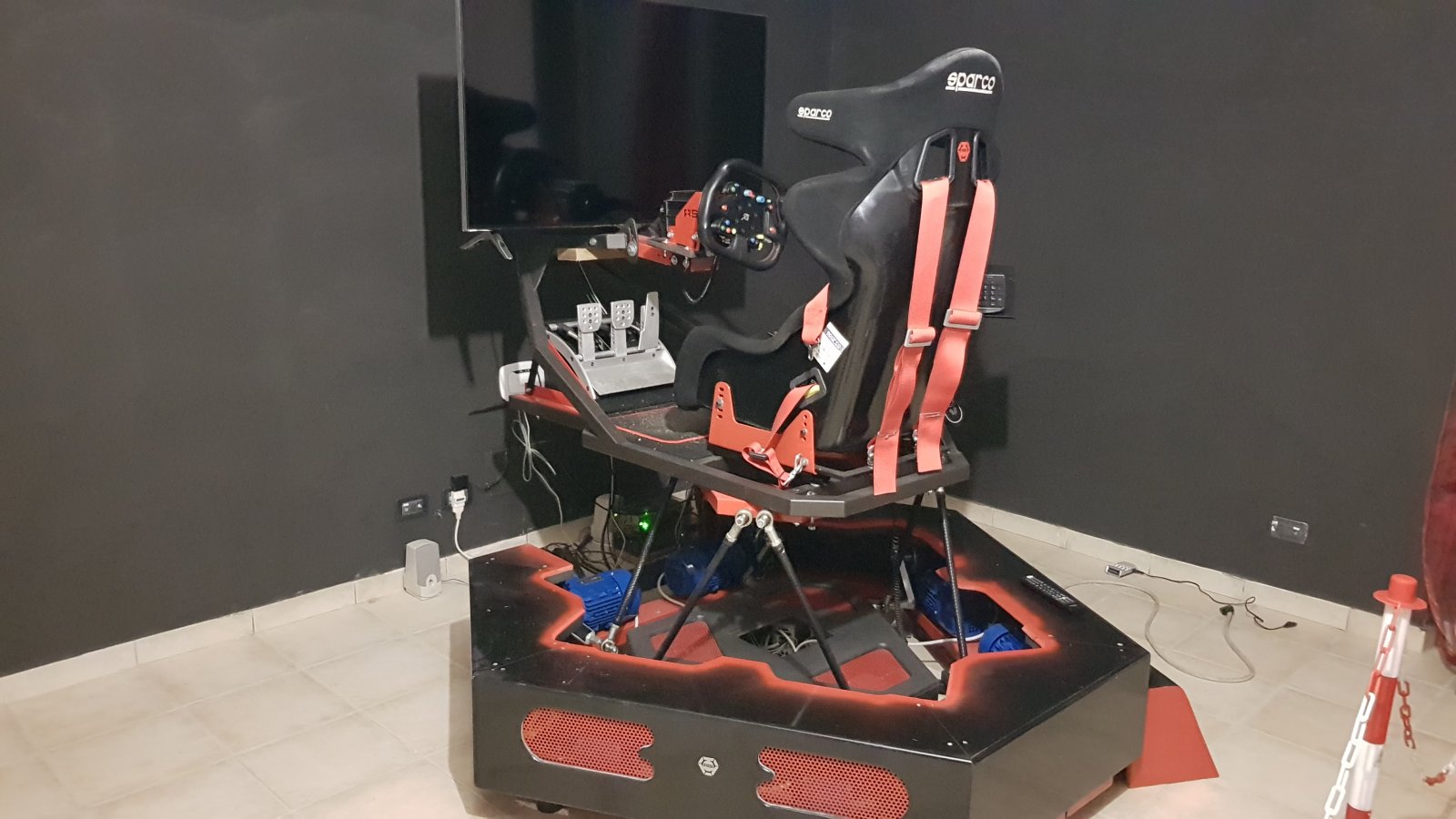

  4. billo2404
    billo2404 Member
    Jul 5, 2013
    119
    Roma, Italia
    1,236Coins
    +36 / 1 / -0
    AC motor, 6DOF
    as promised I update with the current state of the sim.
    However, the hardware and software changes have brought me a small power problem.
    I have to decide whether to replace the inverters or feed them with a three-phase transformer from 380V to 220 three-phase
    I'll keep you up-to-date ;)

    are you pulling more current than the 220v can supply ?

    No, my inverters are 220 three-phase and not 220 single-phase.
    I could use the 380V and get the 220 three-phase with a transformer, but, since I would like to start a new project, I would like to make it 100% usable with 220 single-phase to be able to sell more easily because few have the 380 home.
    Up to now it has always worked perfectly even with the single phase, but obviously the new setup loads more front engines and occasionally go into alarm.
    If I have to sell I want it to be 101% efficient
    Today I tried to feed the two phases with a bridged and neutral in the other entrance but the result has not changed.
    I have some other paper to try but then I will go on to evaluate the purchase of new single phase inverters to solve the problem permanently

    why do not you try to put a capacitor and convert your motors to single-phase

    the problem is incoming and not outgoing
