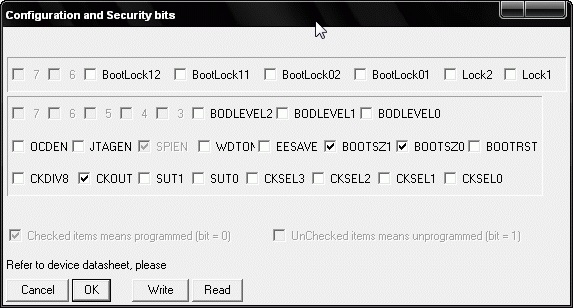

    Both Chips are working on my board, but they have different Firmware and fuses to set in Ponyprog ;) . And remenber to chose the right Chip ( for example Atmega644) in the upper right corner from the Ponyprog-Program ;).
    Fuses to set in Ponyprog for ATMEGA644
    Firmware ATMEGA644_PWM_AMC15_2DOF_V1_CRYSTAL22 MHz
    ATMEGA644_PWM_AMC15_2DOF_V1_CRYSTAL22.zip
    Firmware ATMEGA644_PWM_AMC15_2DOF_V1_CRYSTAL24 MHz
    ATMEGA644_PWM_AMC15_2DOF_V1_CRYSTAL24.zip
