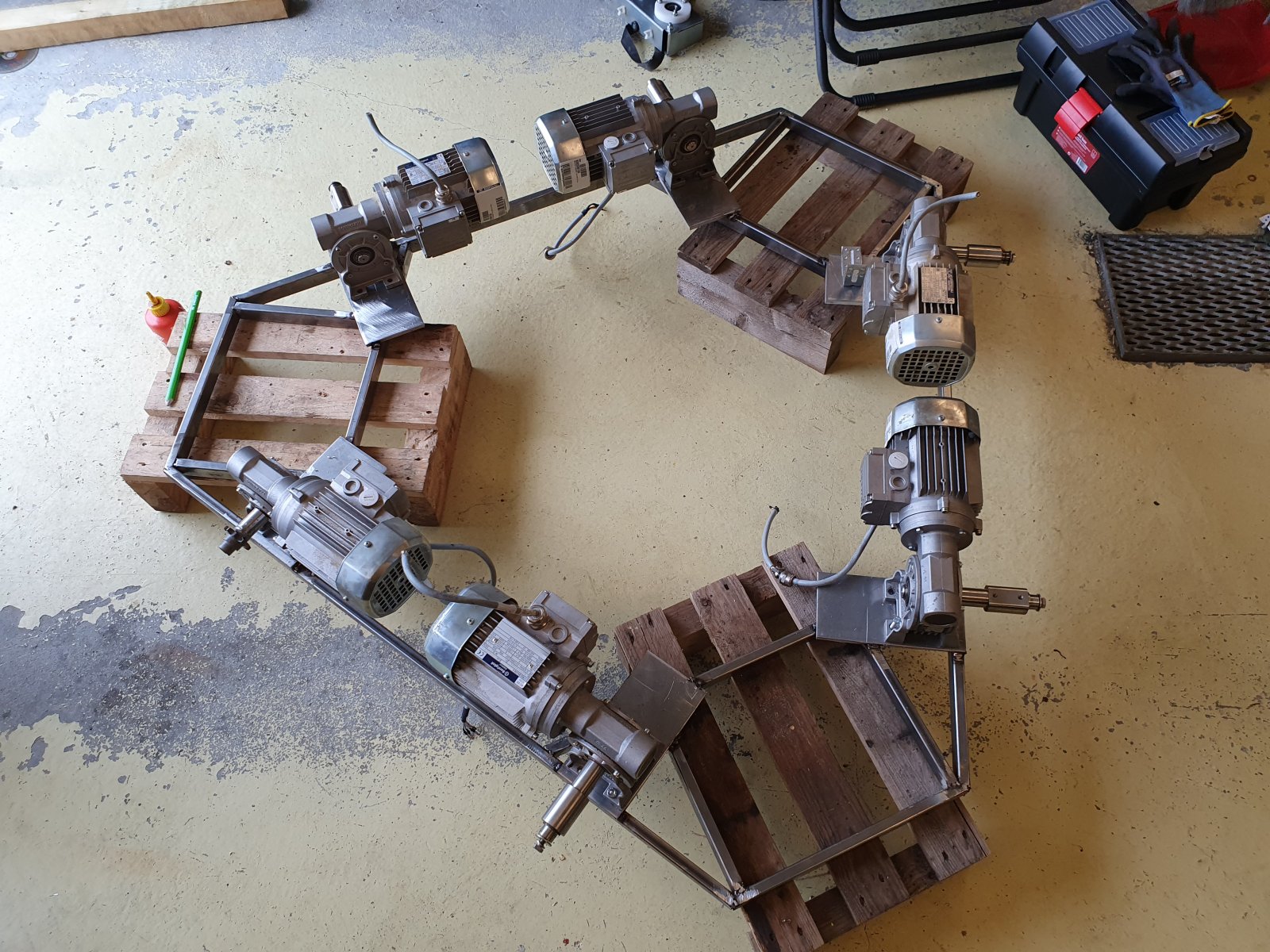

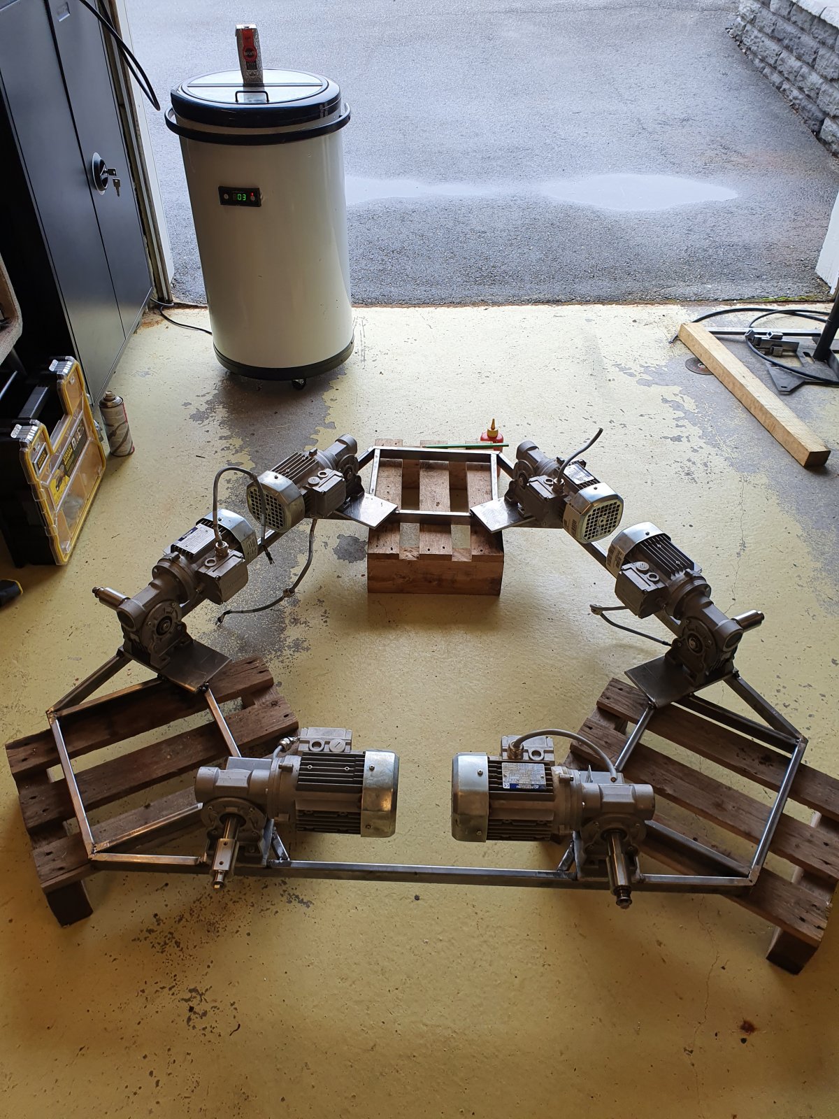

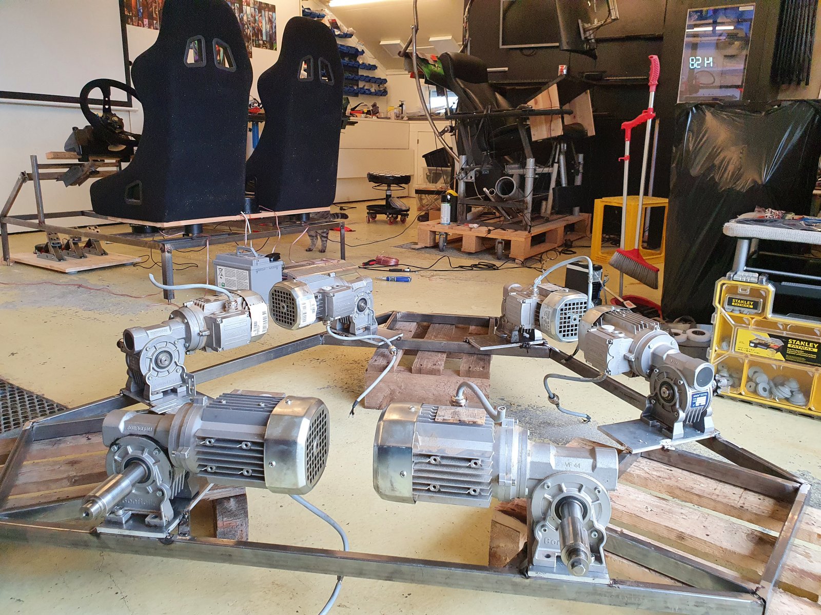

  14. Blekkulf
    Blekkulf Member
    May 18, 2018
    69
    Molde
    354Coins
    +13 / 0 / -0
    2DOF, AC motor, Arduino, Joyrider, 6DOF
    Here are some pics of the base :) no comments on the welding please :grin I used electrode, will finish with mig when i know its correct :)

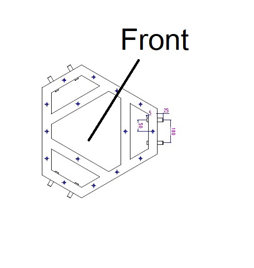

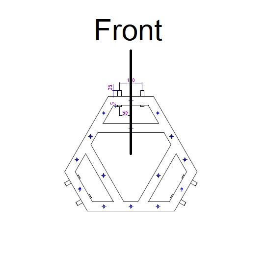

    Thanks for the reply! Is the rotation on 6dof adjustable? The 6 motors connects on three spots on the top frame. Can I have the "center" behind the chair and the two at the sides in the front direction? All the tutorials ive seen is the center in front.

  19. Blekkulf
    Blekkulf Member
    May 18, 2018
    69
    Molde
    354Coins
    +13 / 0 / -0
    In the tutorials i can find on this forum its like pic 1, but for my setup it will be better with pic 2. The "center" connection point behind the Chair, not in front :)
  20. Gadget999
    1,886
    11,543Coins
    +453 / 9 / -0
    I use the 2nd platform design
    The drivers legs typically sit out in front and down.
    This design makes it easier to fit a seat
    For a driving sim typically the rear moves side to side and the platform moves back and forth under acceleration and braking, this design seems to make better use of the actuators. Im my experience the rear actuators do less work and could be a lower spec
