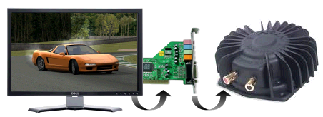

    I would like to know if you need an Amp to connect the bass shaker to the PC's second soundcard or you can simply plug it like the illustration in the profiler:
    Thx!
    Bleco

    I think if the unit has a power jack of its own then it will not need an amp.
