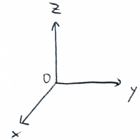

    I’ll try to explain how you can influence the rotational and translational movement of the upper platform.:nerd
    Let's start with the beginning. Since we live in a 3 dimensional world, we can describe every point with 3 axes. And i think it's also important to have the same basics, in order to minimize misunderstandings.
    the easiest to use is the cartesian coordinate system
    There are 3 axes. x, y and z.
    If we want to describe the Point P we need the values for x, y and z.

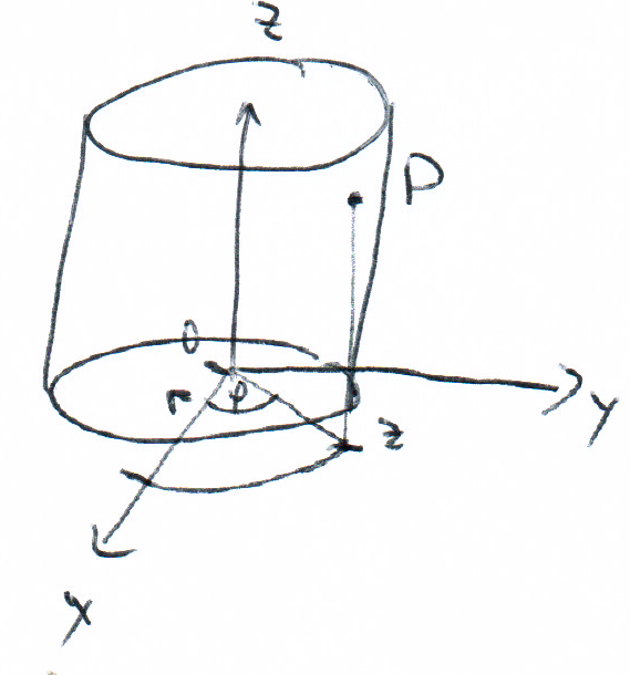

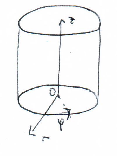

    Let's change to the cylindrical system.
    Here again we have 3DoF. The axis z stays the same, but than we have the radius r and the angle phi.
    The same point P can be described in a cylindrical coordinate system:
    z gives the height of the point P. r the distance from the z-axis and phi is the angle between point p and a reference layer.

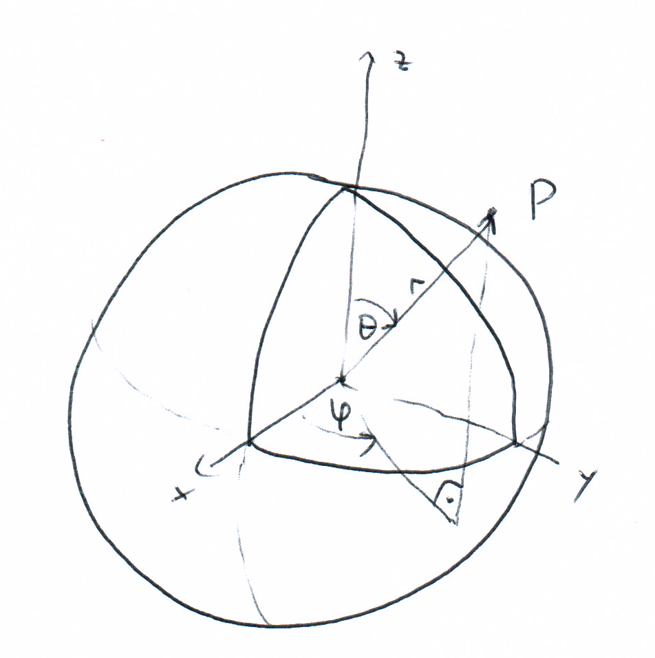

    If we want to discuss the actuators, the spherical system match better:
    We have the radius r, which is the distance to the base. than the same angle phi, which rotates around the z-axis and an additional angle theta, which gives us the angle between the axis z and the line to the point P.

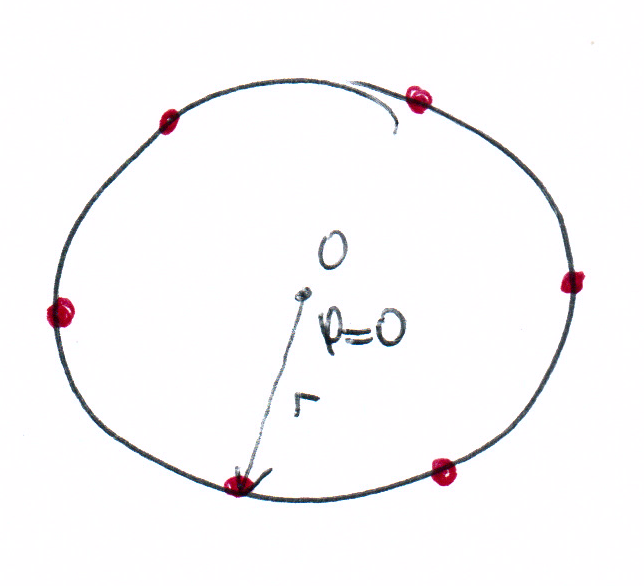

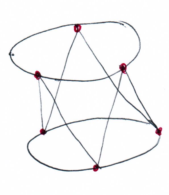

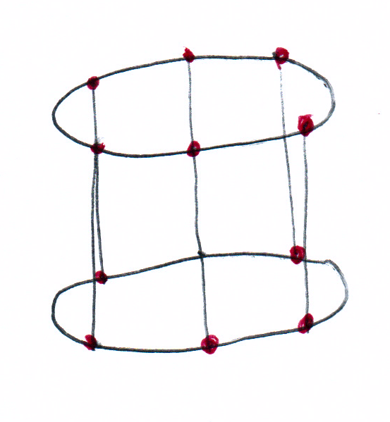

    Lets start with 2 platforms with identical radii. The fixing points of the actuators can now only be moved with the angle phi on the bottom and the top platform. We choose the an angle of 0°:
    r=r1=r2
    red dots are the fixing points of the actuators.
    Sideview:
    With this arrangement we'll have:
    - actuators parallel to the z-axis
    - the most heave possible
    - a good pitch&roll
    - no sway, surge and yaw
    So this would be only a 3DoF rig although you use 6 actuators. And if you don’t fix it in y- and x- direction you’ll soon have a 0DoF rig, due to the fact that i will collapse.
    If you raise the angle phi or use different radii (r1≠r2) you will decrease the possible heave!!

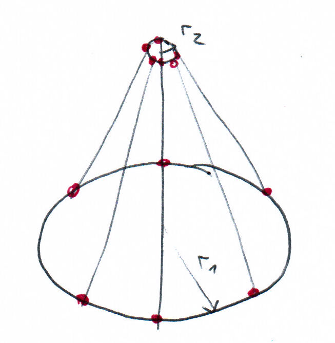

    One other way to increase the possible roll and pitch is to decrease the radius r2, while using the same radius r1.
    But this will work only unto a certain angle theta. than the roll and pitch will decrease again, we'll come to that later.
    Increasing the radius r2(>r1) and the angle phi will result in a lower roll/pitch movement.

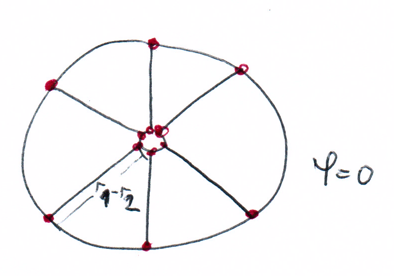

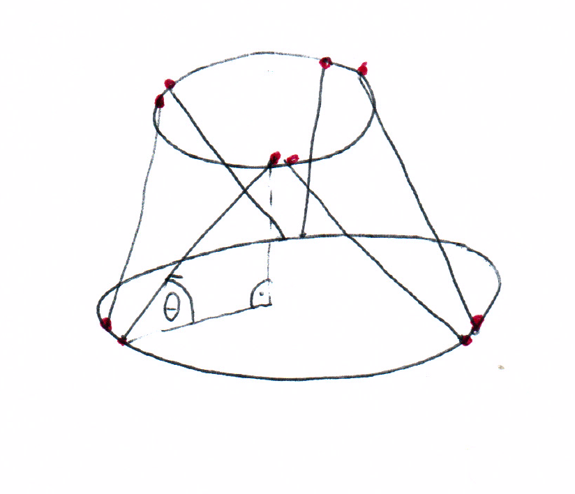

    How to maximize sway and surge? If you look from the top to the rig it's the easiest way to imagine. You'll have the maximal surge and sway if your upper platform lies IN the bottom platform in the x-y-plane
    view from the side:
    The radii have to be chosen depending to the length of the actuators. You won't be able to heave and roll and pitch your platform, since you work in two dimensions. This is, because the angle theta is 90°, and cos 90°=0, so now pitch and no heave. I know, if all actuators will move out, it will heave, but maybe downwards. If you now raise the radius r of the upper platform, your upper platform will be higher and you'll reduce the possible sway and surge. Sway and surge is independent from the angle phi, if symmetrically arranged. You can rotate them around there fixing points on the base and so change r2.
    Simply said:
    The higher the angle theta is, the more sway and surge you'll have, but it'll reduce the heave. At first increase roll pitch and than decrease it again.

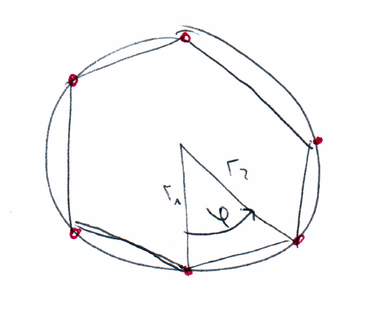

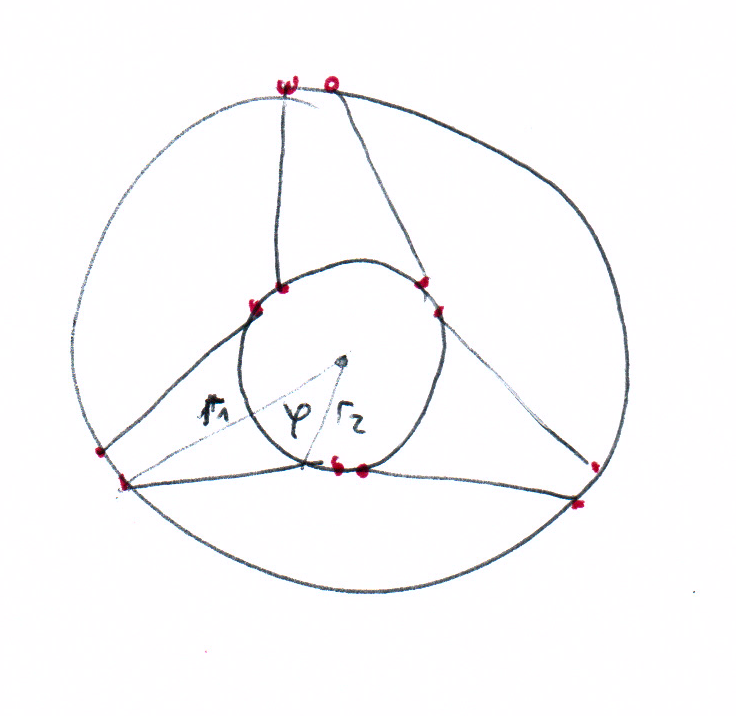

    Let's introduce the 6th DoF, yaw. Since we didn't use the angle phi yet, this is the one we need to rotate our platform.
    Example with same radii.
    View from the top:
    The higher the angle phi, the higher the rotation yaw of the upper platform, easily said.
    Here an example with different radii r1 and r2 and the angle phi.
    just to illustrate it. but be aware, the angle theta is 'wrong' in this pic;) i mean i explained it different. it should be between the actuator and the axis z, not the base. but of course you can use it this way...
    i still may be wrong somewhere;) so no guarantee:cool:

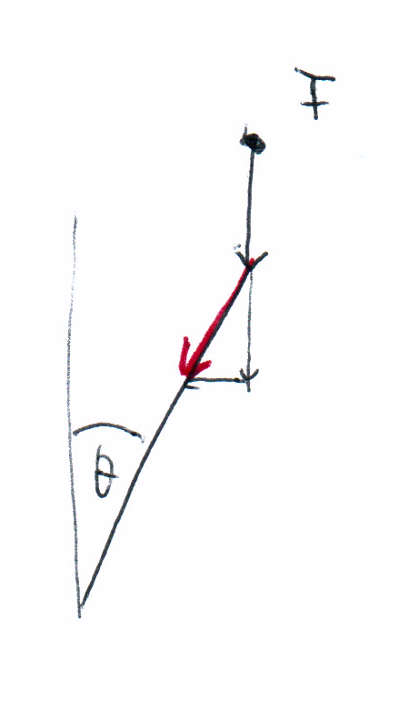

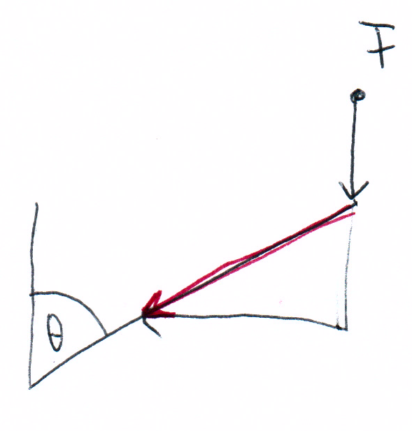

    maybe one more point, since this can also become important. Raising the angle theta results in a higher power consumption.
    The resulting force F_res=F/cos theta. (If you take 'the other' angle theta--> F_res=F/sin theta)
    With a steep actuator the resulting force will be around the the same as the force from the top (weight, acceleration, deceleration)
    If you have a bigger angle theta
    you'll have more work for the motors to do.
    An angle of 60° results in the double load.

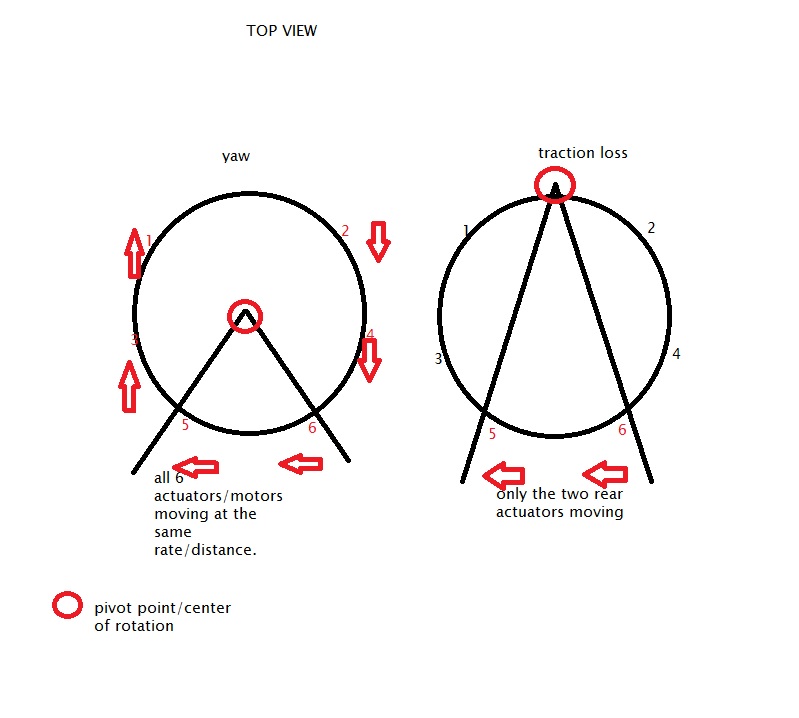

    yaw should pivot from the center and traction loss should pivot from the front. although yaw can be set up to mimic tl by reducing the movement at the front of the rig thus forcing the pivot (center of rotation) forward. this also creates a larger radius of movement.
    edit:

    @bruce stephen
    Thanks for pointing this out. As long as i haven't my own rig, this will all stay a little theoretical^^ Deleted the point, don't want to confuse somebody;)
