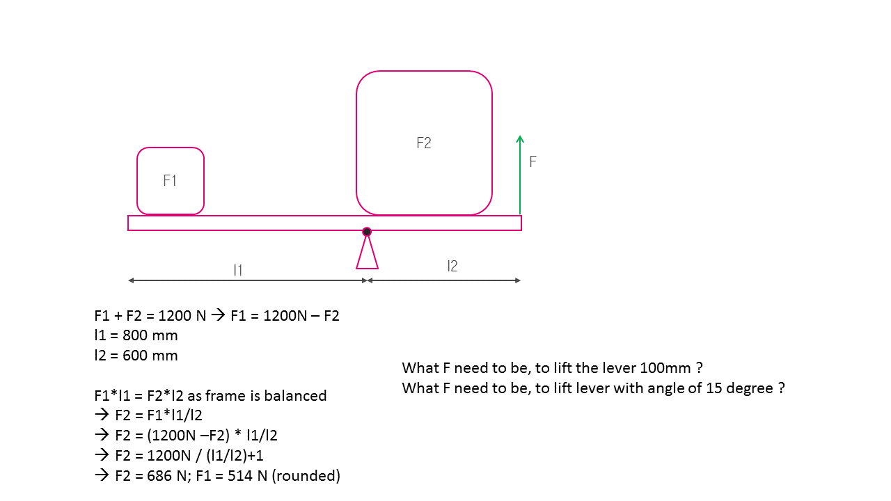

    can someone help me with basic physics of mechanics ?
    Pls see the attached sketch.
    Can you answer the question to calculate F ?
    Even after reading the SimCalc mathematics, this is not fully clear to me.
    So every help is appreciated :)

    And another question to mechanics:
    If I would like to (simplified) calculate how many torque my motors should have, can i go this way:
    M = F * s
    F = 1200N (see example above)
    s = 5 cm = 0,005m (length of CTC modul) which leads to ~ 10 cm / 100 mm linear movement because of +/- 90 degree (if the rod is directly fitted below rod mount)
    --> 1200N * 0.05 m = 60 Nm (divided by 2, as I would liek to use 2 motors)
    --> each motor needs to be capable of 30 Nm
    Is this correct ?
    And are the 30Nm for each motor the starting (peak ?) torque or the "normal" torque when running ?
    Thanks for help !
