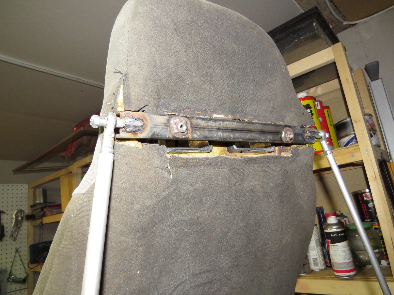

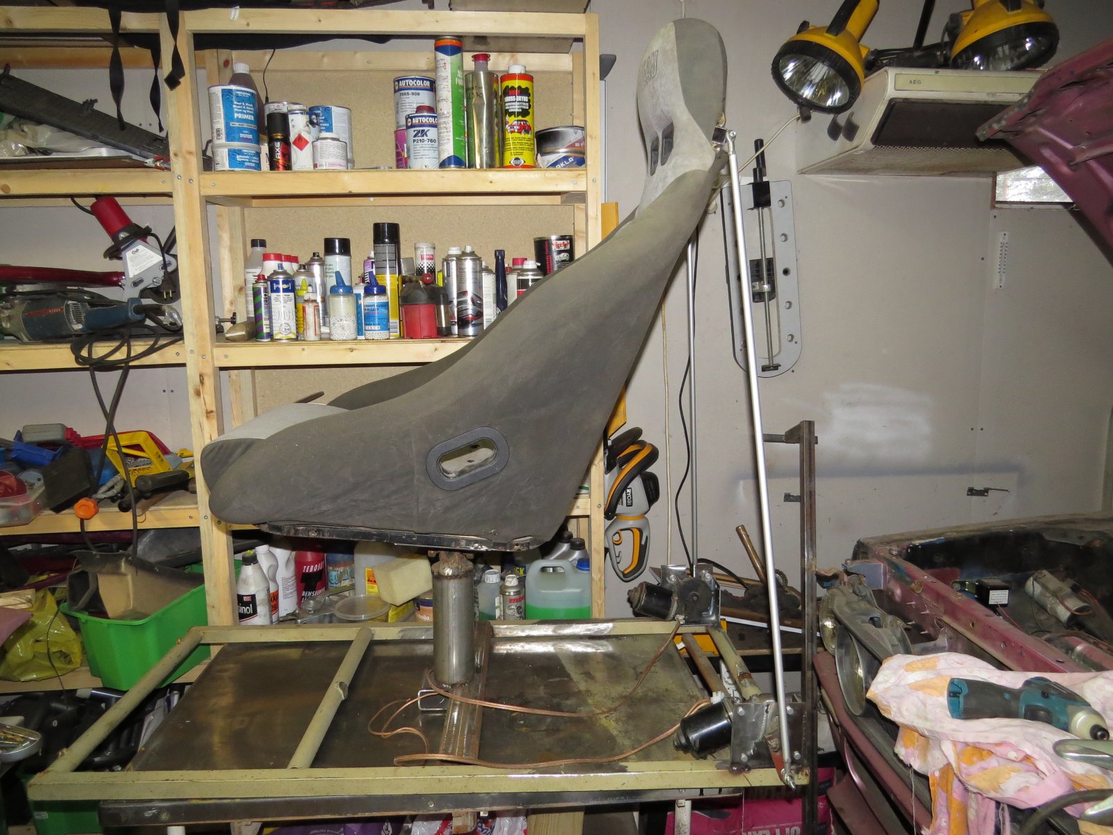

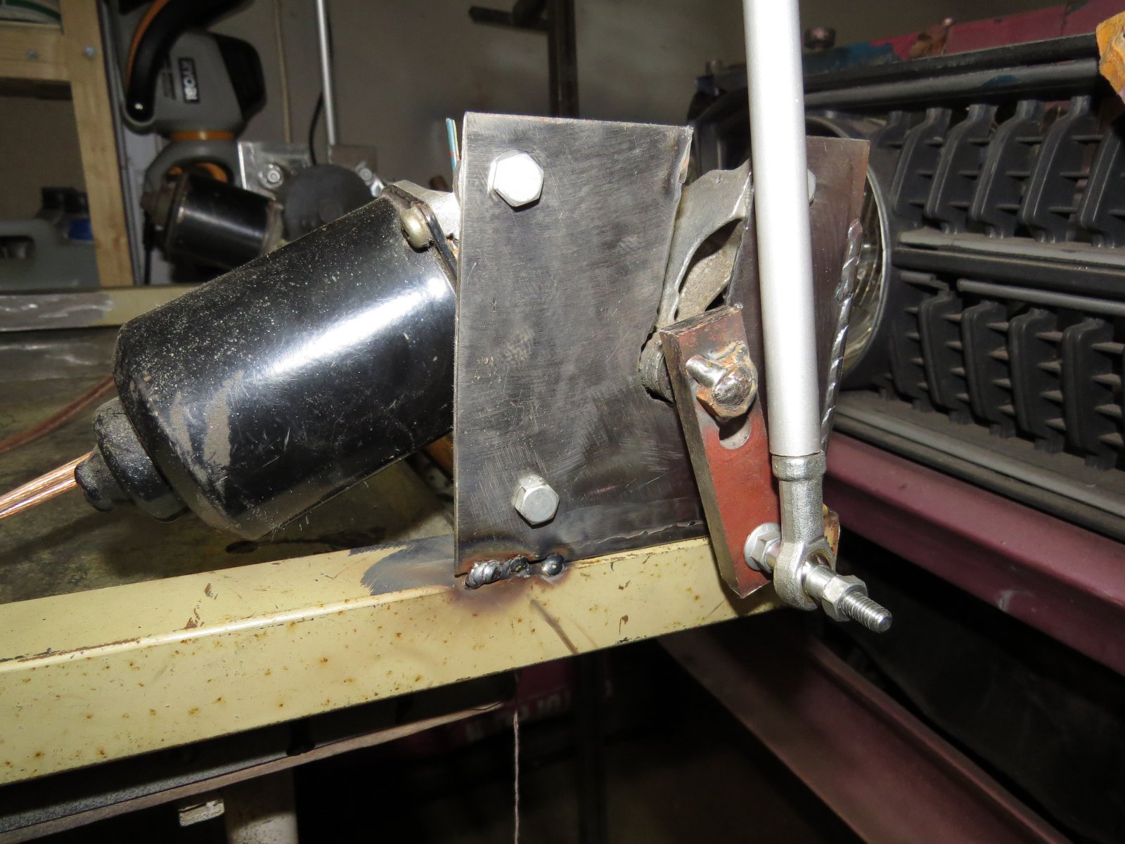

    Here is some pictures whats it gonna look when you use old project pieces and join them together. It's not pretty but if it works, it's easier to do another with new parts.
    Useing m6 bolts and joints
    After another idea i weldet piece of iron in the chair but now i got good place where to put joints.
    The seat is going top of this
    I think it's strong enough for little heavier users too.
    Seat is going those rails and after i found the center i welded or just use screws to put it in place.

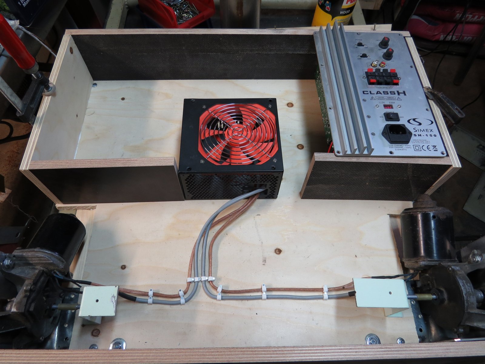

    I put the shafts on the outside because i'm thinking to put everything (motors, pots, electric.. inside some kind of case. Then everything is safe..

    If you put all inside a box, be careful with heat... Maybe a fan will be a good solution.

    Yes. I was thinking to do some kind of tunnel inside the box to take air in the front and blowing out near the motors.

    good job so far @mrbeginner :)
    yes Mega is fine as well like @Wanegain told you (he is a boss!)
    you should reinforce this part (not enough vertical inertia) with L bar or T bar
    if not it will bent under the weight

    Plate is 2mm thick and i have one L-bar upper side but maybe it's better to do proper in first version. Thanks for sharing your knowledge :)

    2mm thick is really too small but if you have L bar above, it should be fine :thumbs

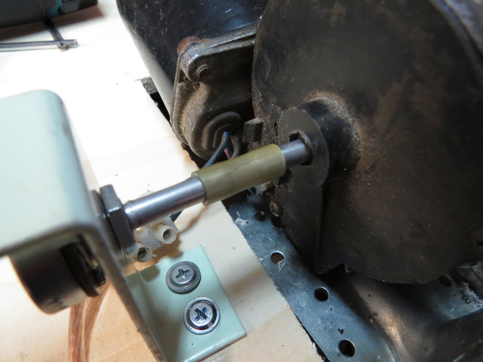

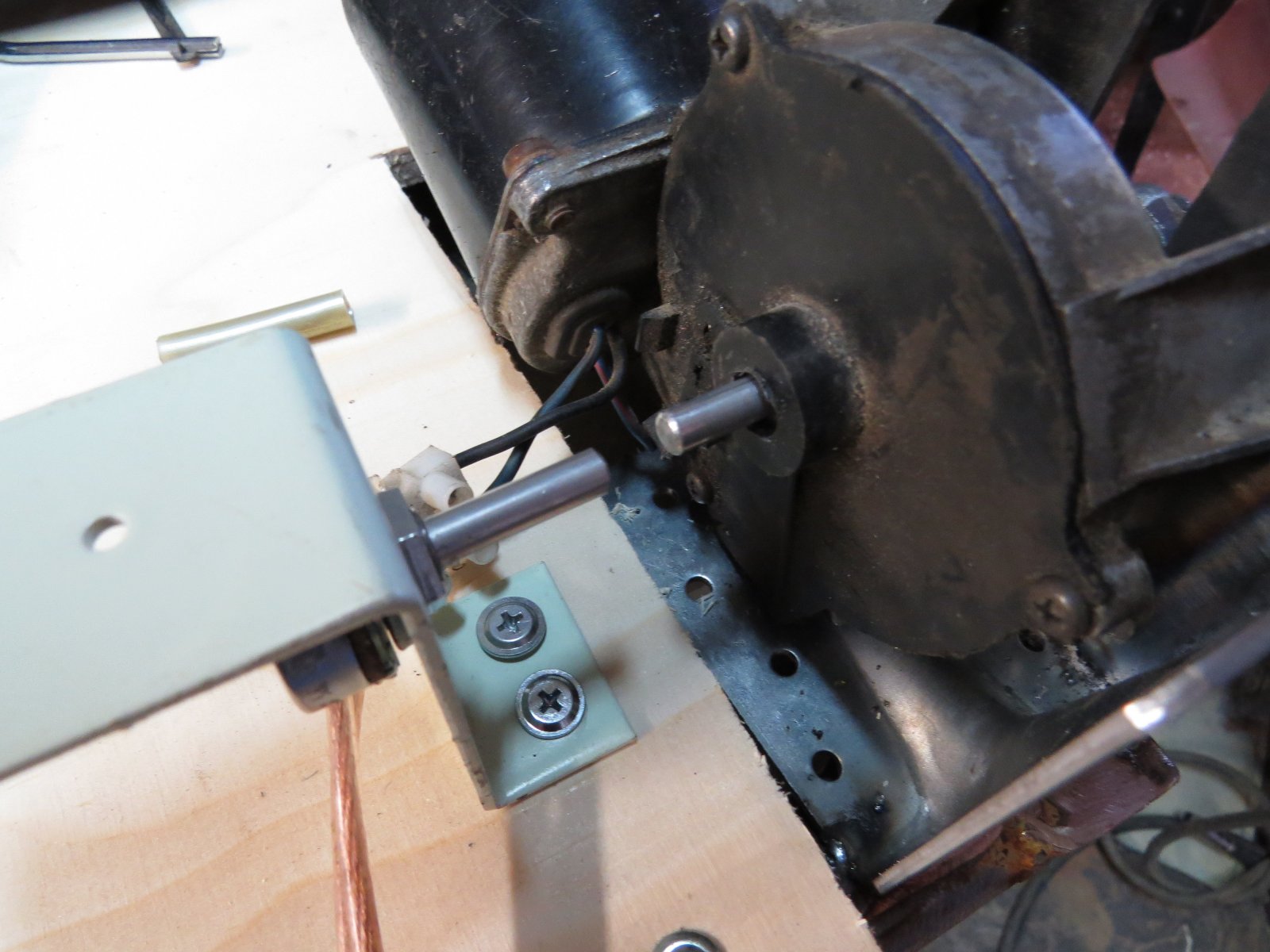

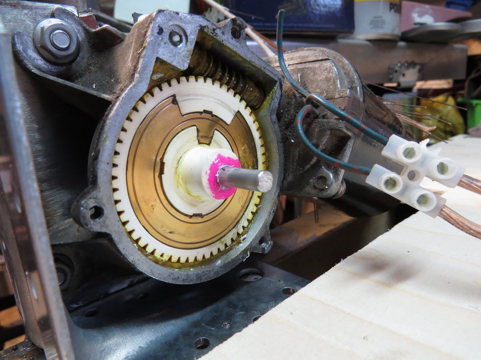

    Now i put potentiometers in place. I use hydraulic tube to make little clutch if something goes wrong. I drilled 5,5mm hole in plastic gear and glued 6mm shaft on a place. After that i put pot in angle and allign shafts. Heres some photos to look at 6mm aluminium shaft.JPG Aligning.JPG All together.JPG

    Little update what i made today. I'm gonna put arduino and motomonster inside the old power supply so they not get electric iterference. Right i have simex bass amp what i use for my Sinus live basspump. I still waiting my powersupply to put in the box too. The air for cooling i'm thinking to take under the box so the whole thing be quiet.

    Checked many pictures and after that i was sure the wires must be right. Plug it in and after test and fail it's going to life. It moves and I'm lucky that I put the safeclutch on pot's because other Motor was wrong way. Now I have to ask what is the right potentiometer place. I mean that is it better than the motor shaft is in the middle, then pot is in the middle(2,5v) too. Or can I change the shaft min / max areas in simtool software?
