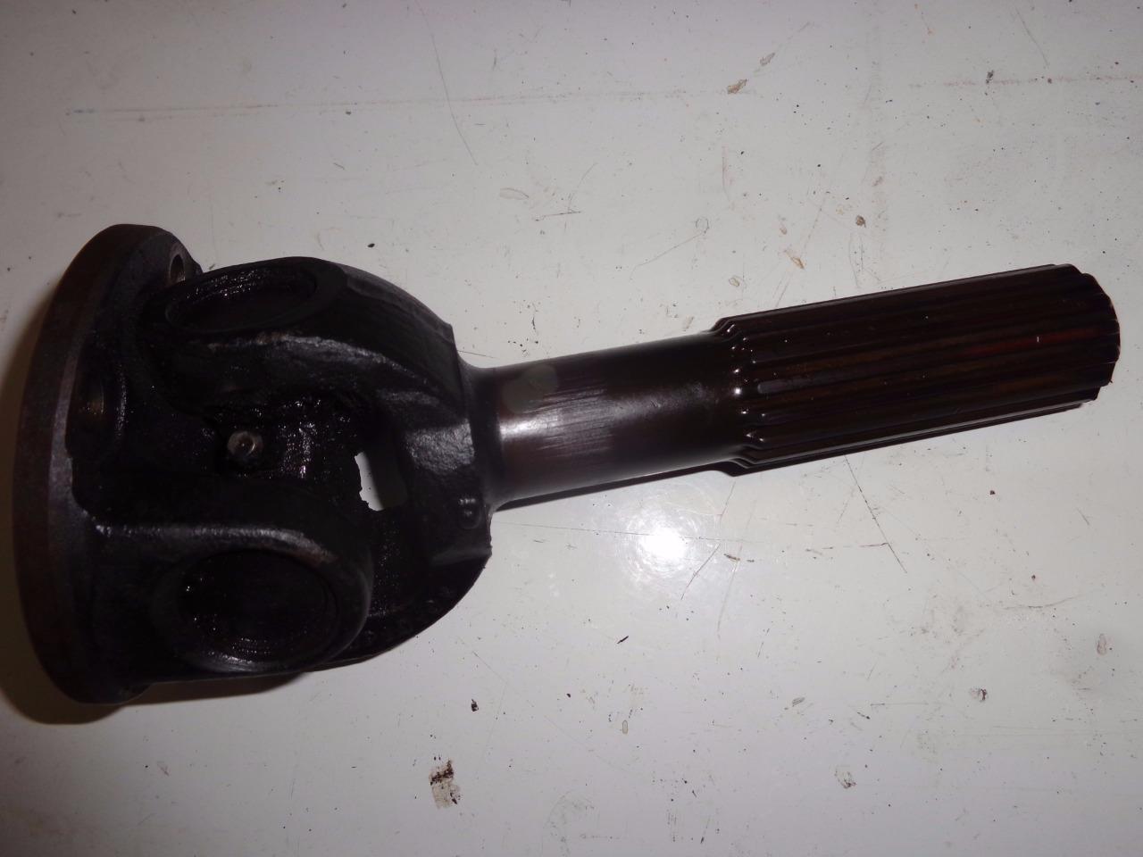

    hi guys.
    im back after years of being away lol.
    im looking to get started on my 2dof design which im planning to bolt under my omega racing frame.
    also ive started work on my own 3d gokart racer based on indoor karting here in the uk.
    main reason for noob post is im having difficulty sourcing a sturdy U adapter to go under the seat.
    ive been googling for hours.
    any help would be great.
    cheers guys and glad to be back at it.

    You can get an old vw/audi drive shaft quite cheap and use the outer cv joint the advantage is these drive shafts are thick and hollow making for a more stable mounting surface

    cheers for help guys. i found a cheap uj and flange set on ebay quite cheap.
    its actuall from a 4x4 so should be good lol.
    just need to buy a cheap welder so i can fix it to a plate.
    will keep you posted ;)

    hi guys, So the Land rover propshaft is spot on for what i need.
    i can even drill down into its centre and wind a bolt in through the base of my chair.
    hopefully will be strong enough to take the motion.
