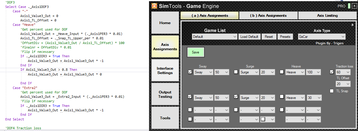

    Hello
    Im trying to make this work so i can set an offset for where a force starts or stops working.
    What im experiencing is that i need to keep a force to 100% to use 0-1 and the decimals within. If i set 30% on the heave and 40% for the offset it wont work even though it should give a value of 0.4.
    Im quite sure i need to convert lets say 30% for the heave here and turn that number into a 100% range for the TL offset.
    It will also need a flip value for code that needs 40% to be -0.4 or whichever number that will be after the conversion as an example
    Id appreciate any help for the code
    Code:
                    'DOF3
                    Select Case ._Axis1DOF3
                        Case "-"
                            Axis1_Value3_Out = 0
                            Axis1_TL_Offset = 0
                        Case "Heave"
                            'Get percent used for DOF
                            Axis1_Value3_Out = _Heave_Input * (._Axis1PER3 * 0.01)
                            Axis1_TL_Offset = ._Snap_TL_Upper_per * 0.01
                            'OffsetDiv = (Axis1_Value3_Out / Axis1_TL_Offset) * 100
                            'finalnr = OffsetDiv * 0.01
                            'Flip if necessary
                            If ._Axis1DIR3 = True Then
                                Axis1_Value3_Out = Axis1_Value3_Out * -1
                            End If
                            If Axis1_Value3_Out > 0.8 Then
                                Axis1_Value3_Out = Axis1_Value3_Out * 0

    Got ya and i appreciate it but sometimes i just want a straight answer to what question i'm actually asking. Im pretty sure you know the answer to this one ;)
    Ill explain this in detail
    DZ 0-10% from any given point the axis is at, agree? Could be wrong but I can't do anything with 10 and I've asked about this In relation to traction loss before.
    Boundary 0-100% works from to X% point
    Offset 0-100% Force does not work until X% if you set it to 50% it will not do anything for the first half of the axis.
    In my case a G seat. Sway raises the axis, Traction loss lowers it. Simplified i set both to 50% and they will cancel each other out. Now i dont want Traction loss to have any effect for the first 80% (80% of 50)so it does not interfere with sway. If i then offset Traction loss offset to 80% or 0.8 (it needs -0.8) in the code then it will accomplish this.
    Code:
                    'DOF4 Traction loss
                    Select Case "Extra1"
                        Case "-"
                            Axis1_Value4_Out = 0
                            Axis1_TL_Offset = 0
                        Case "Extra1"
                            Axis1_Value4_Out = _Extra1_Input * (._Axis1PER4 * 0.01)
                            'Flip if necessary
                            If ._Axis6DIR3 = True Then
                                Axis1_Value4_Out = Axis1_Value4_Out * -1
                            End If
                            ' get offset for Traction loss
                            Axis1_TL_Offset = _Extra1_Input * (._Snap_TL_Upper_per * 0.01) ' not usin this at the moment
                            ' Tune for kick at snapout or overall feel
                            If ._Snap_TL = True And Axis1_Value4_Out > -0.8 Then
                                Axis1_Value4_Out = Axis1_Value4_Out * 0
                            End If
                            If ._Snap_TL = False And Axis1_Value4_Out > 0 Then
                            End If
