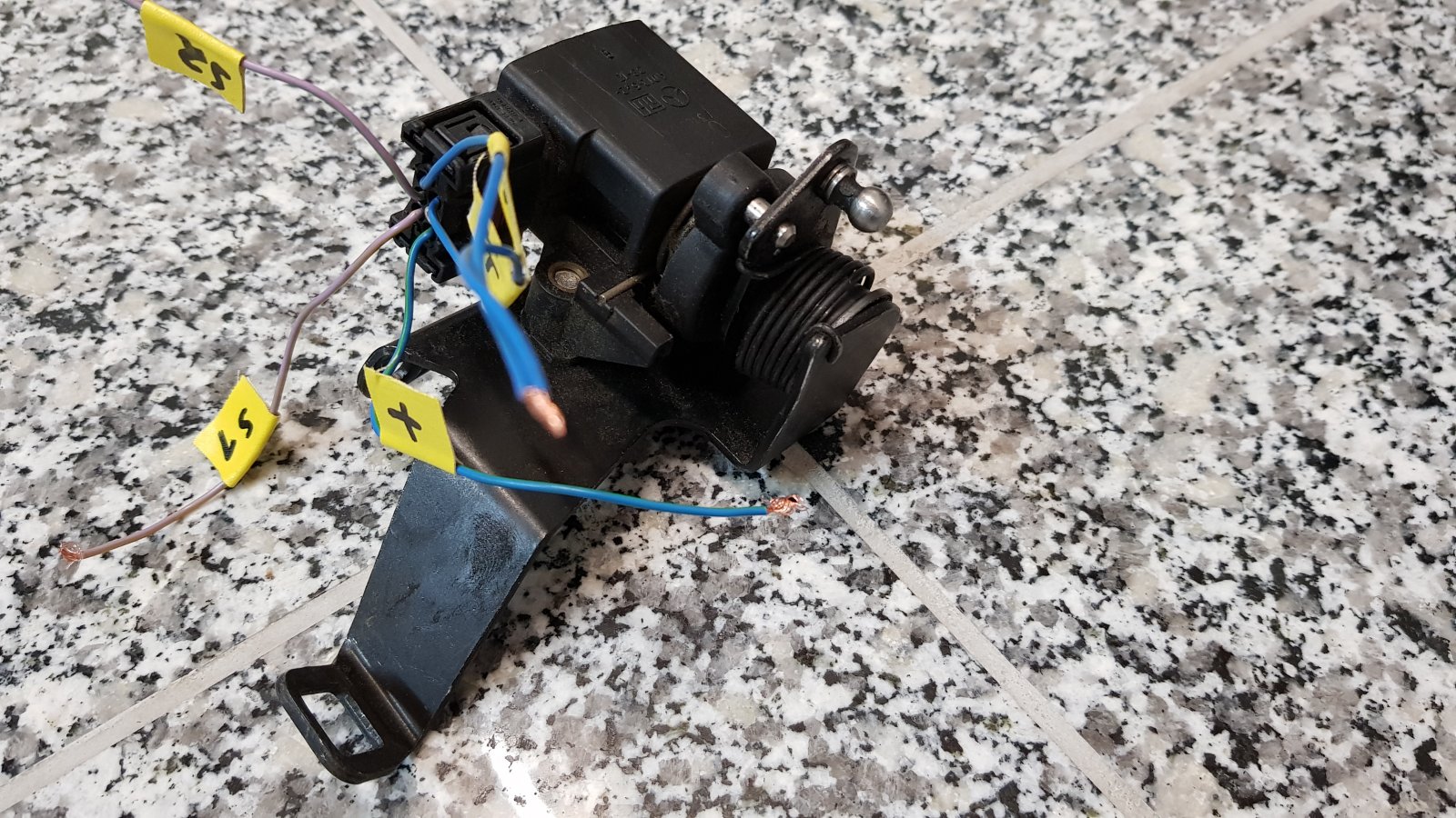

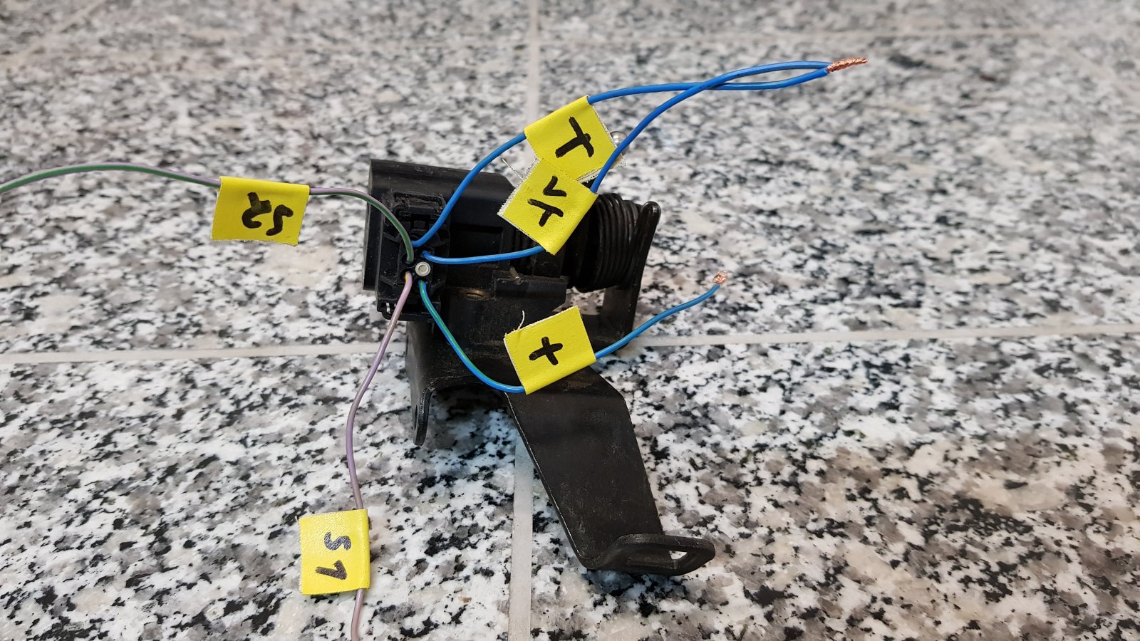

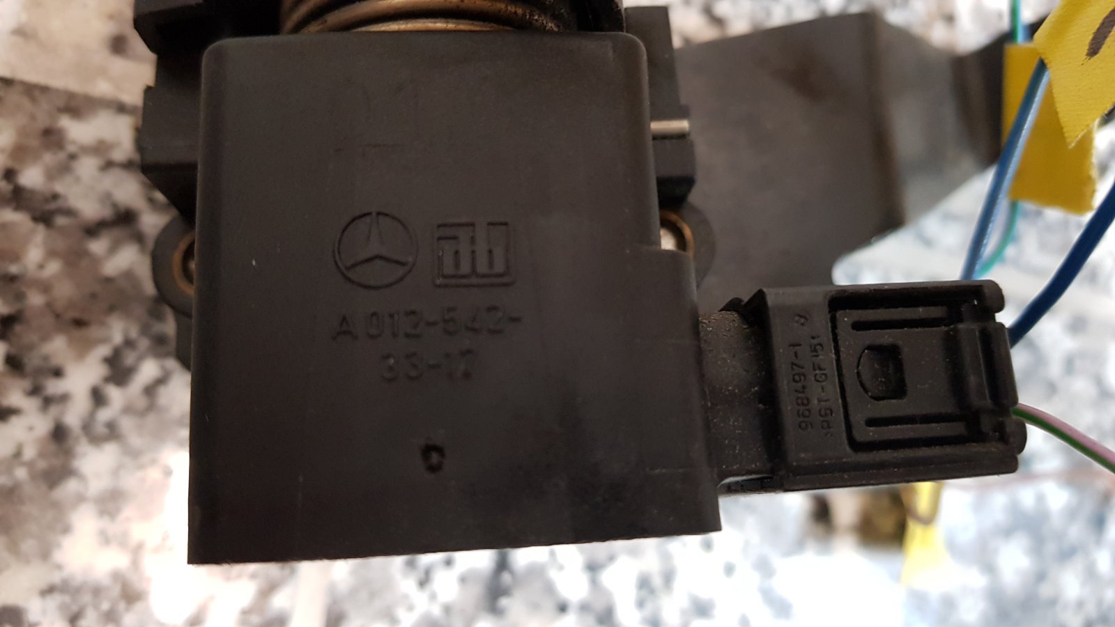

    Hight quality hall sensor used in many mercedes benz cars, new very expensive but reasonably to find on many wasteyards or ebay. Part number A012-542-33-17
    Usable with Trustmaster TRJ12 USB adapter (3V) or Simucube 2 (5V)
    Pin1 Us 3-5V
    Pin 3 Ground S1
    Pin 4 Signal1 0-Us/2
    Pin 5 Signal2 0-Us
    Pin 6 Ground S2
