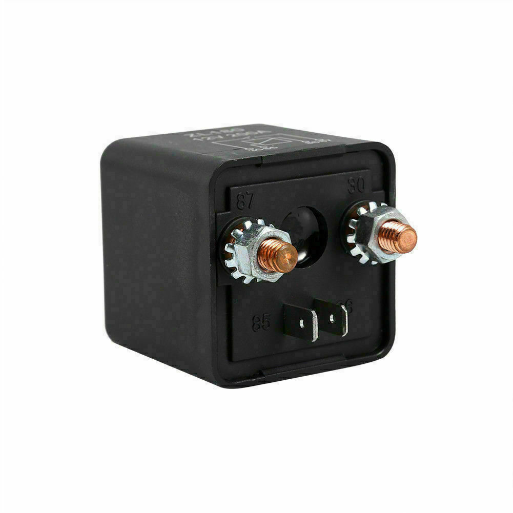

    In another application, I used a car head light globe (12 V 100 W) instead of a resistor to limit the inrush current; then I bypassed the globe by a 2 sec delay timer circuit pulling in a 12V 200Amp Heavy Duty Relay bought from ebay (around A$10.00). You can also manually turn the relay on instead of a timer circuit.
