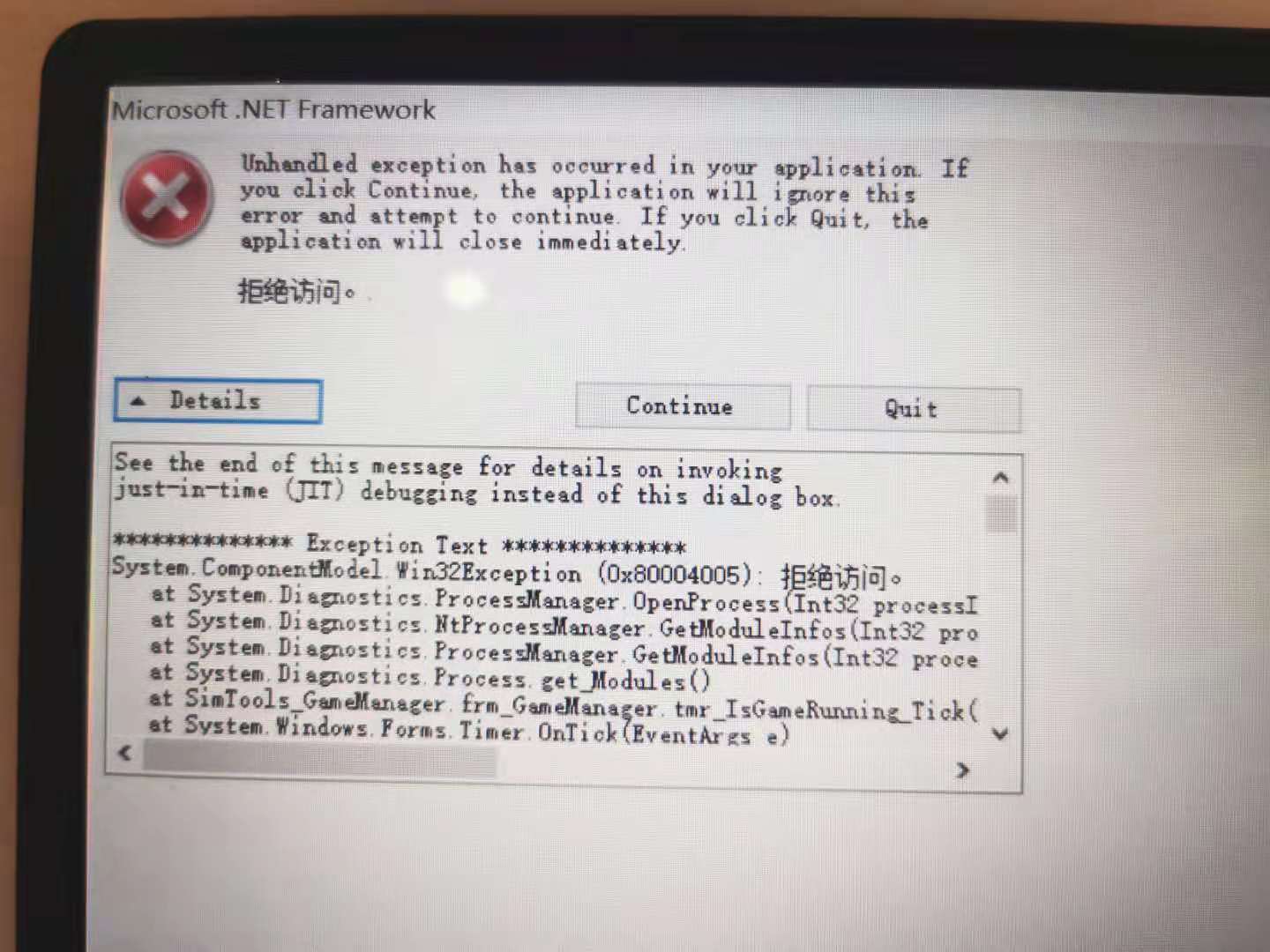

    I tried a lot of methods, the axis test is normal, but still after connecting the game, the servo motor will appear irregular twitch, soon stop. It won't work with the game, and I've tried the advice you gave me, but it still doesn't work. It sometimes pops up error messages, as if to deny me access. Is this a computer problem? I think I should try another computer.I will send the test video later.[​IMG] [​IMG] [​IMG] [​IMG] [​IMG] [​IMG]

    First try switching your Windows settings to English Local, as there is a known language bug: https://www.xsimulator.net/community/faq/simtools-language-setting-bug-change-to-english-local.233/
    Everything needs to work as expected in output Testing before messing with any plugins.
    You can grab a copy of the SimTools manual here, keep it handy for reference: https://www.xsimulator.net/community/faq/rtfm-start-with-the-official-simtools-documentation.117/
    Please hit the Details button of the error message and then copy and paste the full error message here.

    Hello, you're right. It's really because the computer is not English. After I change everything, it will output data normally when I restart the computer. But I tried to change the language to English once, and it didn't succeed, so I ruled out this method until I tried it again.

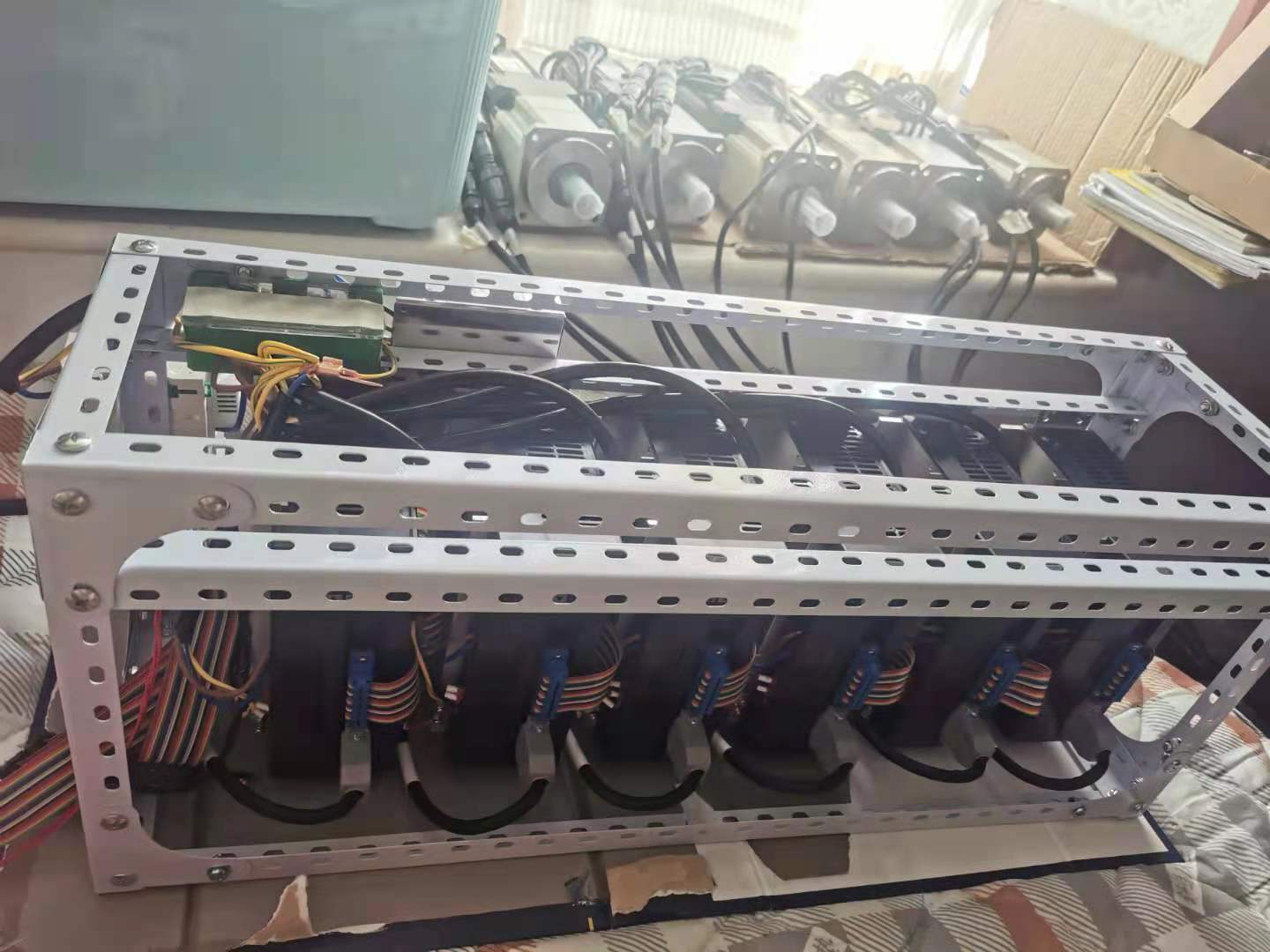

    My servo motor and gearbox arrived, and I made a simple shelf.[​IMG] [​IMG] [​IMG] [​IMG]

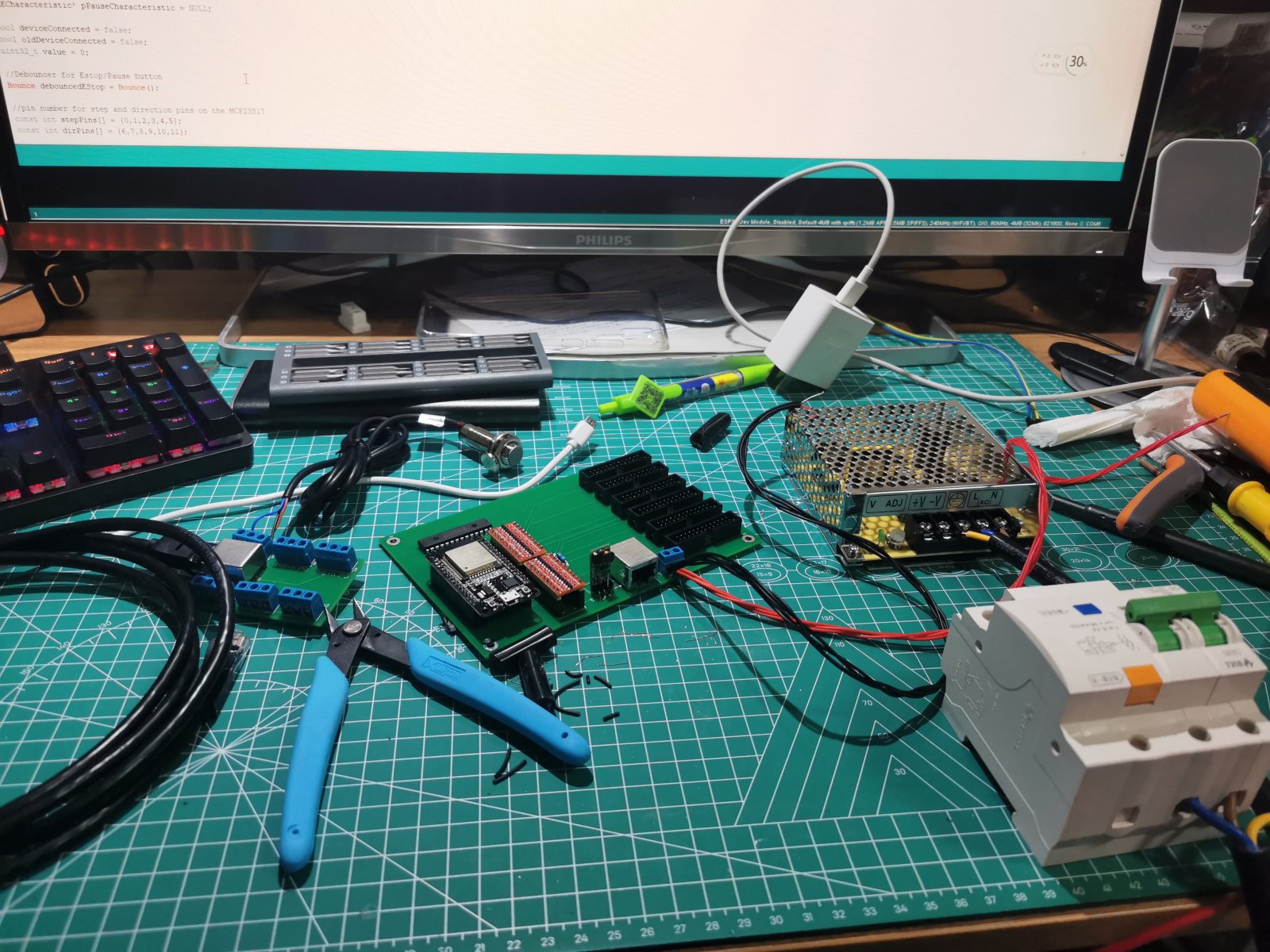

    When I was going to test six servo motors together, it had a problem and the hall switch didn't seem to work. At this time, I suddenly found that it seems that my 5V-12V booster module is not powerful enough. I've bought a 15 Watt boost module and hope it's the problem.[​IMG]
