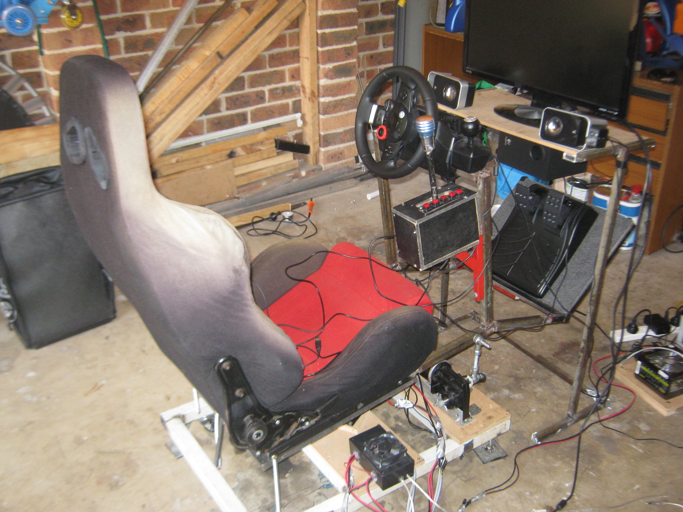

    @ohno , do you have a joyrider sim already? I think they use SCN6 . Are you planning a similar build?
    I have done a rough copy of this in the past with dc motors.
    Joyrider sims have a movable balance point as well to compensate for heavier and lighter drivers to maintain a balance point on its pivot.
    This I have experimented with as well using seat rails. Cannot find pics, but the wheel/pedals/seat was movable back and forth and the motors, pivot, connections stayed still. Hence moving the weight balance on a pivot. It worked well.

    @bsft , that looks cool! yes I own one.. ive had it for a year now.. and it works extremely well for large or small riders.. Unfortunately I have no idea how to take it apart to find out which actuators it uses.. I contacted the company to find out.. should hear back from them soon
