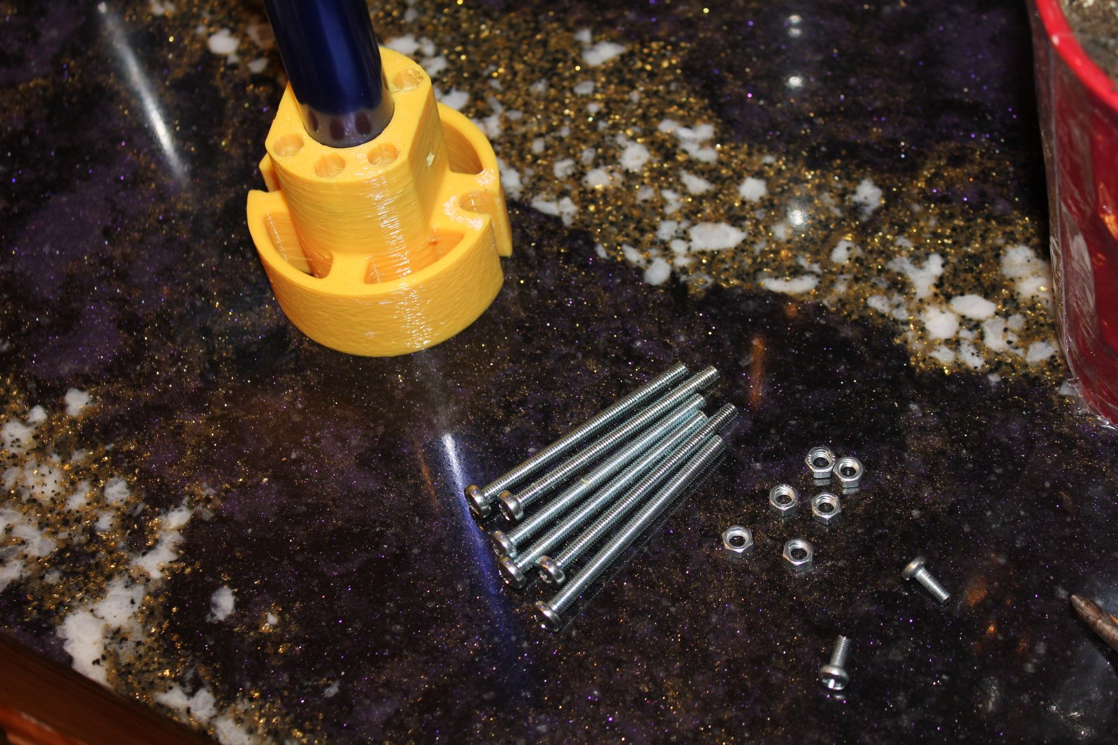

    I just wanted to start a thread with my experience building a @Peacemaker105 , @SilentChill, and @Cannibal Smurf combination actuator. I have used parts from all of their builds to make my actuators and also built a couple of parts on my own. I will update this as I continue to assemble the actuators into their final product. As of now I have 2 assembled, but I still need to decide on how I want to do the upper portion that mounts to the cockpit. Not sure if I’ll go with rose joints or stick with a universal joint type setup.
    So here we go, I'll be doing this little by little when I have time to edit it and add photos. Might be out of order at first.

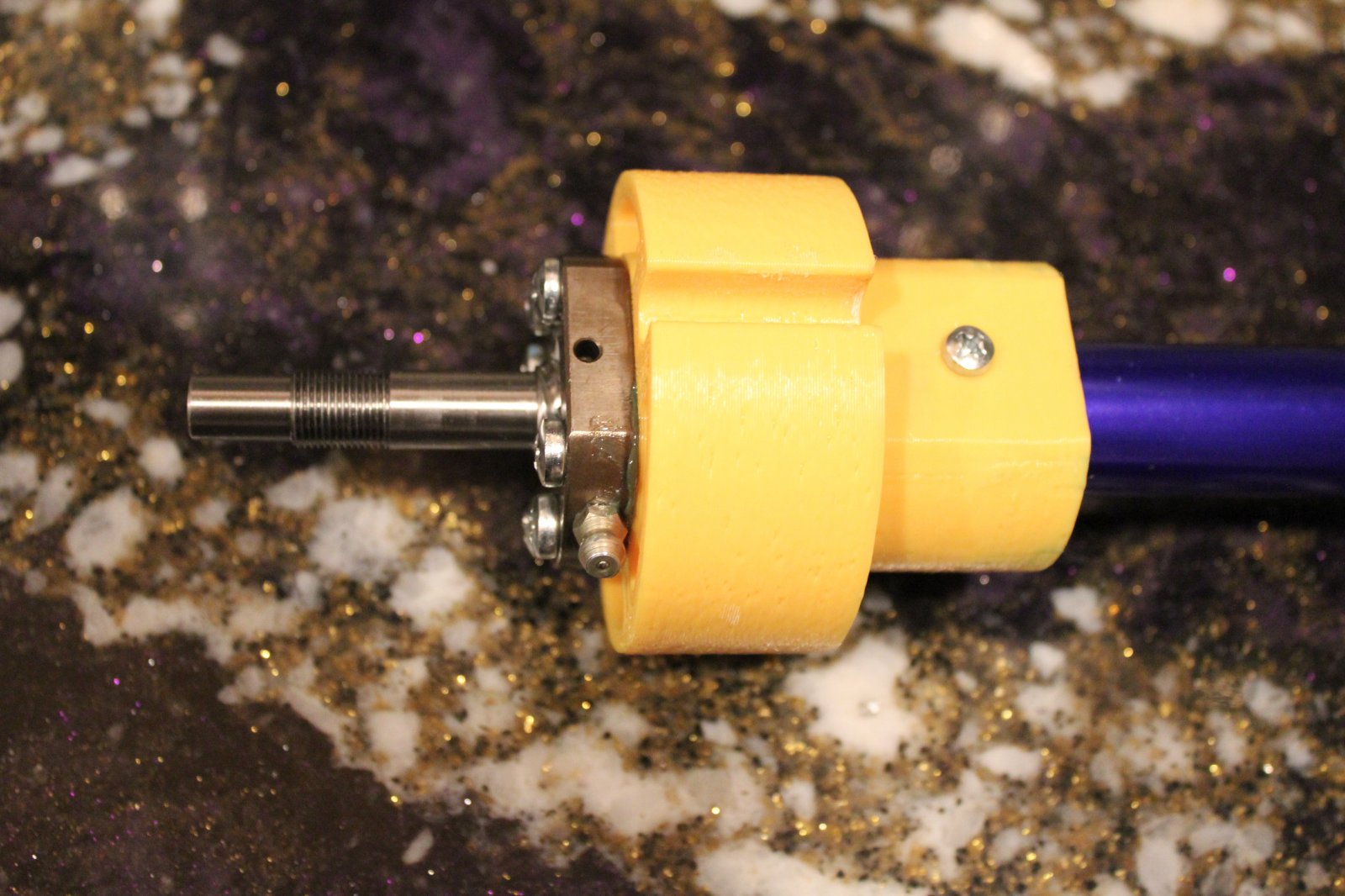

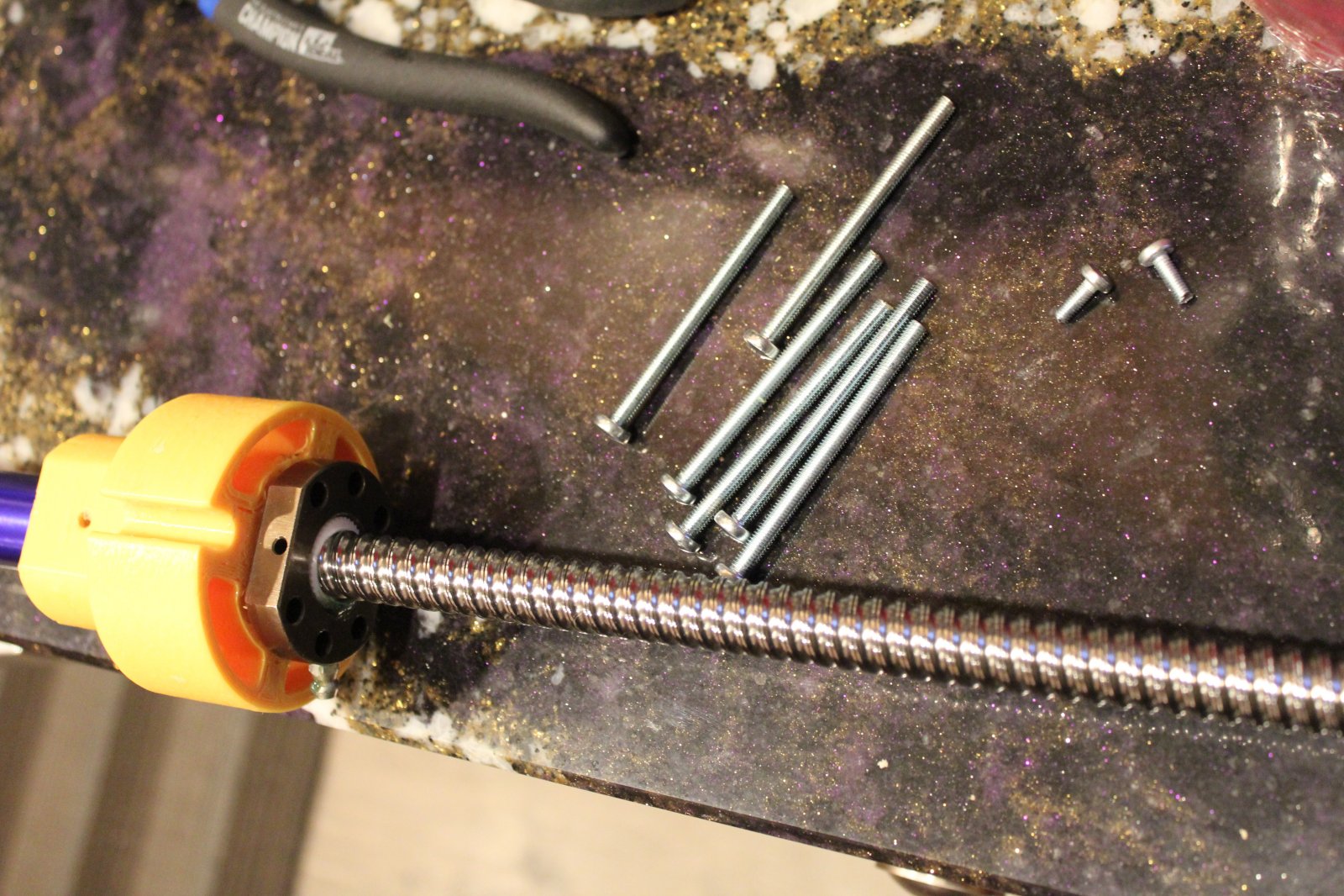

    Here is the push tube assembly.
    You need the following items:
    1 25x600mm tube
    2 m4x12 screws
    6 m5 nuts
    6 m5x80 screws
    6 m5 nuts

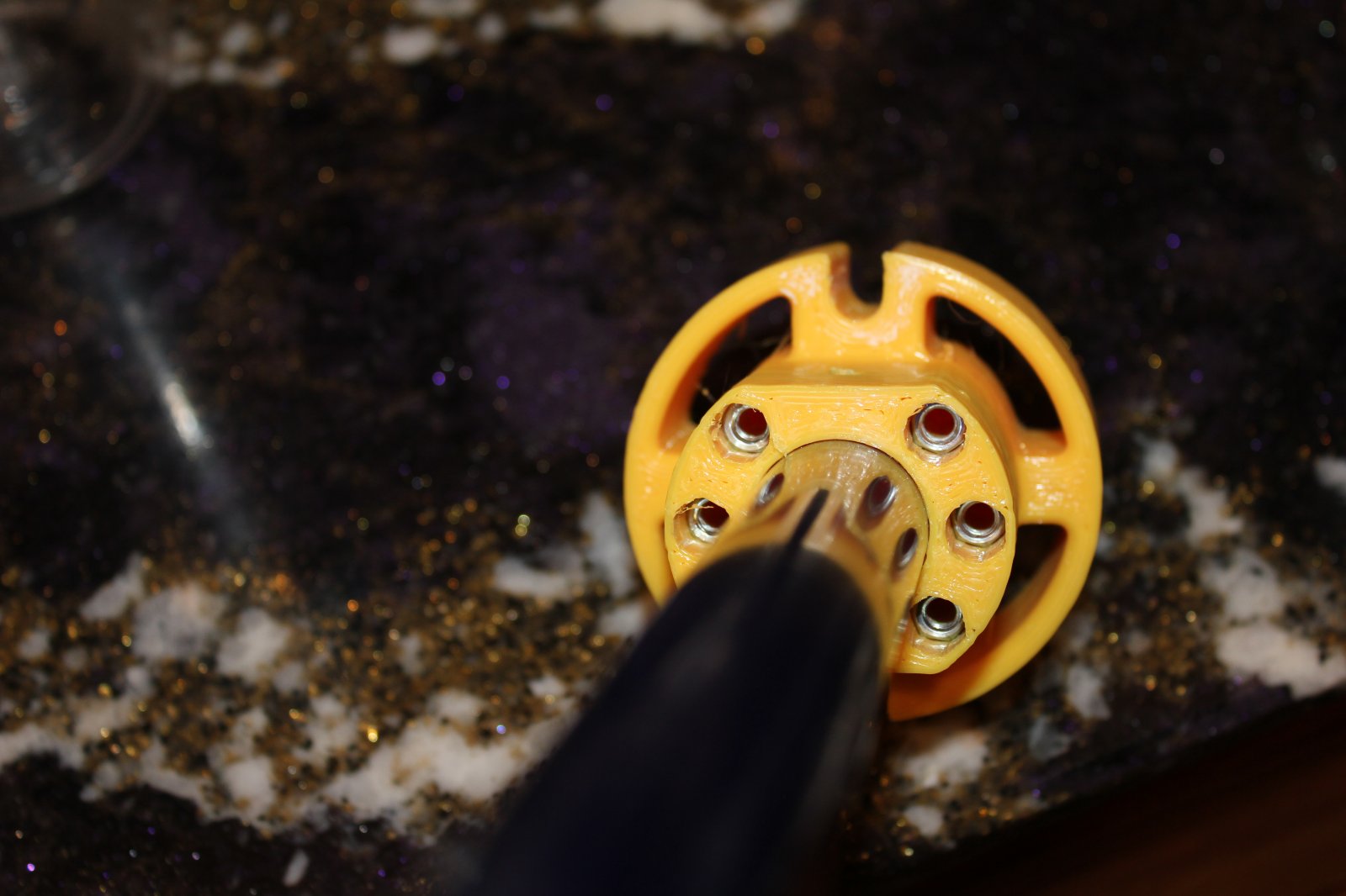

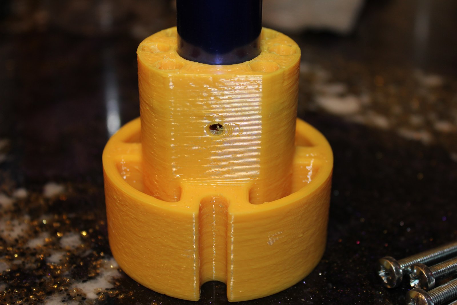

    Install your 6 - m6 nuts into the nut keepers.
    I ordered the wrong size screws. Instead of 80mm I bought 70mm. So I had to sink my nuts deeper in to the plastic slider part. I drilled the holes and used the screws to pull the nuts down into the part prior to attaching the ball screw.
    Slide the push tube into the plastic part and make sure it is flush with the lip on the inside. Then drill with a 3.5mm drill bit and tap with a m4 tap. We will install these screws after we insert the ball screw.

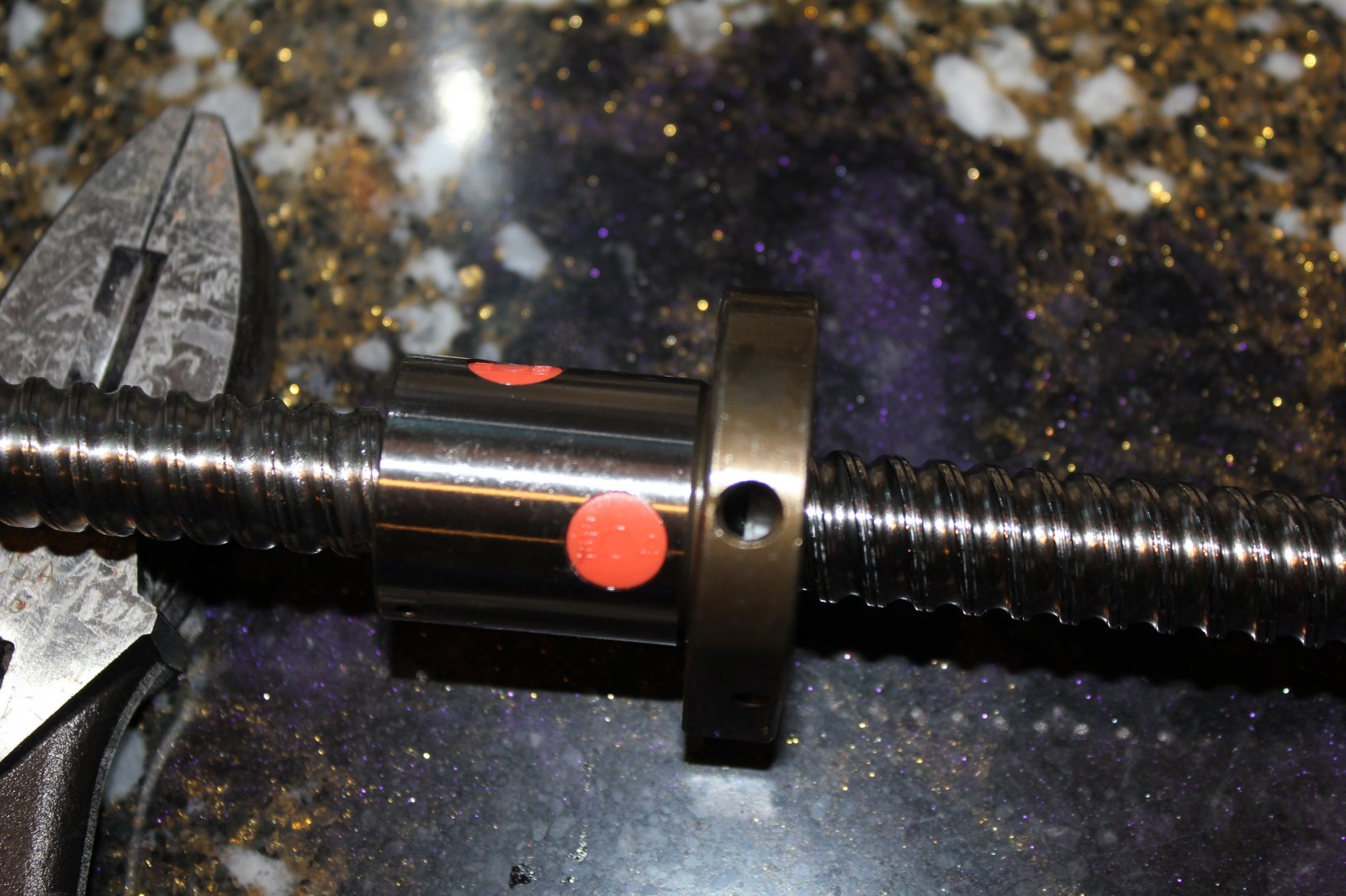

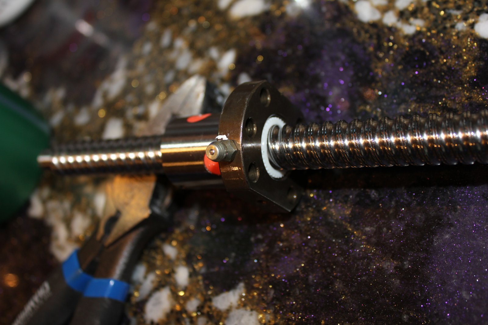

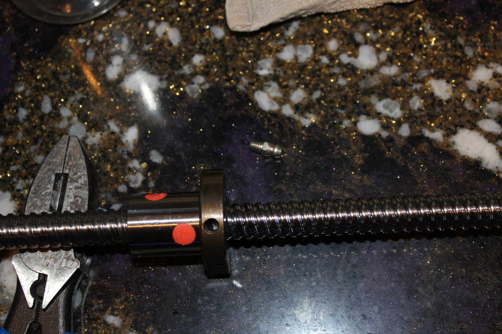

    Ball Screw assembly.
    Items:
    1 -1610 640mm ball screw
    1 -6mm grease fitting
    1 -10mm outside retaining clip

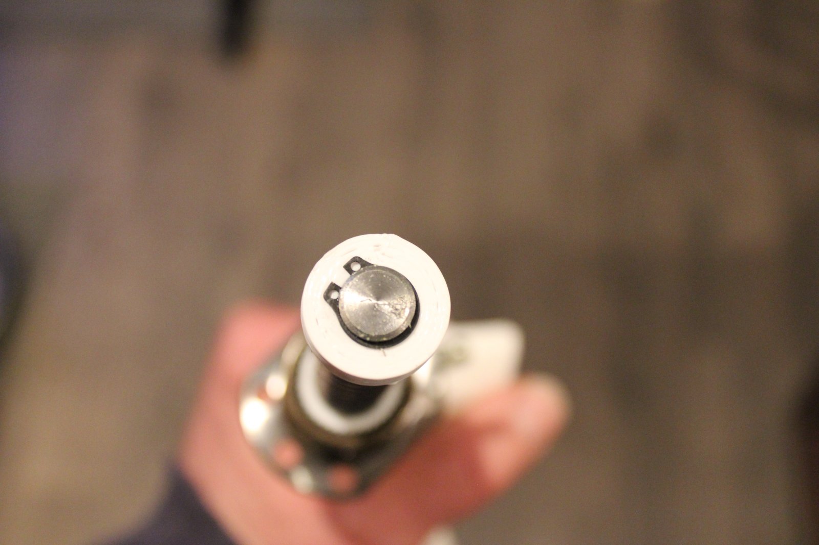

    1 -plastic anti-slap the inside of my pipe part
    Insert grease fitting into large hole on the ball screw nut. I used a little Teflon tape on the threads. Probably not necessary but whatever.
    Next take the plastic anti-slap part and install it on the top of the ball screw and secure with the retaining clip.

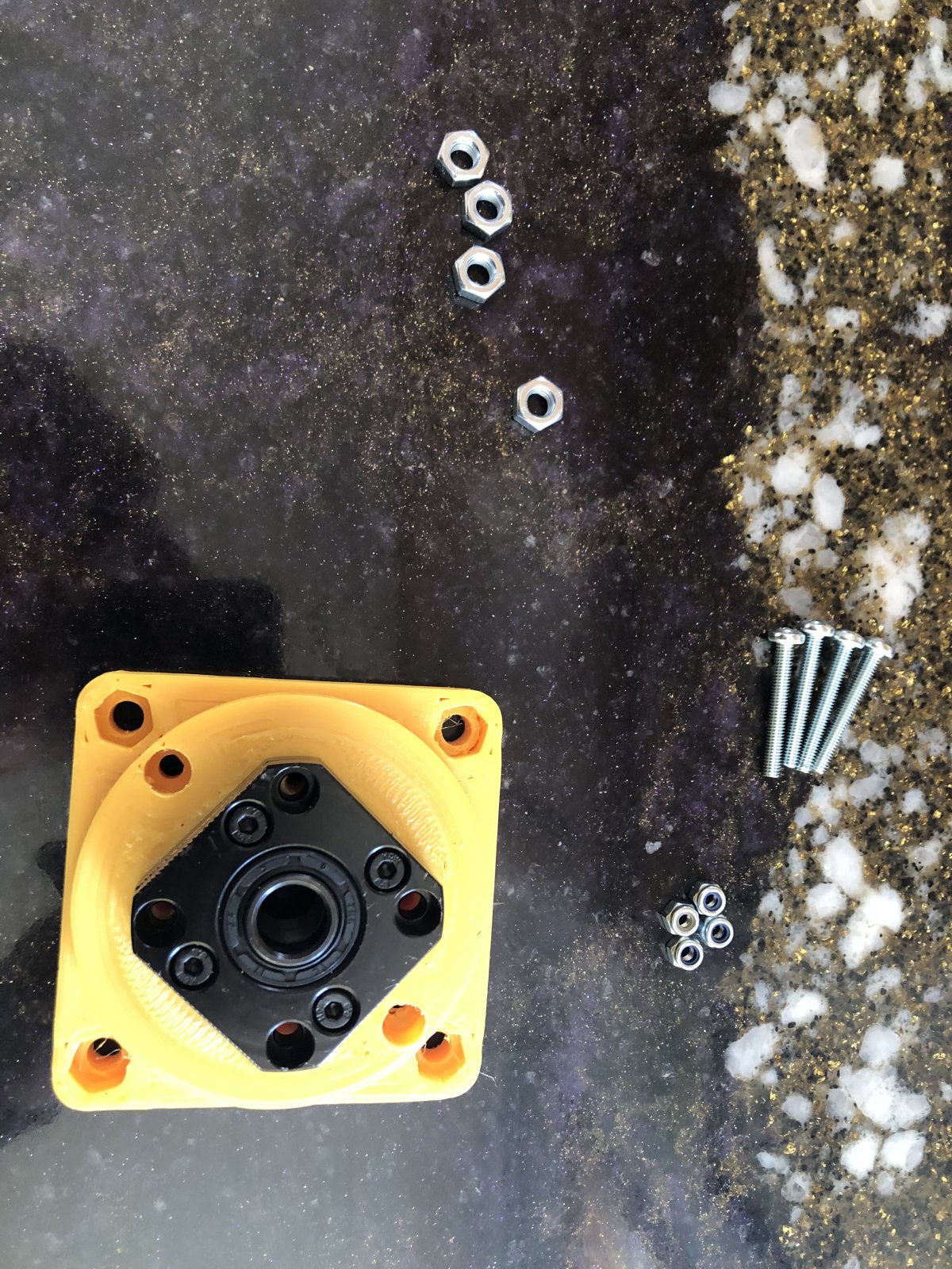

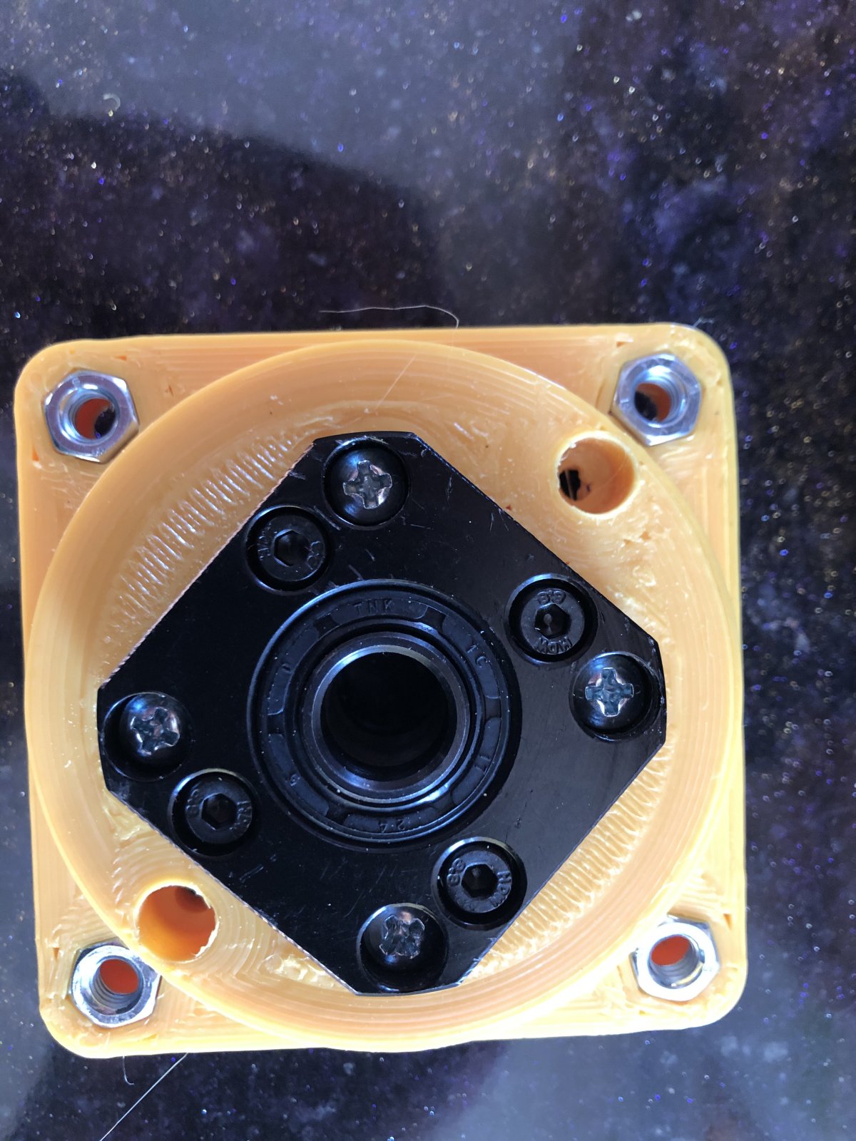

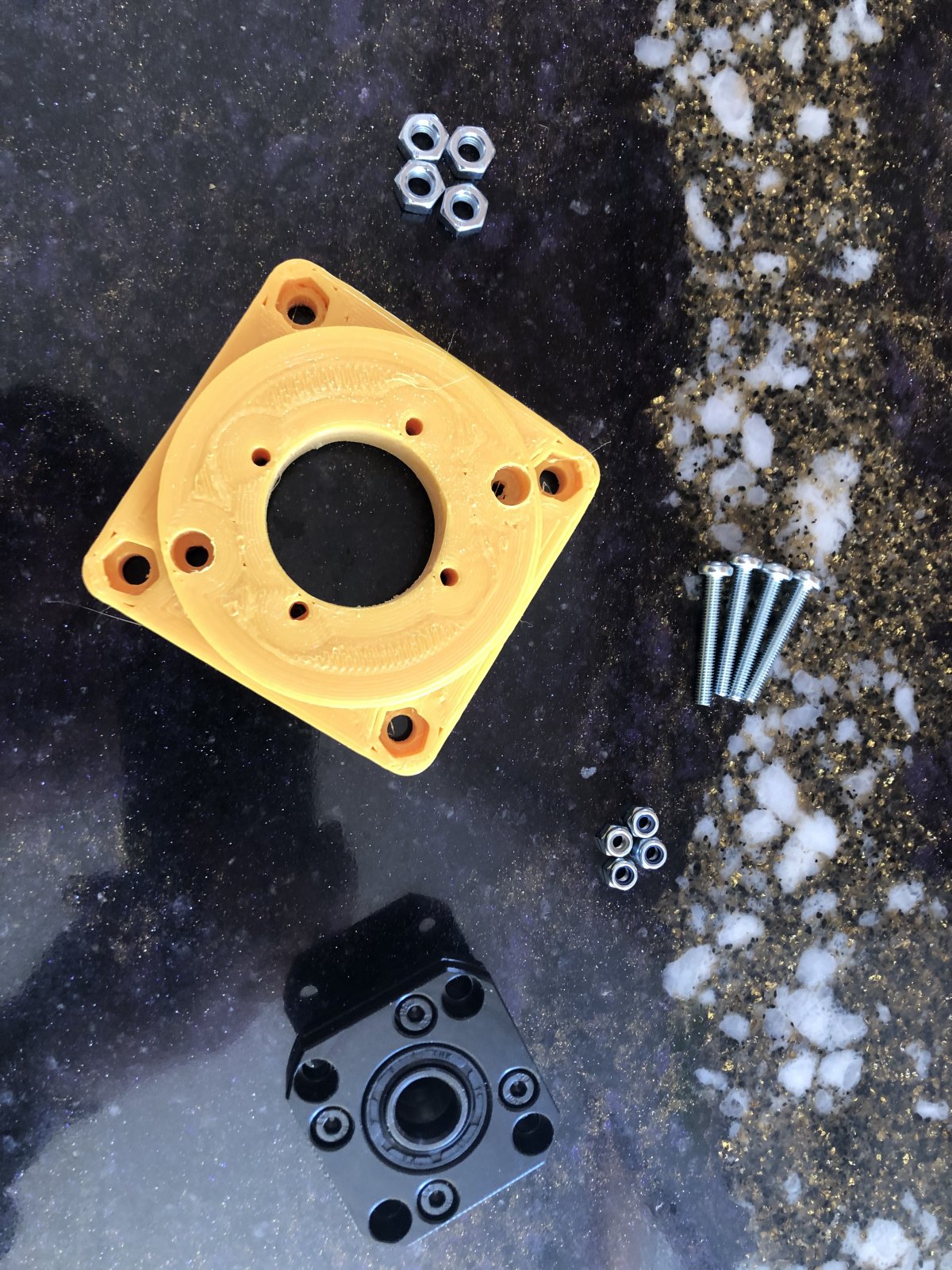

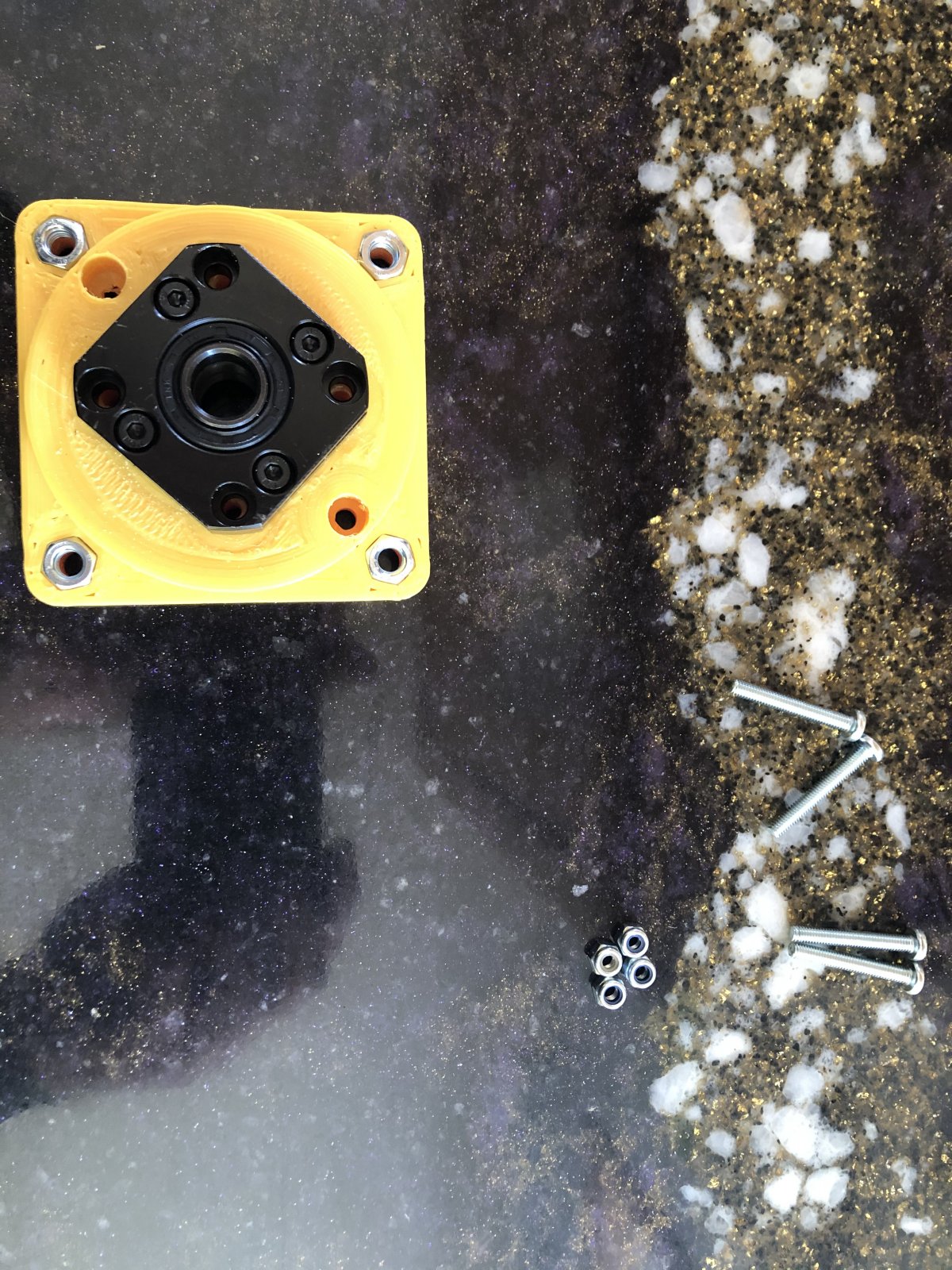

    FK12 bearing bottom assembly.
    Items:
    1- FK12 bearing
    4- m4x30
    4- m4 locknuts
    4- m6 nuts
    Insert bearing into plastic part. Mine was a extremely tight fit and needed to use slip joint pliers to push it in to the hole.
    Next insert the 4 m6 nuts into the outer nut keepers.
    Finally secure the FK bearing in place with the screws and locknuts. This is a good time to make sure you small 8x600mm rods fit in the remaining holes. If not drill them out to allow for a nice fit.
