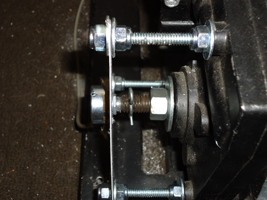

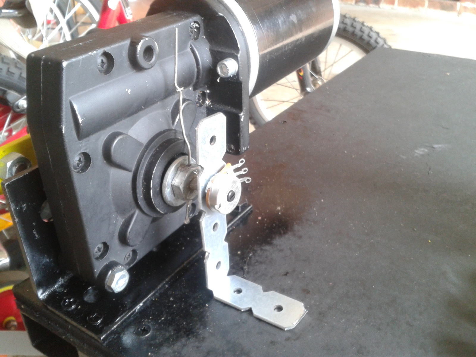

    Or you can do this
    Drill a hole in the back of the motor shaft to the size of the pot shaft, now, as you will be using about 160 deg, a single turn pot will do or even better a 360 deg turn single pot or hall effect 360 deg. Why 360 deg continuous? If you make a mistake or the motor lever throws too far, you dont break the pot.
    And you will get better resolution for feedback.

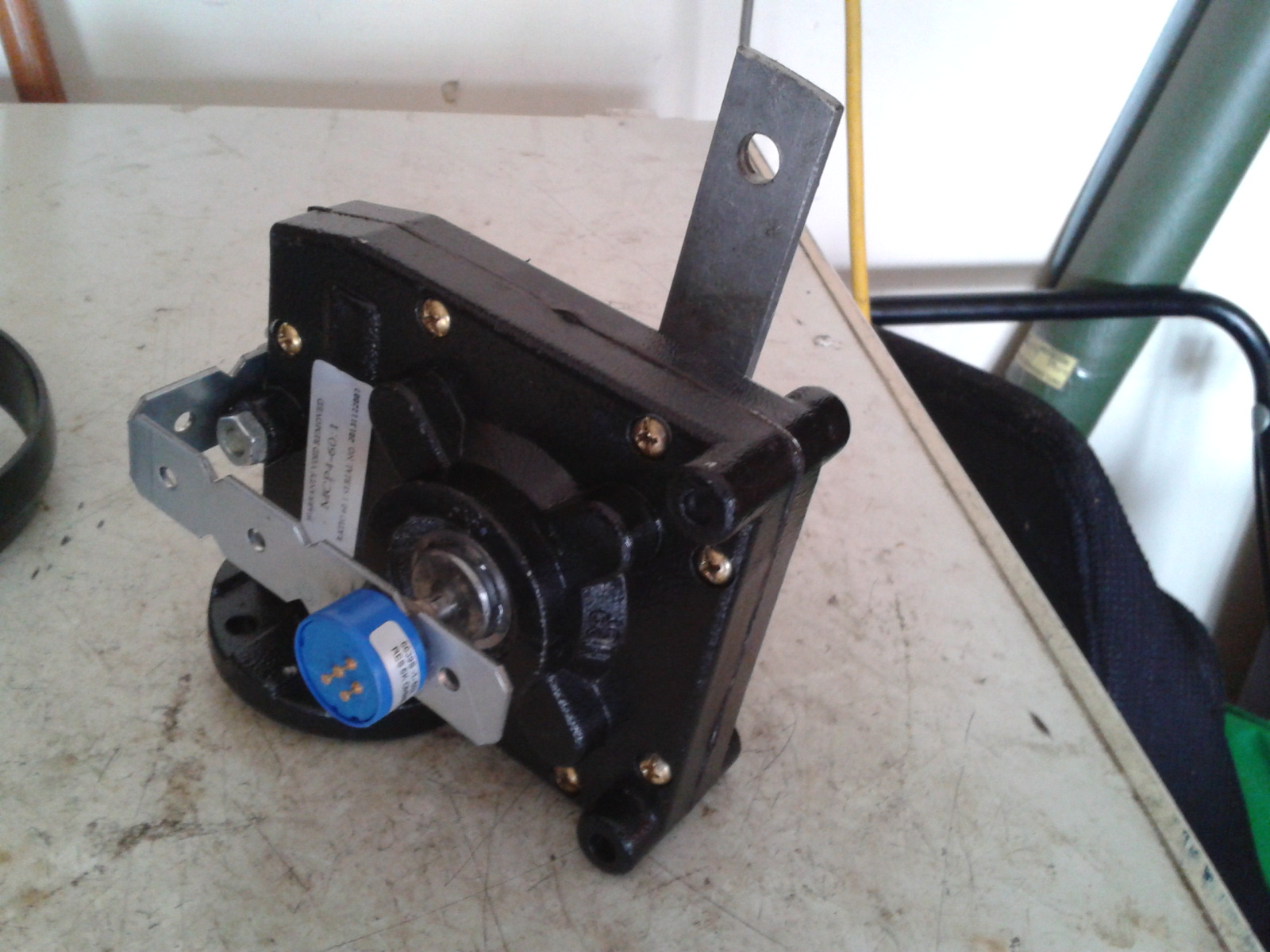

    Method above in the video is one of the better ways to mount a pot specially if you going to use the ard , if the motor runs away because the ard has locked up or lost its signal then the pot will never be turned a full 360 deg and break but the resolution on the feedback is low. To increase this resolution which results in a nice motion on the sim you need to use as much as the pot as possible.
    I now use 180 deg hall effect connect in the same method pictured below.
    They are directly connect to the shaft of the motor that drives the lever.
    I used heli gear on my winchs with mutiturn pots for even better resolution of the motion.
