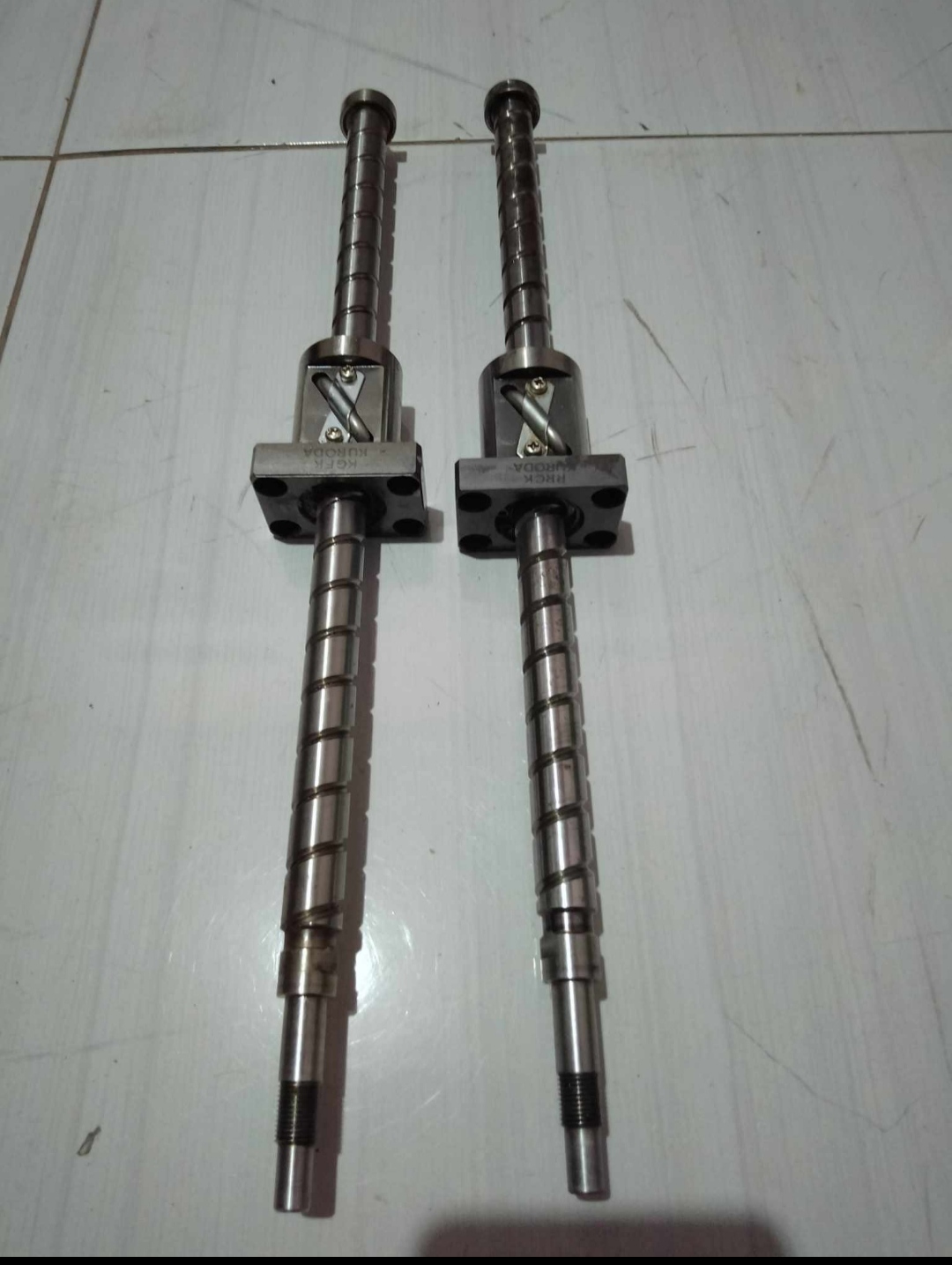

    Hi i have ballscrew with 15mm diameter and 15mm pitch, leght 350mm like on photo, it posible to used for actuactor?? I will used motor with gearbox ( rpm around 300rpm) it inaf for the actuactor??
    @noorbeast can u help me? Maybe i will used firt for my 2dof

    You can use them for a seatmover {2dof} it gives 750mm second at 3000 rpm withoud gearbox
    Minimal a 100watt motor needed for a seatmover.

    I just have motor with gearbox sir, so if i used with gearbox i cannot reach 150mm/s???

    Only when youre rpm is 600

    with a 15mm pitch, for every revolution of the ballscrew, it will move 15mm linearly. If a motor with a gearbox is capable of providing 300 revolutions per minute (rpm), the linear speed of the ballscrew would be 300 x 15mm = 4,500mm/min or 4.5 meters per minute. Consider if this speed is sufficient for your application.
