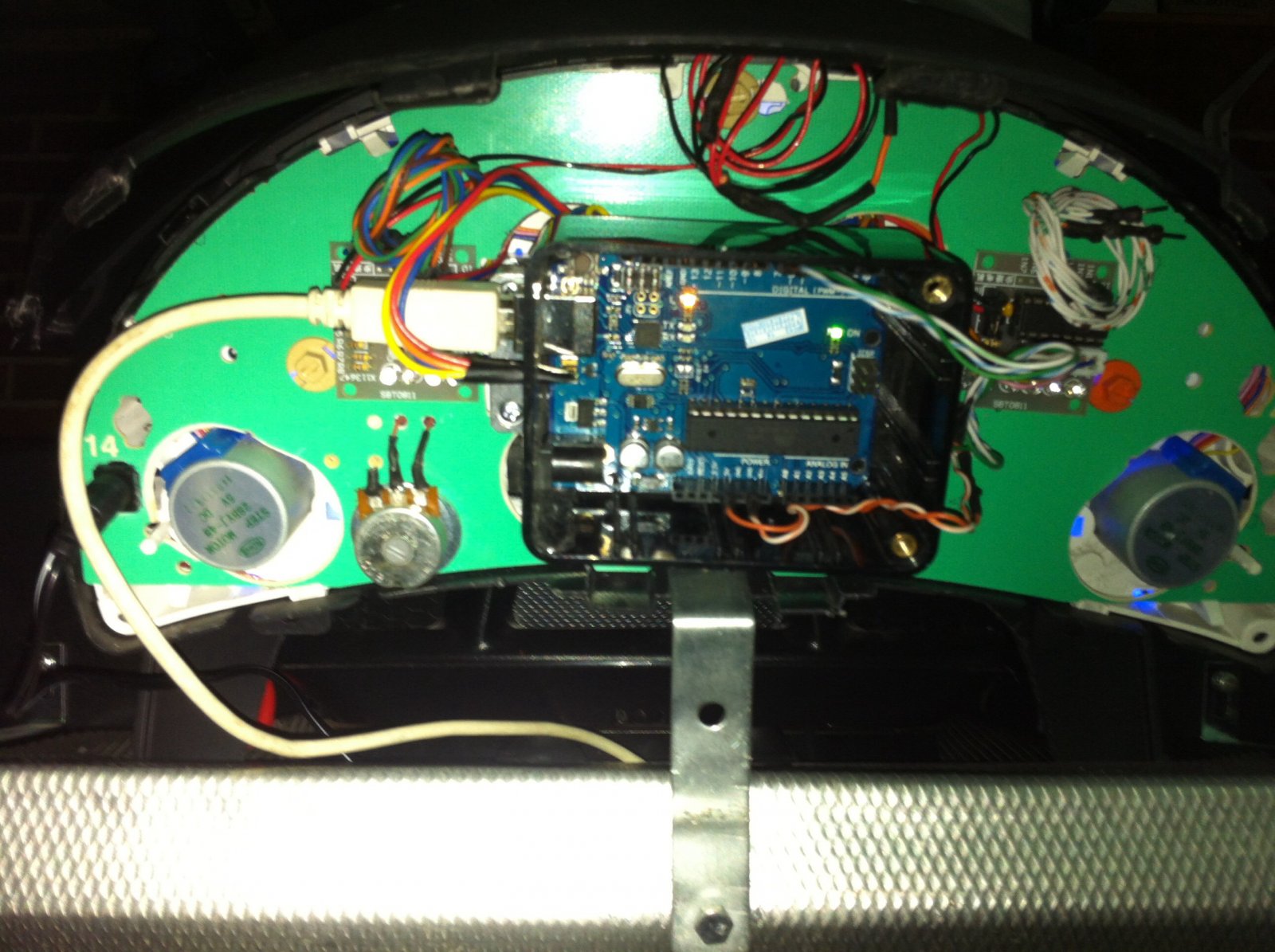

    Yep we sure did, using steppers and stepper drivers, just completed another one , using a ford dash panel.
    Rear view: 2B8E3039-79AC-45C2-87B7-40FCD5874EE8.jpg
    We actually had to remount the Ard and Drivers away from Steppers as noise was interfering with the precision.
    So the answer is yes can be done and not too hard or expensive to complete, Sorry no more info as this is an ongoing project, but welcome to start your own.

    One stepper per gauge, basically we cut out the original drive and mount a stepper within its place and glue the needle to the stepper shaft, and drive it with a pololu 10 buck driver which to keep it simple is only driven with 2 pins.
    I have a board Im developing for this same process, will contain pin outs for placing an ArdUNOr3 on it and 6 stepper drivers and a 595 to drive up to 8 leds , all to save on wiring it up for newbies as this kind of mod has been asked about heaps but not simple enough for newbies to grasp.
