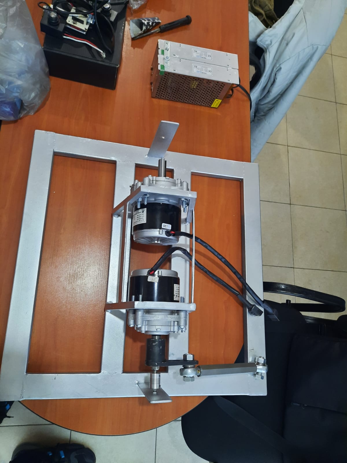

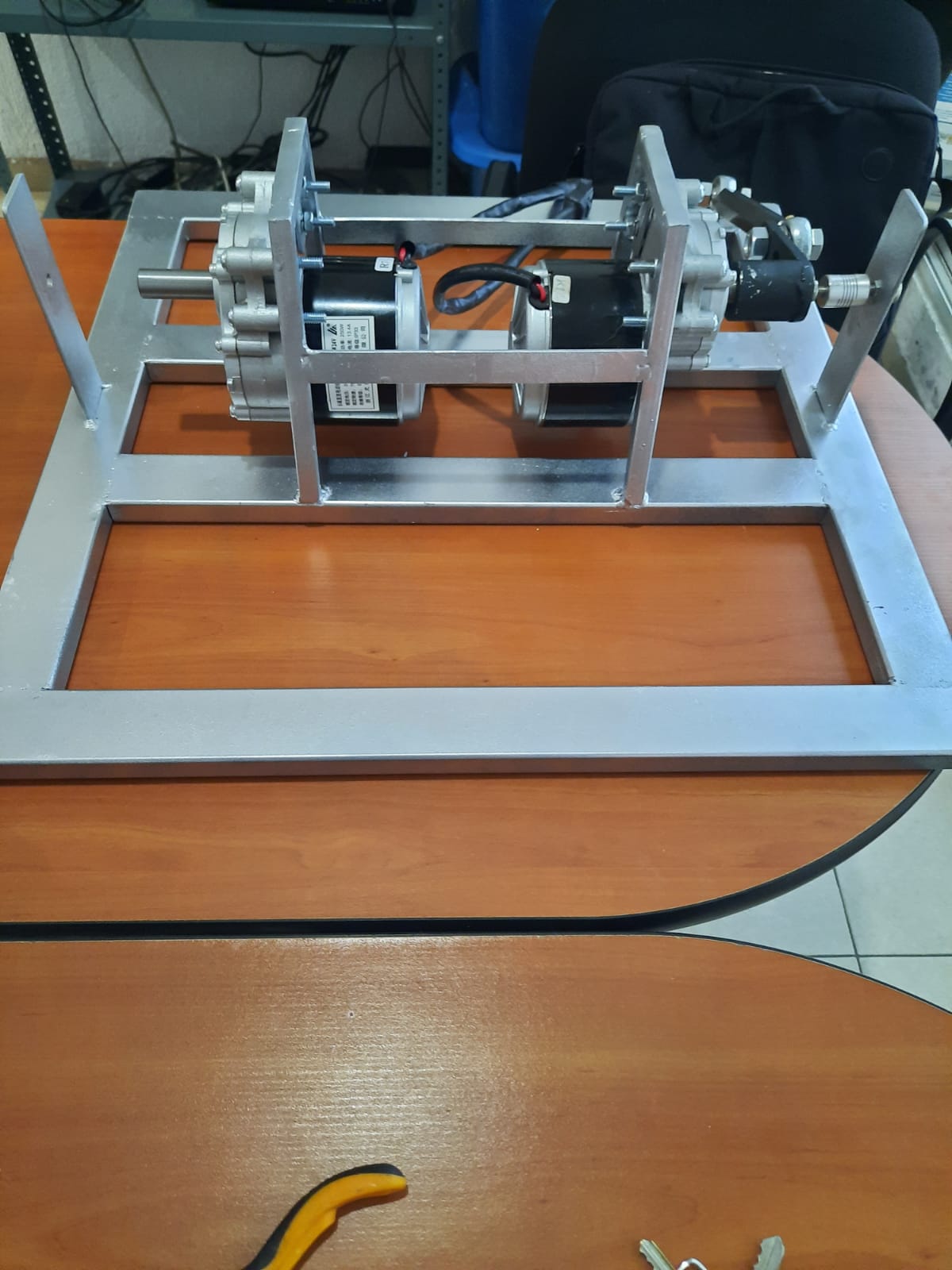

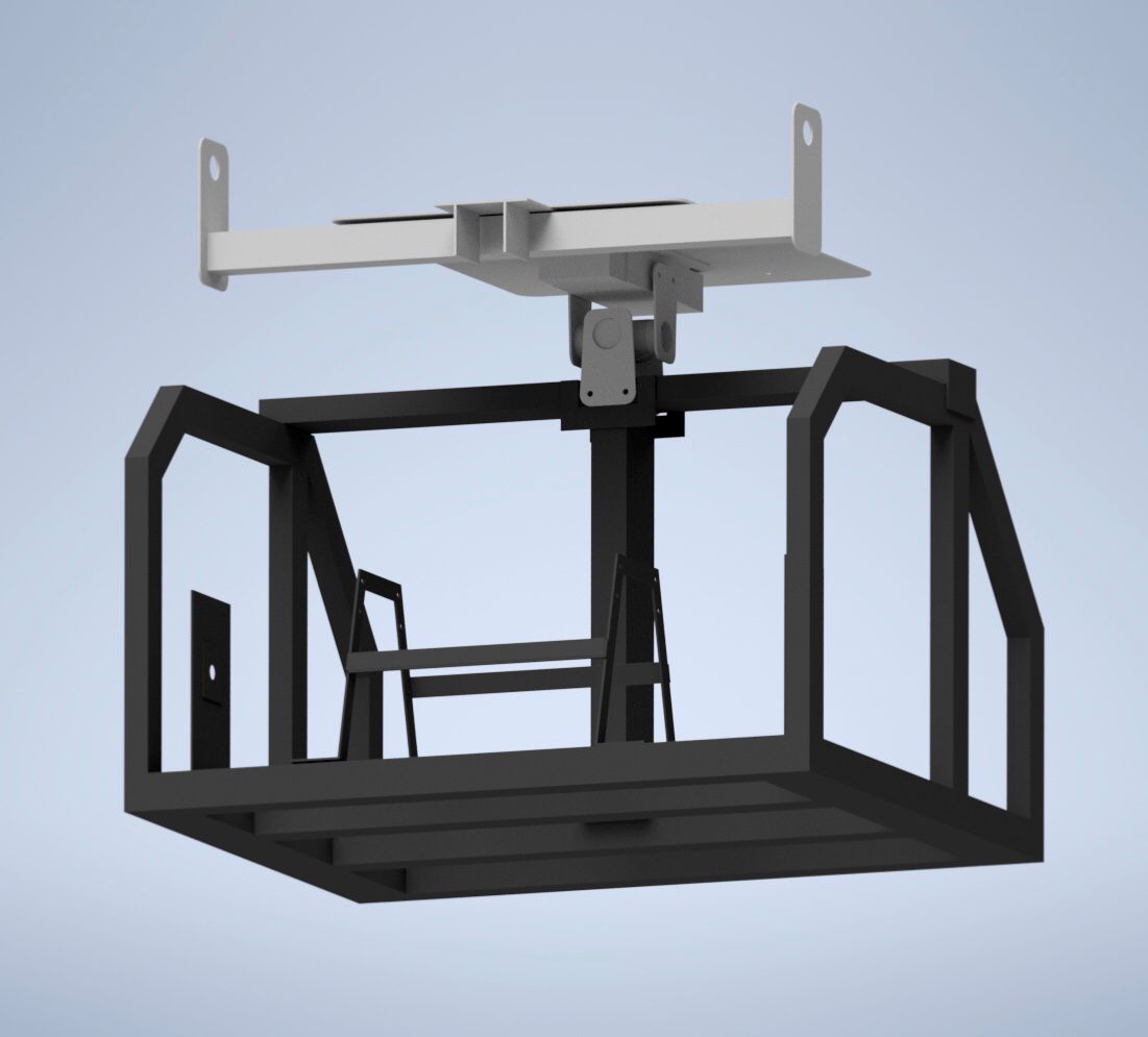

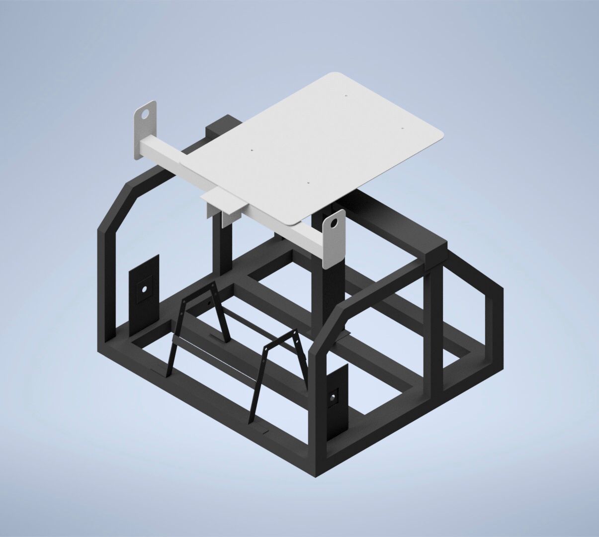

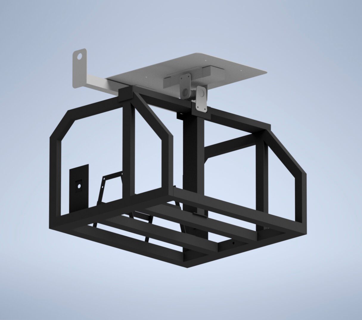

    This is my compact simulator , im using two chinese wheelchair motors 24vdc 36NM rated torque 60rpm, arduino as main controller , IBT2 motor drivers and 24vdc 15amp power supply . The mechanical concept it is based on the noorbeast's compact simulator but with severals differences. im planning to move the 20% to 25% of the weight of the person seated , so according to the motor torque calculation these are enough. so a picture is worth a thousand words:
    Im just doing my best..
