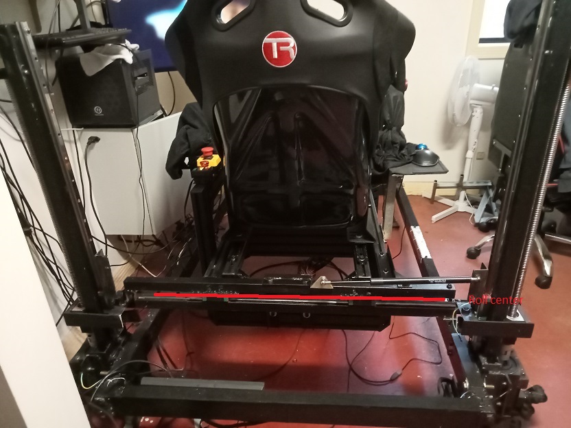

    Although a bit different in design then most, I have a three legged platform were I can adjust were the Roll center is in relation to the simulation frame (just under the seat at the moment). If required, I can drop the frame another 36cm, which would move the roll center into the middle of my back. Looking to add in some G systems in the future, but am happy in how it performs at the moment.
