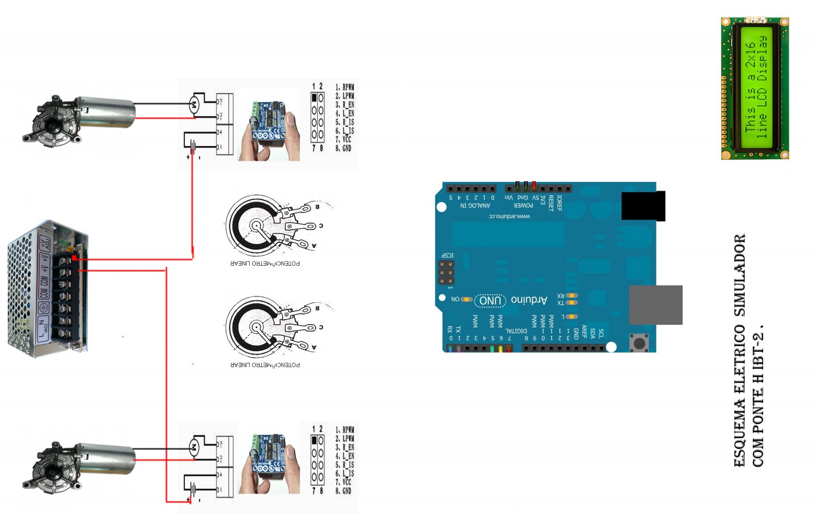

    1.Arduino uno r3 connect to BTS7960 --------------- ok
    2.Download the smc3 to arduino and i have change it to model2 ----------------------ok

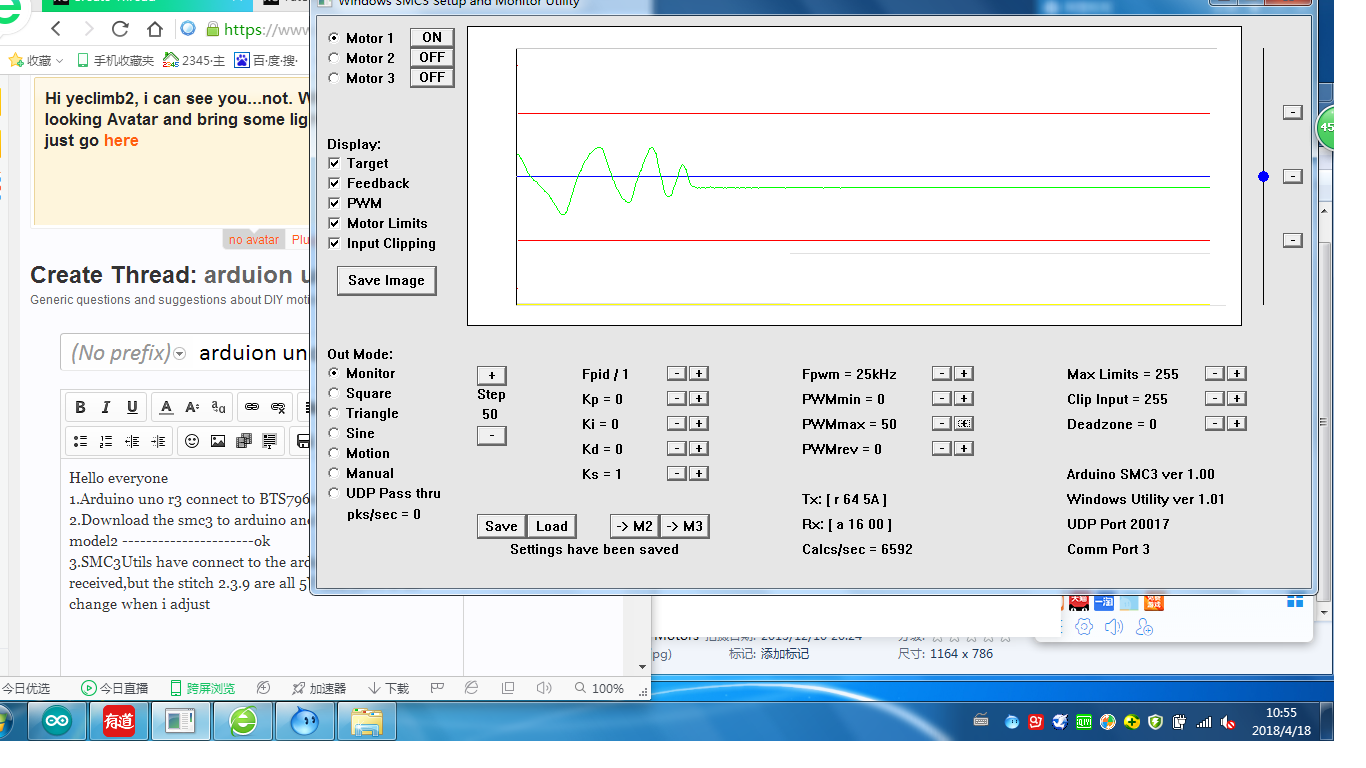

    3.SMC3Utils have connect to the arduino,the pot can be received,but the stitch 2.3.9 are all 5V and there is no change when i adjust PWMmax--------not ok
    PWMmax adjust which stitch?

    haha,
    I find that Ki must >10,the motor can move now
