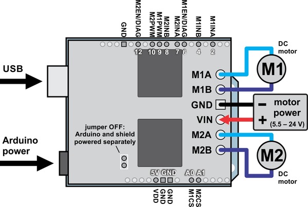

    I am ready to, for the first time, get my motors running;)
    I have a ard. uno R3 and the pololu dual motor controller vnh5019. Which is a shield.
    I would like to stack them to cut down on the soldering.
    Is it at all possible?

    There is a major issue with stacking mate, you can not isolate the two and if the drivers fail they will fry the Ard and anything connected to its usb port, an expensive boo bo , its why I recommend them not to be stacked, and as @Historiker has stated clearly , all your questions have already been answered in other post by others using the same driver. Just poor reading I feel,sorry.
    @RacingMat the driver wires up the same way as the Monster Moto, think it uses a couple of different pin numbers thou, but has all simular names, very easy to hook up.

    The driver in question can drive current back from the motor when it moves unassisted by the driver, like a generator, this if too large for the vn chip to handle can be sent to the Ard, I use isolators when using ards with high powered drivers, I have personally lost a very expensive motherboard due to this same issue as Prilad explains in his post they are recommended to protect the ard in turn protects your pc from fatal voltage spikes, they do happen if you run the driver hard enough.
    This is why I don't personal recommend stacking them.
    On another note have you ever checked how hot they get, I have recorded 140c on them while running 25amp winches flat out. So not having them stacked allows for better cooling. As the card is designed to dispate heat from the bottom as well as the top of it too, so having air space under them helps them cope a lot better.

    @RacingMat I have removed the pots as suggested but I don't know what you mean by 1 or 2 direction pins. Is that m1inA and m1inB?
    if so then i THINK this is the revised hook up for a pololu vnh5019
    arduino => pololu vnh5019
    pin 4 => pin 2 m1inA
    pin 5 => pin 9 m1 pwm
    pin 6 => pin 10 m2 pwm
    pin 7 => pin 7 m2inA
    pin 8 => pin 4 m1inB
    pin 9 => pin 8 m2inB
    5v => 5v
    GND => GND
    POTm1 => A4

    So with your help I have made one step forward. While the boards were stacked I was not getting any reaction from the motors. After rewiring to the above layout I have the motors running, ty eaorobbie. but 1 way all the time. (good thing I removed the pots racingmat.)
    I am still using the racingmat sketch in the uno. I will take another video so it might be easier to follow.
