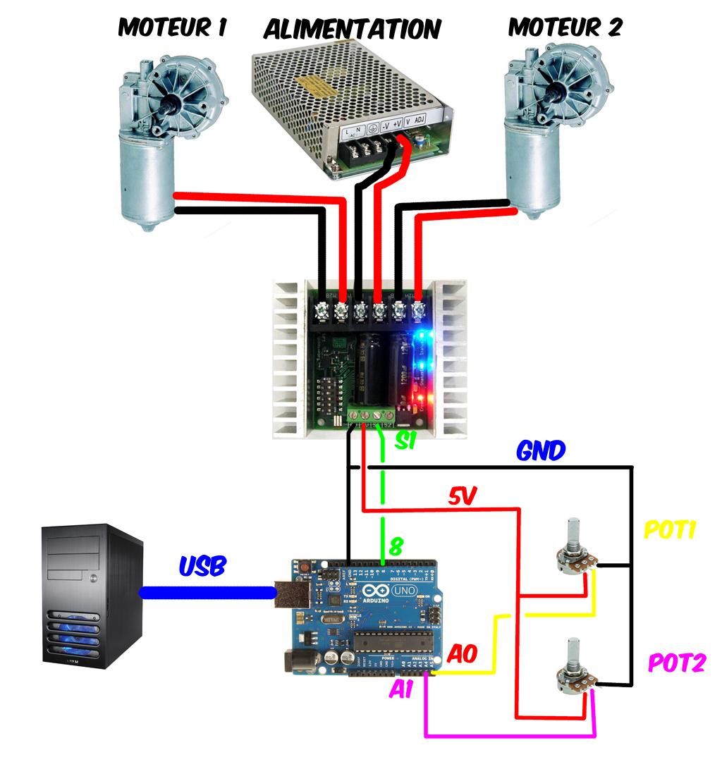

    Hi guys,
    I intend running sabertooth + kangaroo but as a first step, I ran Arduino + Sabertooth.
    You can find the code here the Arduino code modified to suit to Sabertooth
    http://www.xsimulator.net/community/marketplace/arduino-code-2dof-for-sabertooth.103/
    The present code uses the Sabertooth "Simplified Serial" protocol:
    - it is OK with Sabertooth 2x25, 2x60 (don't use 2x12 which is too weak)
    - Sabertooth 2x32 is compatible by legacy.
    But 2x5RC, 2x12RC models don't seem to be compatible.
    The code requires 2 libraries
    - software serial is already in the Arduino IDE installation
    - and Sabertooth library has to be downloaded here https://www.dimensionengineering.com/info/arduino
    https://www.dimensionengineering.com/software/SabertoothArduinoLibraries.exe
    //Sabertooth DIP switches 2, 4 and 5 OFF
    // serial between Arduino and Simtools on RX pin: 115200 bauds
    // serial between Arduino and Sabertooth on SWSerial pin8: 38400 bauds
    Arduino pin8 <--> Sabertooth S1
    Arduino GND <--> Sabertooth 0V
    Arduino A0 <--> Pot1
    Arduino A1 <--> Pot2
    The wiring is extremely simple: only 3 wires between Arduino and Sabertooth
    Wiring schematic from Wanegain ;) Thks!
    Use the same presets as for Arduino and Motomonster
    Game Engine axes presets
    Game Engine Interface presets
    - it is OK with Sabertooth 2x12, 2x25, 2x60

    Thanks a lot for your work. I want to use a arduino uno r3 and sabertooth for my simu 2dof with 24v dc. I already buy the arduino board but not the sabertooth. For you, shall I buy a sabertooth 2×12 or a 2x25? Thanks for your anser
  6. RacingMat
    2,234
    20,895Coins
    +2,084 / 21 / -2
    Hi! sabertooth 2x25
    2x12 is too weak to be used with smolka for example

    You can buy the new 2x32 for the same price than 2x25!
    The 2x32 is really better and it's delivered with 2 resistive for generative current. Very useful.
