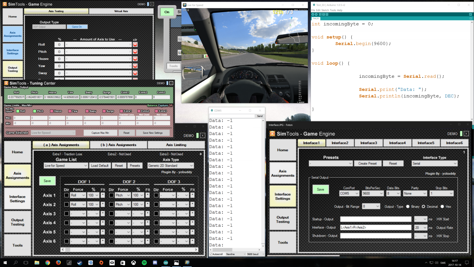

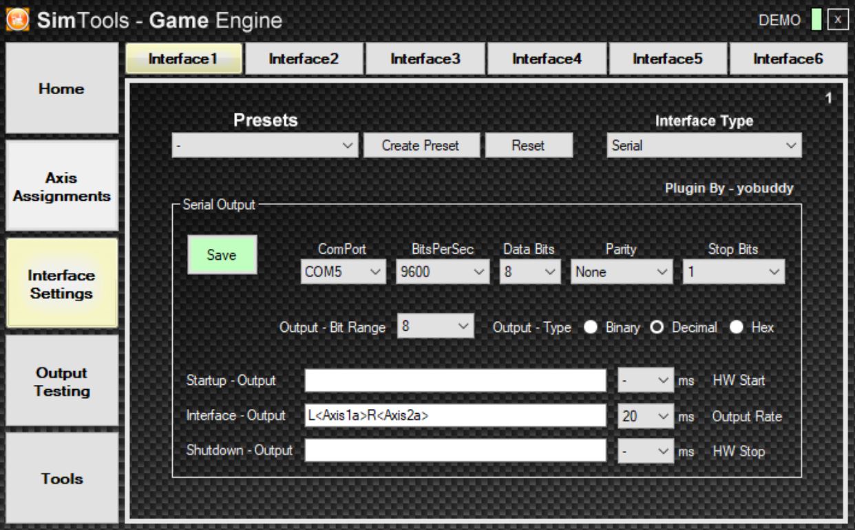

    My Arduino is not receiving any serial data from the Game Engine.
    The Arduino speaks to com5 9600 BPS 8 Data Bit None Parity 1 Stop Bit.
    Ive reinstalled all Windows updates containing .Net Framework via Windows update since .Net no longer can be reinstalled or uninstalled on Windows 10.
    Ive searched the forums for a solution and seem to have tried everything by now.
    What am I doing wrong?
    In Picture:
    My Arduino Serial Monitor should be receiving incoming data but only returns -1

    In the Interface Settings instead of axis defined like this <Axis1> it is now has designate grouping for a or b for each axis assignment, like this <Axis1a>

    Thanks, I tried that and unfortunately no luck. Nothing changed. Any more suggestion?

    Didn't wanna give up that easy and I found out that I couldn't have a serial connection via Serial Monitor because it came in conflict with Simtools serial connection to the Arduino. I have no idea if this is suppose to work, but it doesn't and Simtools don't warn me that there is a conflict either. I found that out because I tried to make a serial connection via Putty to my Arduino. Putty then complained about a conflict with Simtool.
    So my solution for the debugging problem was to lcd.print the serial data to a display instead.
    In other words, it worked just fine as it was, i just couldn't see the data.
