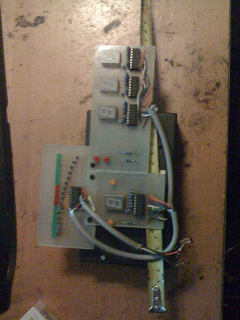

  13. eaorobbie
    20,400Coins
    +1,683 / 23 / -2
    Well blow me over, that's my old picture from a very old post, XDash.
    I will search my drive, sure I still have the original code somewhere.
    Picture of the boards I had made -
    Contained a Rpm Light bar on one pcb, another had a 7 seg gear indicator and shift lights, the third board had a speedo and warning lights for oil and water. Might have to dust it off and fire it all back up.
  14. eaorobbie
    20,400Coins
    +1,683 / 23 / -2
    Ok found my old code, lol was for the old software, now to test in SimTools.
    Ok Rpm needs to be an 8bit decimal in order for this code to function under the GameDash.
    Script needs to change the outputted Rpm to 0-255.
    Command - Rxxx where xxx 0-255.
    Ok need to plug it back into my test ard and fire it back up and change the code so we can use this with GameDash.
    If ya beat me at it , I hope this helps.
