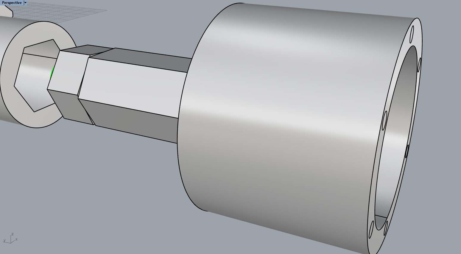

    Figured out the joint without welding. Huh. Left is to the base shaft, and right to cardan. Should make minor outer size reduction of the nut. Outer is 13mm, should be 12mm.

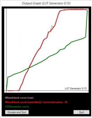

    So the charts in numbers. One rev to 360deg from 0 revs, and time for it. Responce time from the moment the signal are made.
    Some DIYs and not only for comparison.
    Motor770, (100% gain, basicaly 50% gain are used)
    (362.84deg-0.13deg) ( i.m. how many degree close to 360deg, were taken for calculations, and time to reach it consumed.)
    362.71deg for 184ms
    1000ms/184ms = 5.4rev/sec = 324 rev/min minimum.
    8ms to respond from start
    My1025, without wheel, with 12V, 12,5A (150W instead of 300W the motor requires) 1:4gear
    (368.53deg-8.76deg)
    359.77deg for 208ms
    1000ms/208ms=4.8rev/sec = 288rev/min minimum.
    12ms to respond from start
    BSSim My1016, 1:4gear (50% GAIN Mmos)
    (366.59deg-1.79deg)
    364.76deg for 236ms
    1000ms/236ms=4.2rev/sec = 252rev/min minimum.
    6ms to respond from start
    POWER steering motor, Conventional steering wheel, 18.8V
    (362,32-0,26)
    362deg for 236ms
    1000ms/236ms = 4.2rev/sec = 252rev/min
    4ms to respond from start
    CGWheel (Caravangoes), Lightweight wheel, 1:3 gear.
    360.94deg for 246ms
    1000ms for 246ms=4.06rev/sec = 243.6 rev/min minimum.
    And.
    OSW Direct Drive, Sparco
    (361.47-0.39)
    361deg for 304ms =3.28rev/sec=198rev/min
    2_ms to respond from start
    G27
    Just a chart)
    10ms respond from start.
    The scooter motors for ffb wheels, are quite a "that’ll do". [​IMG]
    IR ffb gain was 12% enough. Without IR LUT add on.
    Once again the my1025 rotaion rate. Ordinary heavy wheel.
    Also the BSSim vids.
    https://youtu.be/yiHT_YgN8Aw
    Only, are there a need to use 24V12.5A for 300W motor, (if now 150W-12V,12.5A, are used with 300W motor) if the Mmos (whatever), BSSim gain is set to 50% with full power supply? Guess that'll be all the same. Or better use full power, as the motor requires, and then just set the gain in software?
