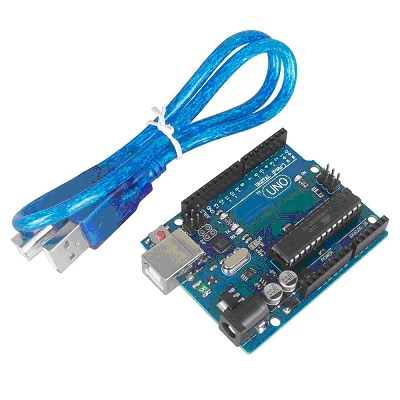

    Arduino Uno

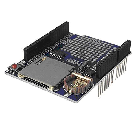

    Data Recorder Shield (SD Card)
    http://www.amazon.com/SODIAL-Recorder-Shield-Logging-Arduino/dp/B00YM2SGR6/ref=sr_1_1?ie=UTF8&qid=1458373024&sr=8-1&keywords=Hot+Data+Recorder+Shield

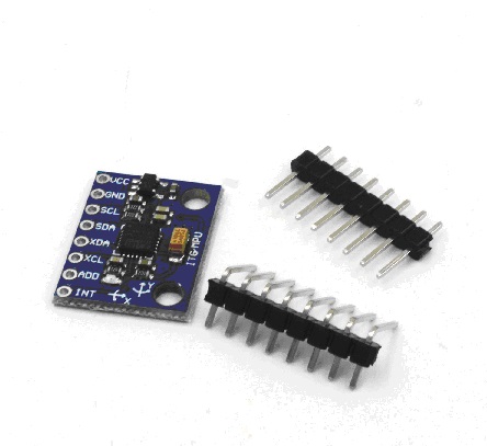

    3 Axis Gyroscope & Accelerometer
    http://www.amazon.com/WYPH-GY-521-MPU-6050-Gyroscope-Accelerometer/dp/B00R5SYRS6/ref=sr_1_6?ie=UTF8&qid=1458373142&sr=8-6&keywords=MPU-6050

    May I ask you a question since you have experience with this stuff. :sos
    Since we don't need live feedback, wouldn't the $5 usd one I link do the job just fine?
    And it should be enough to get all the data we need I believe?

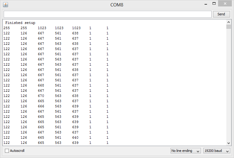

    Easter here so waiting for shops to reopen after the holidays, so I can purchase an sd card shield , I have all the other components plus old app using the 6dofmcu but was a live recorder back to pc, basically a hand held HID that enabled a user to record its movements for making a motion cue to match a movie. Don't think it would take much to turn this into a recorder.
    Also I made one using a Wii nun chuck.
