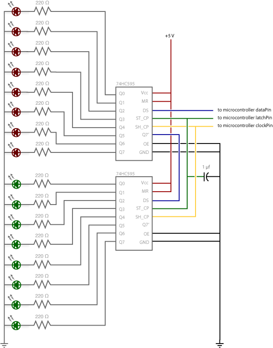

    This is my circuit except I am substituting the greed LEDS for the 7 seg

    only thing i can see is the cap tying latch pin to gnd i dont use it. what is it for?

    Dont use the cap either on my board as for cicuit will need to make one up still. I basically copied the above one and substituted the leds for 7 seg. The pinouts of the 7 seg are easy to configure if you have a datasheet of a 7 seg.

    here is the circuit which I based everything on so far altho there is a fault on it the leds are incorrectly wired or named. The circuit does not work either but the wiring of the outputs to 7 seg are correct and combined with the previous attachment I built my board.
