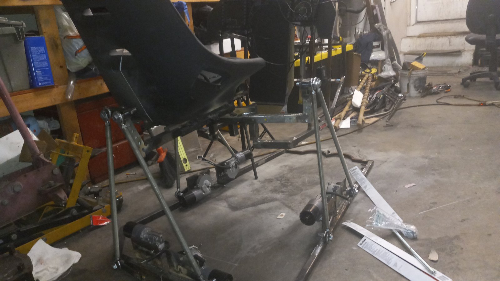

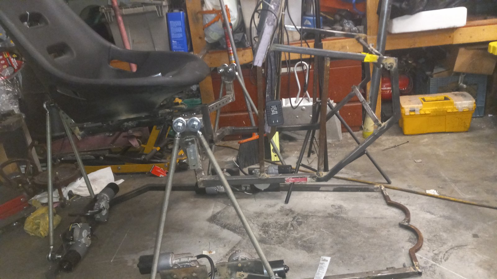

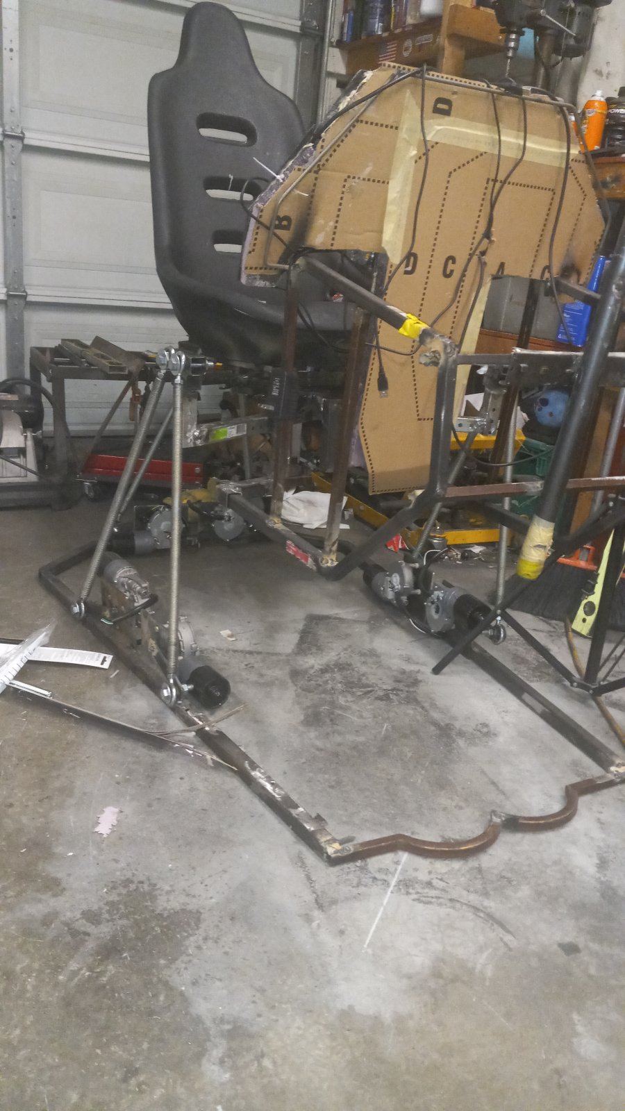

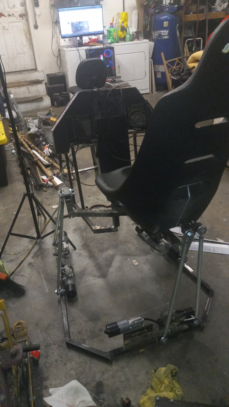

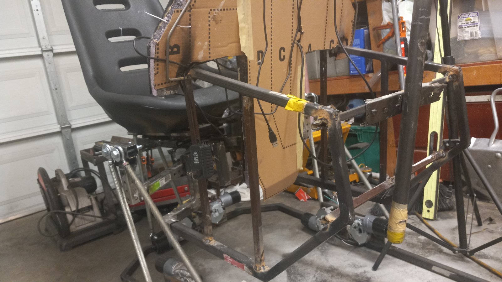

    Hi all. Ok so Im at the stage where Ive got it mocked up enough to maybe start testing the design. I know I should test a little less built but I just had to see it in the air. Ivew been in the garage for a week straight welding my butt off and just had to see it lol. Im gonna be doling 6dof with 2 R3 uno's and 6 Ibt-2's with (temporary) wipewr moters till I can find some dc motors and worm gear reducers under $50 each, thinking maybe 6 12v 350w psu's (again that wont break the bank).
    Anyway does anyone have a suggestion on Arduino controllers like the SMC3 that I should use?
    thank you
    Heres my rig if anyones interested 20220217_230825.jpg 20220217_230810.jpg 20220217_234008.jpg 20220217_234108.jpg 20220217_234253.jpg

    Why don't you stick with SMC3, as it has variants supporting a wide range of controllers, plus a handy visual configuration app?

    Perfect.. ya Ive uploaded it on my arduinos and now im in the middle of wiring and realized I havent nailed down any power supplies or hall effect pots yet.. I found some simple 10k pots around the house but having a hard time finding any psu or 12v batts to test it out lol I really don't expect these motors to do much though to tell you the truth I don't think they're strong enough for as heavy as I've made it. Its not extremely heavy but it's heavy enough that I think these Motors aren't suitable plus they have plastic gears in them I just found out

    If you find out that the motors are weak a bit, try decreasing their crank arm maybe it'll help.

    You mean shorten them a bit? Do you think they are a little long? I didnt know how long to make them
    21,511
    150,686Coins
    +11,018 / 55 / -2
    At a guess try about 40mm from the shaft to a hole, and see how that goes.

    Try addind 2 holes for each arm and start by the minimum length. If it feels good try the next one.
