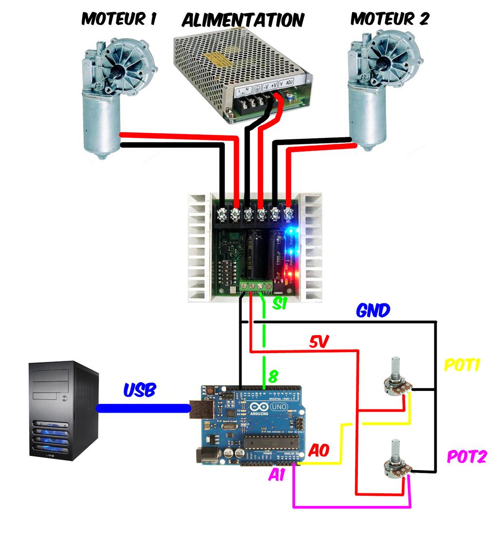

    Now my thinks are ready to start.
    But how i must connect the Arduino with my Sabertooth?
    Is this sheme correectly?
    Must i have the potis?????
    I dont have any one :/
    I can still do it to make it work???

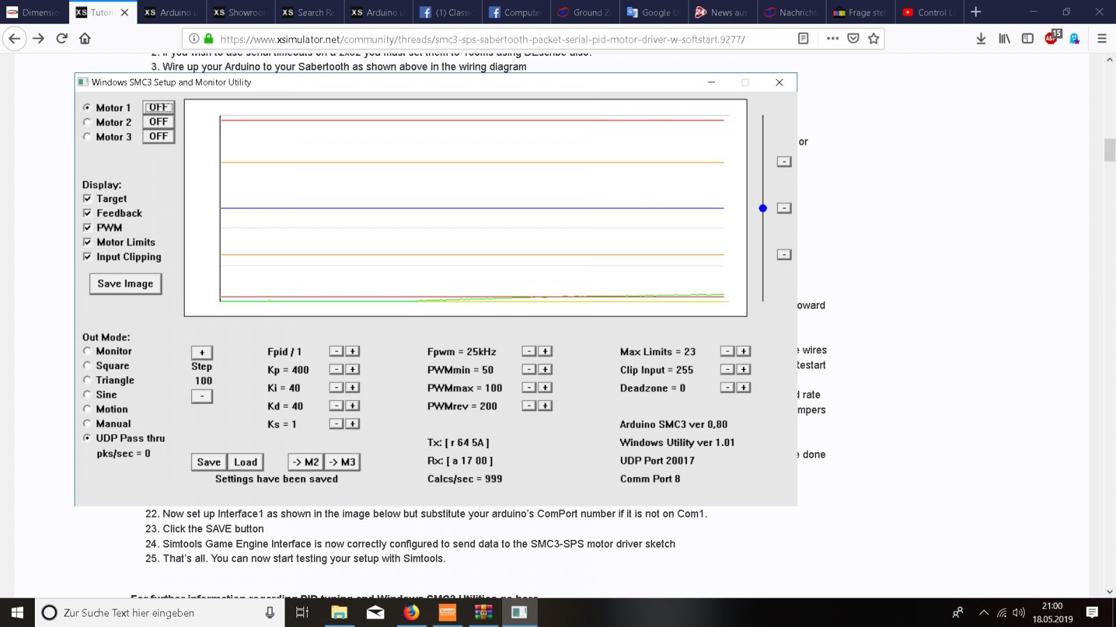

    oh man i need your help again.....
    Now i have every thing do like you say it.
    Now when i`m use the SMC3 Setup and Monitor utility i can use the Motor buttons :(
    They are every time on the OFF mode i can klick to on but thhere is nothing its going directly to OFF not to on....
    I cant understand it
  4. BlazinH
    BlazinH Well-Known Member
    Oct 19, 2013
    2,145
    Oklahoma City, USA
    16,677Coins
    +1,839 / 32 / -1
    The feedback must be within set range for a motor to stay on so you need to adjust the pot on each motor. The green line in utilities should be in the middle when a motors shaft is in its middle or center position. Once working if a motor runs to one end and smc3 shuts off the motor then you probably just need to swap the power leads on the motor because its likely running backwards.
  5. dope-walker
    dope-walker New Member
    May 6, 2019
    26
    240Coins
    +3 / 1 / -0
    oh maaaaan,
    yes that makes sense with the potiometer.
    but there are so many different .... which do I need?
