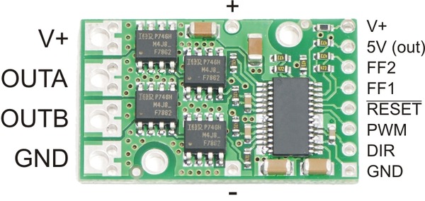

    1 PWMpin & 1 DIRpin H-bridge board
    I've purchase H-bridge board to drive my motors in 24V but as you can see, there is 1 pin for pwm and 1 pin for direction!!
    (25$ instead of 80$ for my Motomonster board @sparkfun https://www.sparkfun.com/products/10182 and 12V max).
    Hbrige 1pinDir 1pinPWM.JPG ebay
    (this ebay Hbridge is not good, too trials ended into smoke, choose Pololu instead for example).
    As you can see, there is 1 pin for pwm and 1 pin for direction!!
    -> in this topic you'll find the 2DOF code adapted to 4 DOF and 1 pins Hbridge boards.

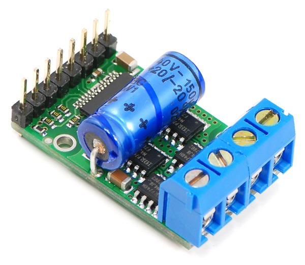

    edit 25 aug :
    successfully tested with Pololu 755 single Hbridge driver boards = but 40 $ per motor ...
    5.5 to 30 V voltage range and is efficient enough to deliver a continuous 15 A without a heat sink.
    http://www.pololu.com/catalog/product/755

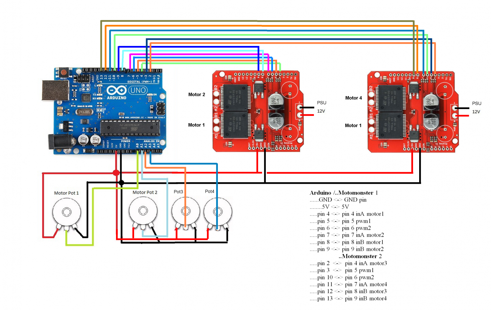

    if you have a 2 pins Dir HBridge (like Sparkfun Motomonster),
    INA1 INB1 PWM1 -> motor #1 OUTA1, OUTB1
    INA2 INB2 PWM2 -> motor #2 OUTA2, OUTB2
    use the original code

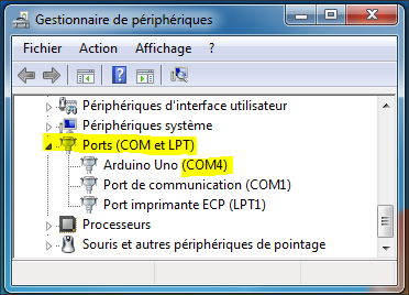

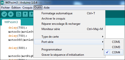

    - install manually the drivers (see the Arduino's specific documentation for Windows Seven installation).
    - After complete installation, find in the Windows system on which COM Port it has been installed : you will need to put this information in SimTools / Interface Settings.

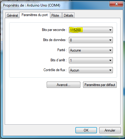

    - Double clic on Arduino's line and adjust the default speed :
    - In the Arduino plateform, put the right COM Port : if not, you won't be able to upload your program into the Arduino...

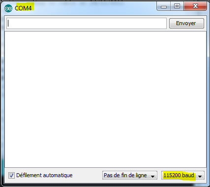

    - Open the Serial Monitor (magnifying lens on top right ).
    - Adjust here as well the same default speed :
    Don't mess within the code ;-) or make everything coherent everywhere

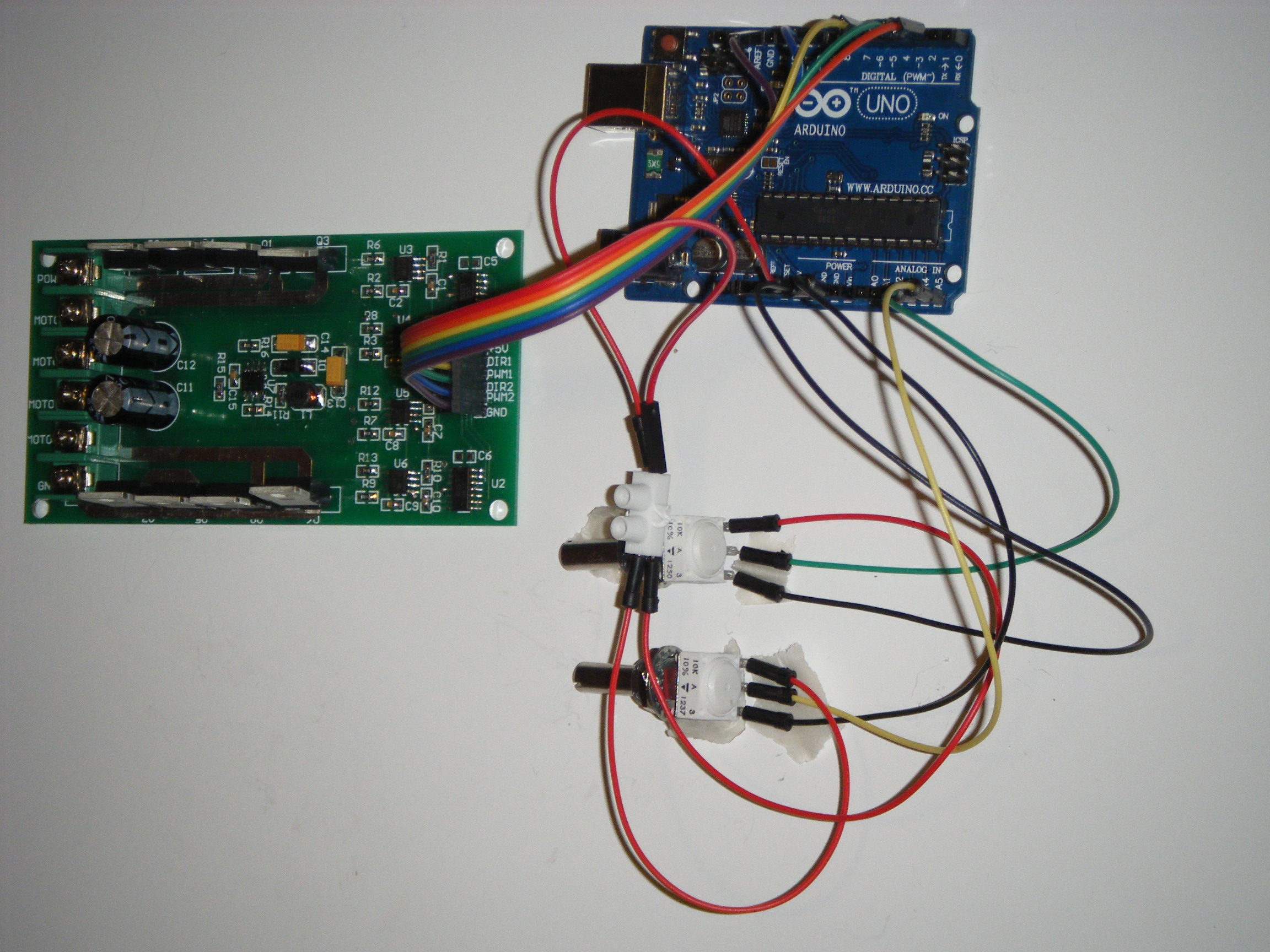

    First hardware tests and WIRING

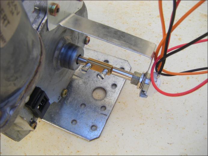

    First : pot are not mounted onto the motor
    you can see the expected behaviour in this video

    simulate the pot mounted onto the motor (back to back or alongside with gears...)
    reduce the speed (pwmMax) to see the direction of motor rotation
    and check if Arduino will behave as expected when you turn the pot
    if your pot is mounted this way :
    when you turn in a direction, motor has to go the opposite way.
    If not, invert motor wiring or pot wiring.
    Warning ! if you have gears between pot and motor, you'll have to twist your mind :eek: to check the correct behaviour.
    Third : mount the pot onto the motor, the behaviour will be the following :

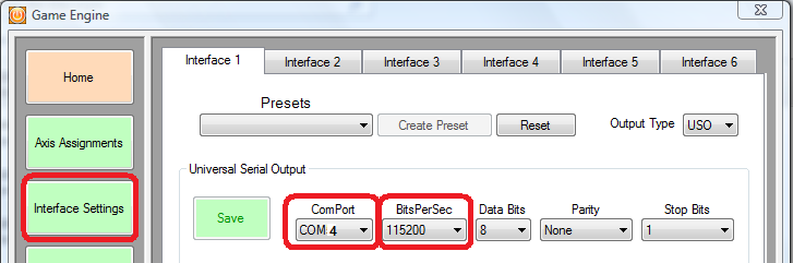

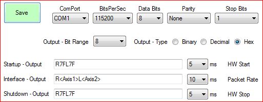

    SimTools Setup
    - In SimTools : set the same ComPort and same Speed
    - my Arduino code needs 8bits Hex data : just setup like this for 1 bridge and 2 motors
    - startup and stop just send the instructions to come to middle
    - and 7F in hex equals 127 in dec

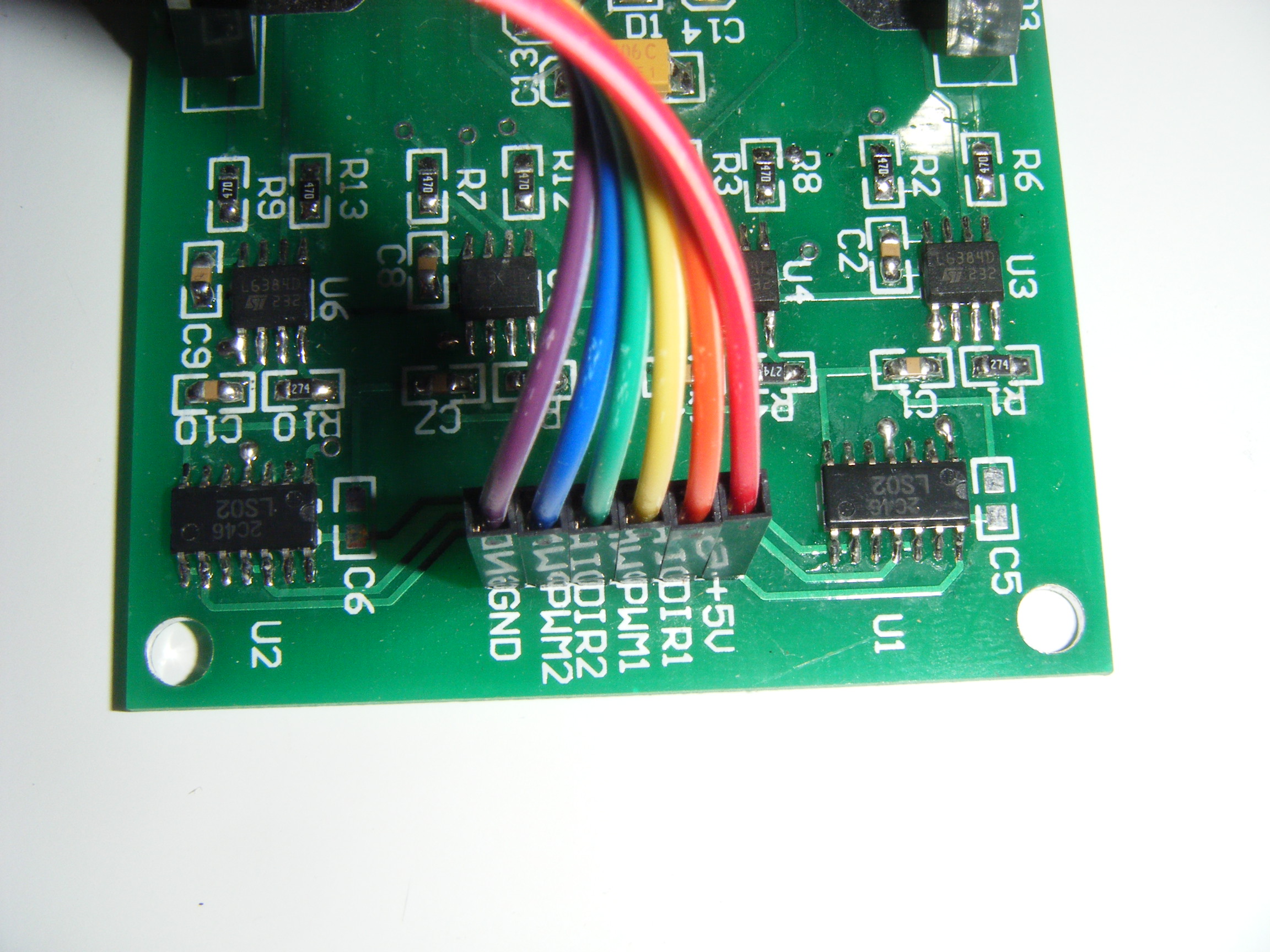

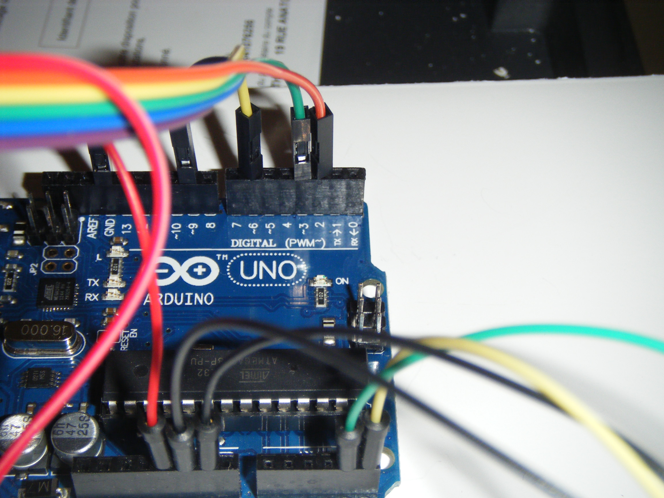

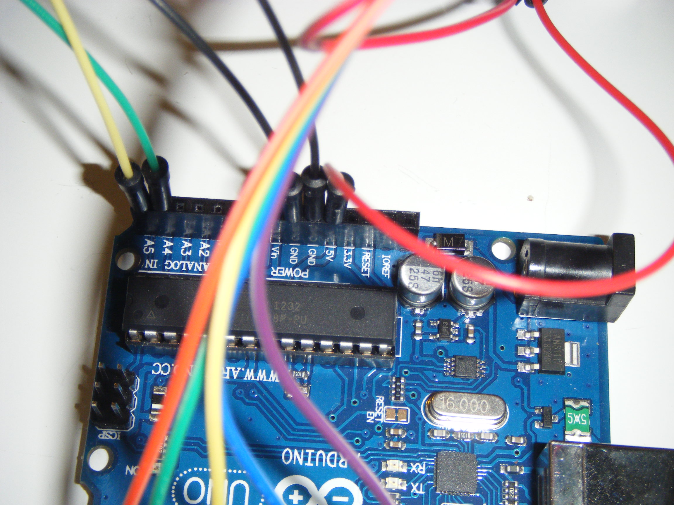

    Wiring Setup
    Here are some high res pictures for plugging !

    With 2 motomonster and 1 arduino UNO or Nano, control 4 motors!!

    Mat, my own Chinese driver boards arrived today (same as yours). I am curious, what are the rest of the commands that you had Simtools send to the arduino?
    Specifically:
    Output range: 8 bits?, Decimal?
    Startup output, Interface output, and Shutdown output?
    Thanks much for working on this.
    I am guessing that Interface-Output would be 1<Axis1>~0<Axis2>~ ?

  12. eaorobbie
    20,506Coins
    +1,687 / 23 / -2
    Ya quick RacingMat , did I get it right. :clap:
    So to answer your question
    Start up centres both axis. R7FL7F - Sim Tools R<7F>L<7F>
    Send packet - Sim Tools R<Axis1>L<Axis2>
    End packet is the same as the start no turning off command , mmm
    [strike]I would tend to use 127 instead of 7F which is equal to 127 but not sure havent taken a close look at his code[/strike].
    Didnt read close enough your using hex output for value
    Correct me if wrong, I haven't plugged a Ard in to test it.
  13. RacingMat
    2,234
    21,094Coins
    you're right ! :thbup:
    if you want to use 4 motors :
    R7FL7FY7FW7F
    R<Axis1>L<Axis2>Y<Axis3>W<Axis4>
    R7FL7FY7FW7F
    if you want to use winds motor :
    R7FL7FY7FW0 (no wind at startup or end !!)
    R7FL7FY7FW0
