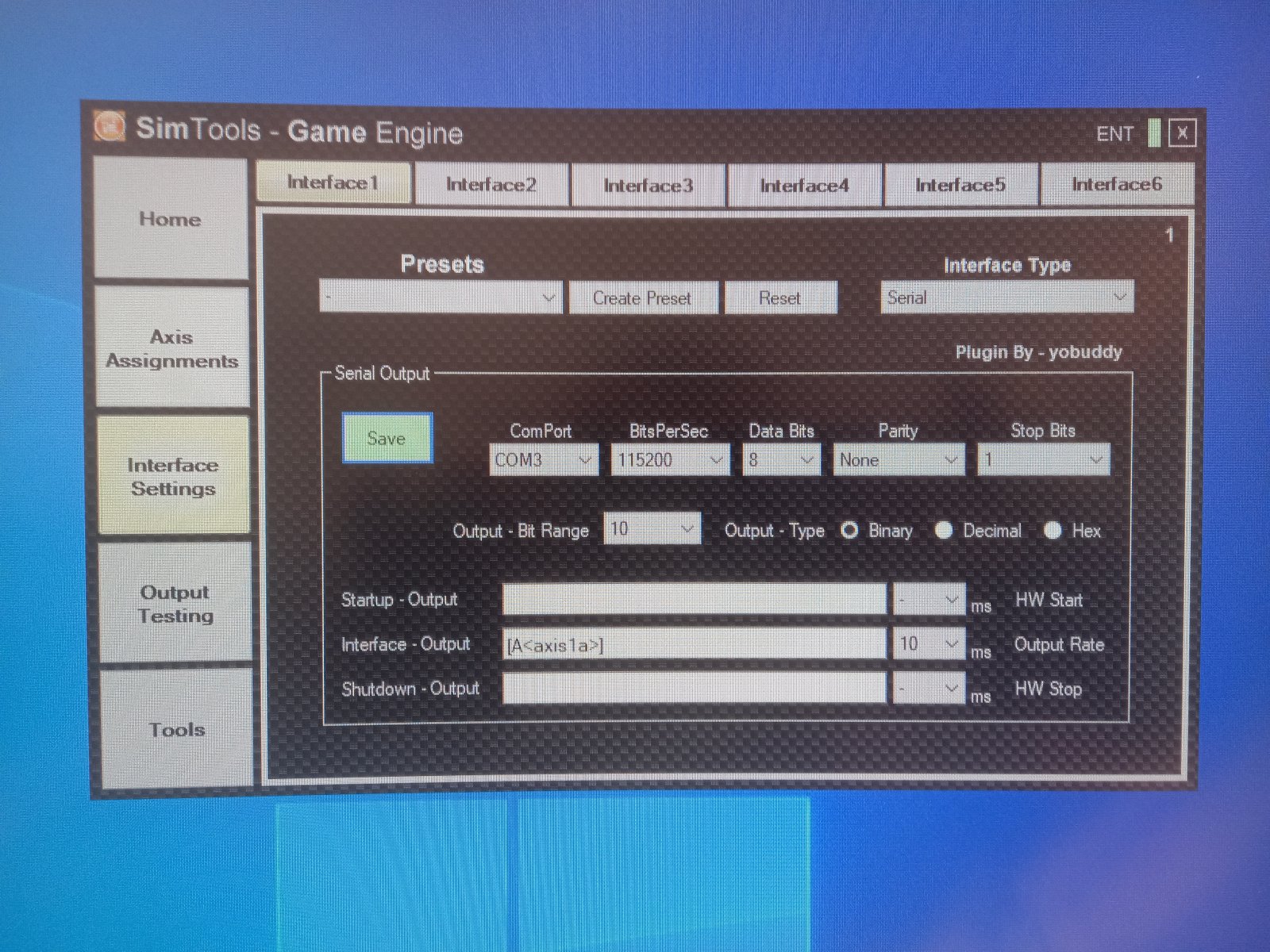

    hi all ,, been a busy start of the year ...im having some issues getting data out of my simtools to my arduino
    when i put output testing off to move sliders my arduino rx led lights up and i get a tone but when i move my slider i get no indication of coms please can anybody suggest of i can resolve this

    What code are you using and can you please post pictures of all of your setting?

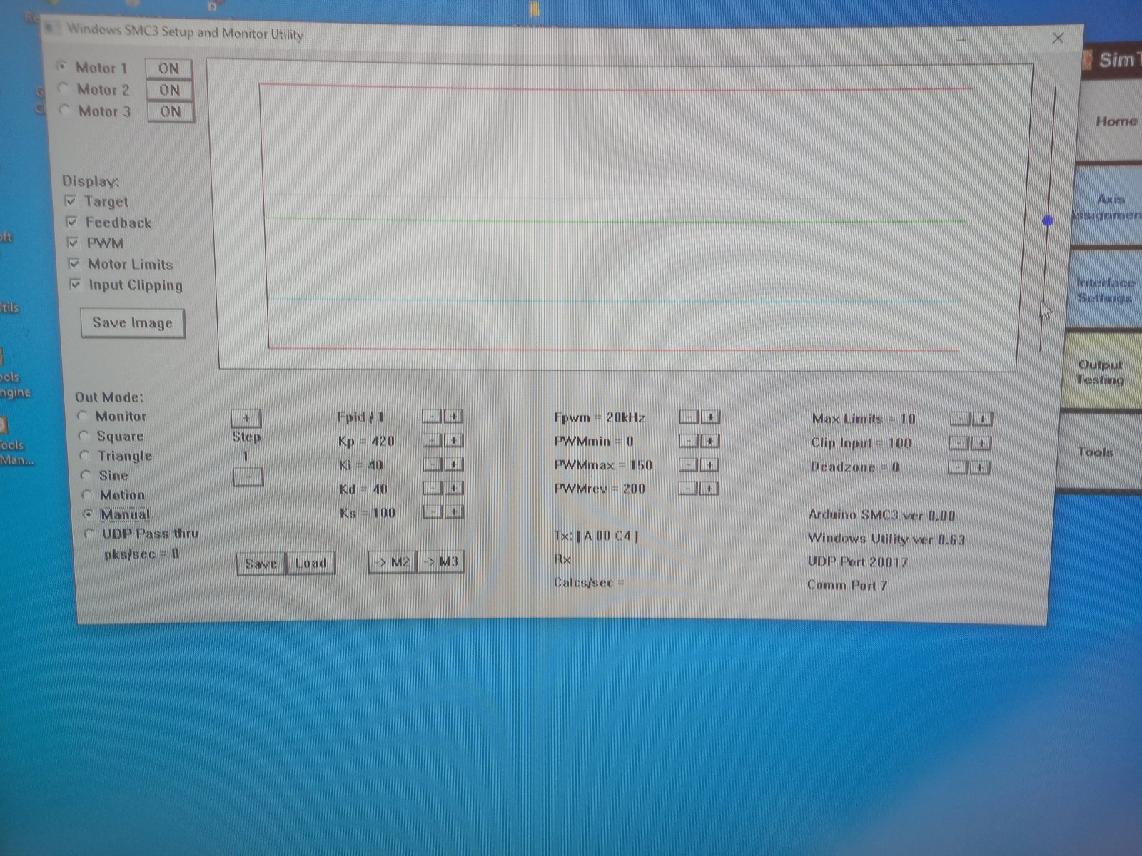

    HI NO
    Hi Noorbeast, I'll post pics in a minute I'm using the smc3 soft start I'll post pic of settings shortly how u been

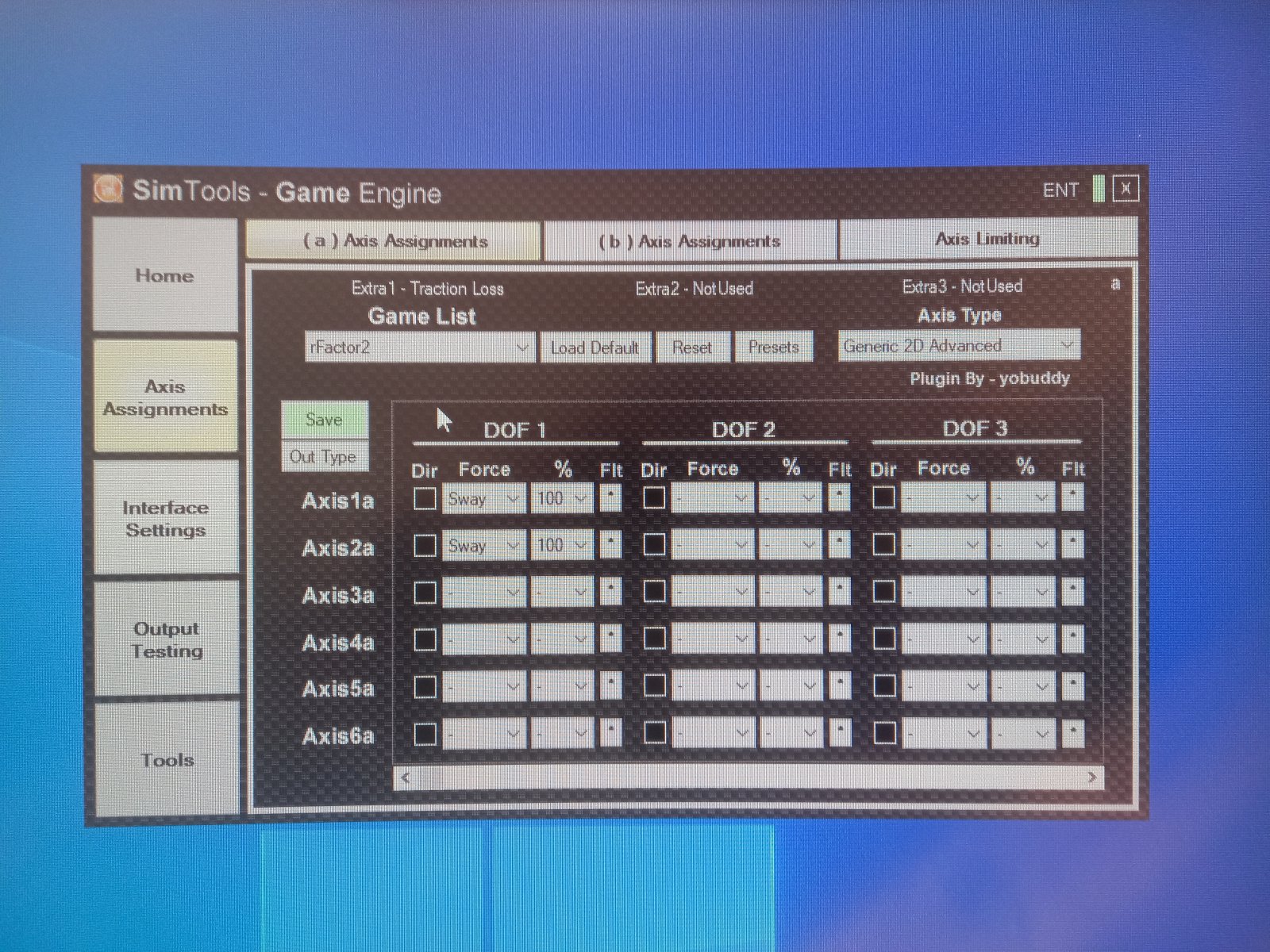

    Try changing BitsPerSec to 500000
    You only have one axis configured in Interface Settings and two in Axis Assignments. Sway would also normally have one DIR checked orange and should lean away from a corner.
    Can you also confirm that SM3 it properly configured and works as expected.

    yes Noorbeast sm3 is working correctly ,,im waiting for a replacement pot for my 2nd axsis ...

    Comm port used for the Arduino is 7 for SMC3, but 3 in SimTools Interface Setting, only one of those can be correct, if SMC3 works as expected change the SimTools Interface settings to Com 7.
    Make sure you do not run SMC3 and SimTools at the same time, it will create a port conflict.

    sorry noorbeast that comport was old arduino i burnt my coms are set to com 8 on simtools and smc3 utility

    It is hard to help if you are not posting your actual settings.
    Can you please start again and post a picture demonstrating SMC3 is working as expected.
    Please post a picture of your actual Interface settings.
    Please post a picture of your actual Default configured Axis Assignments.
    SimTools first needs to respond as expected in Output Settings before messing with any game.
