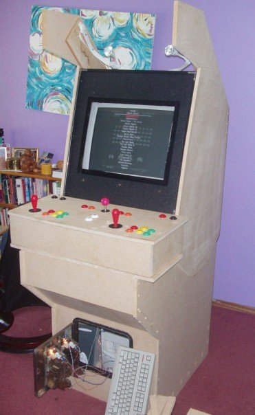

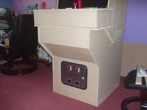

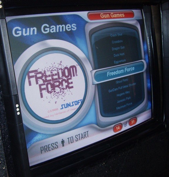

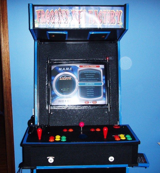

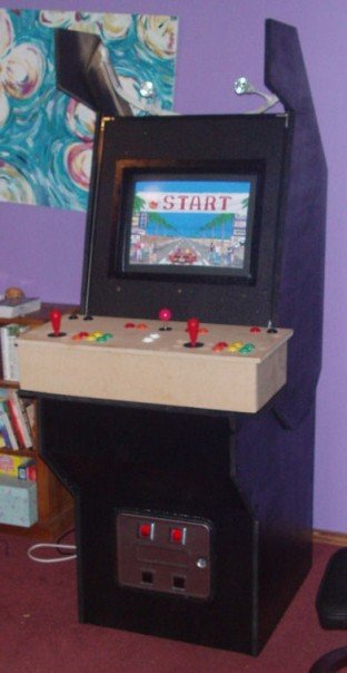

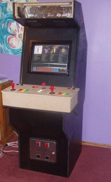

    Been a few people comment or PM me about this MAME cabinet I built, so here is the complete build.
    It's now well over 8 years old this actual build and the PC I put it in it was old then, so it shows you how little you need to run MAME and Sega games! It will also run the PC version of the "House of the Dead" games which is great fun with the light gun.
    Sorry slow internet users, lots of photos and comments :)

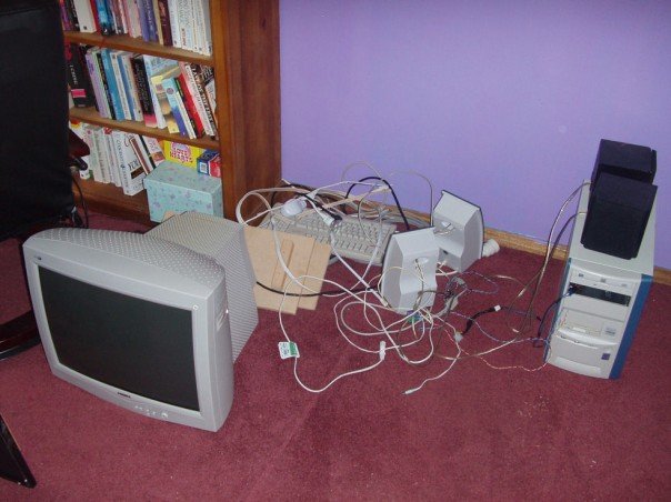

    And so it begins... A jumble of wires and an Idea...
    Inside the Cabinet...

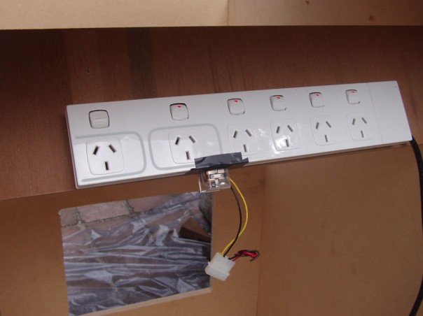

    12v / 240V relay that switches on the Powerboard when the PC is powered on, turning on the Monitor, Amp, lights and Peripherals all at the same time and will power off when the PC does.

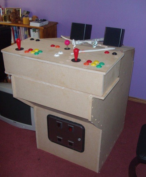

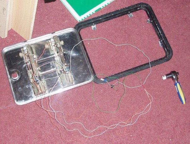

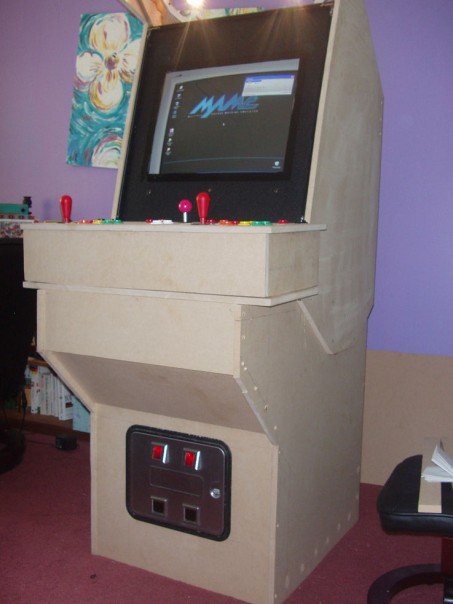

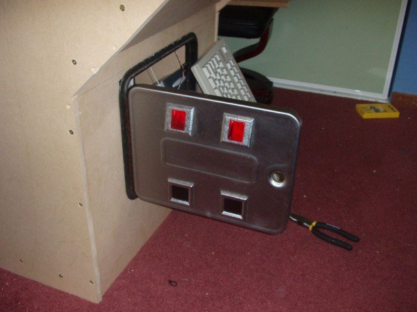

    Working (and lit) coin mechs. If you don't have coins, press the "refund" button and it will give you a credit.
    Closer look...

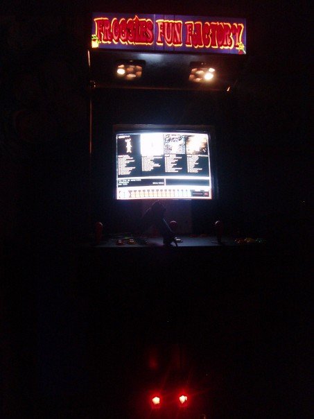

    Lights for the Marquee. 12v "Click" lights.

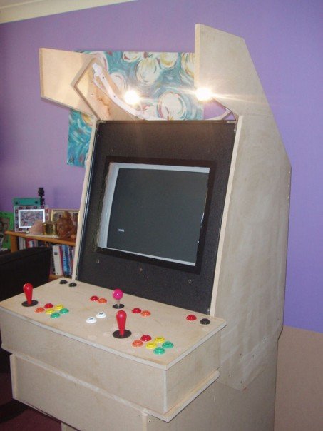

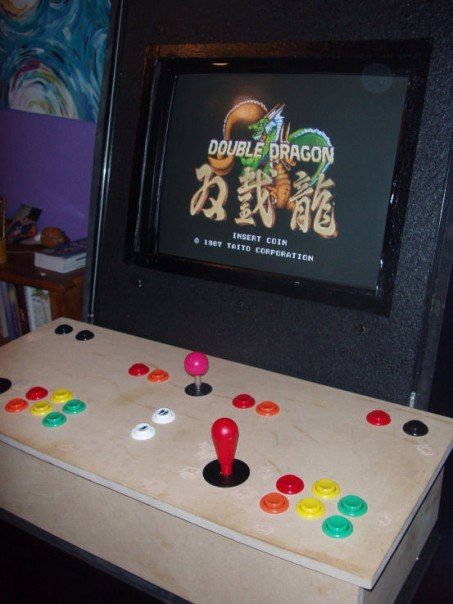

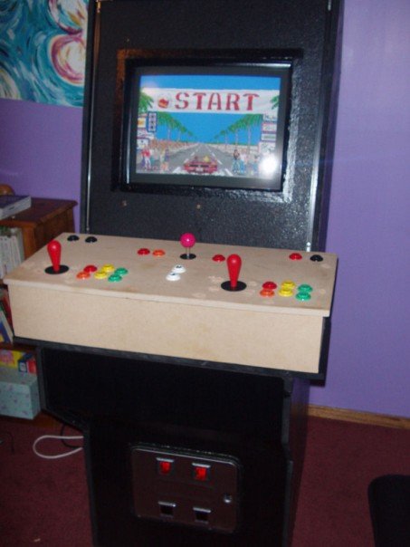

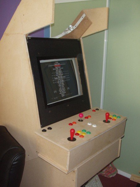

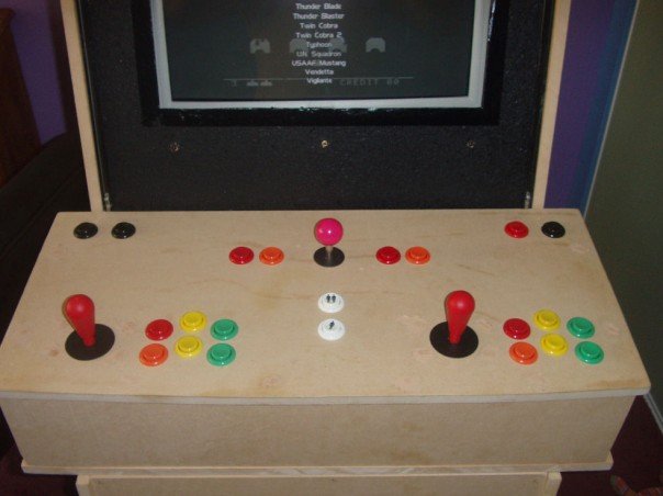

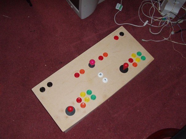

    Control panel Version 1 (No trackball or Gun)

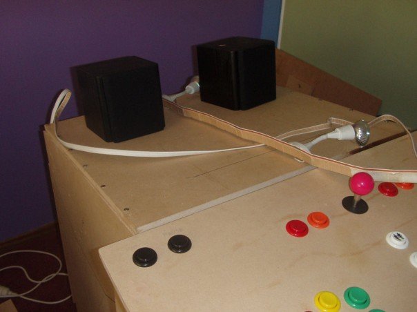

    Speaker Test.
    225345_6424899015_252_n.jpg 224265_6424929015_1749_n.jpg 223365_6424889015_9692_n.jpg

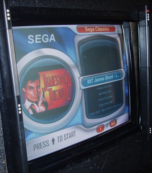

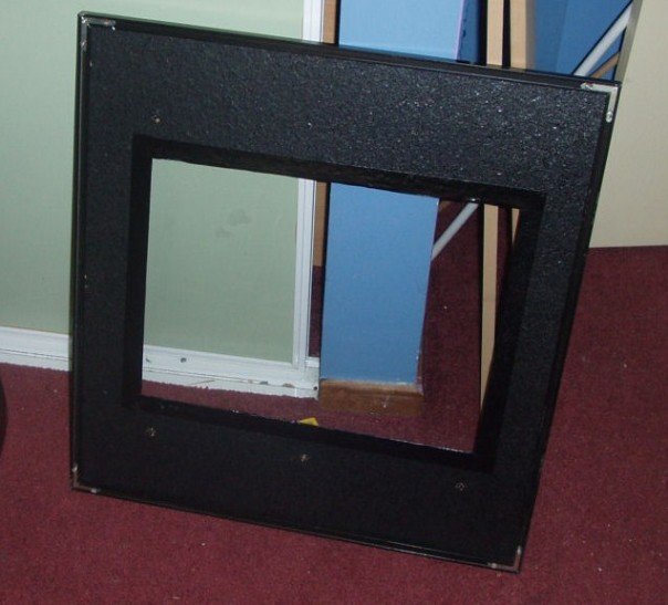

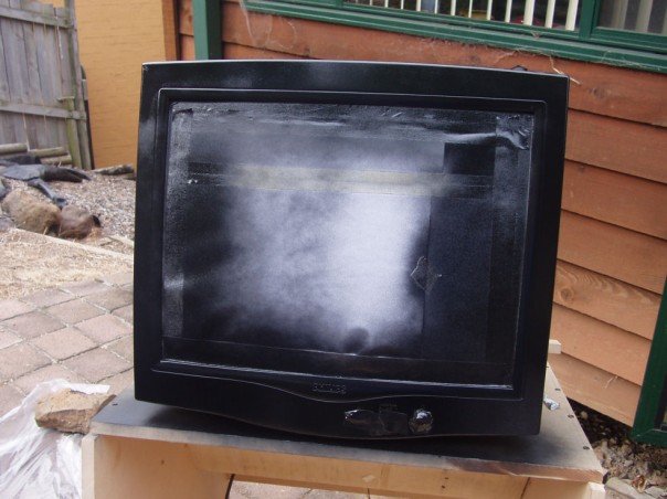

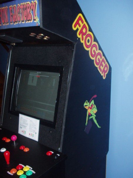

    Front bezel. It's actually a reverse picture frame with the another smaller picture frame screwed to the front, with the back of the first picture frame cut out. This gives the beveled look and saved me having to get glass cut to fit. The glass is bigger than the inner frame, but large enough to cover the 20in CRT I used.

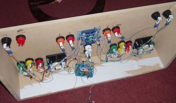

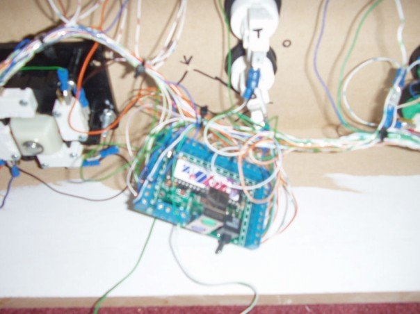

    The rats nest of cabling.... Wiring the joysticks is fun because you have to remember that pushing up on an arcade joystick, clicks the BOTTOM microswitch....
    Wasted my youth on this and Kung Fu Master. HIIII YAH!

    Back of the coin Mechs... All the way from Oldham in England. (Bless you eBay)
    The KeyWiz controller.

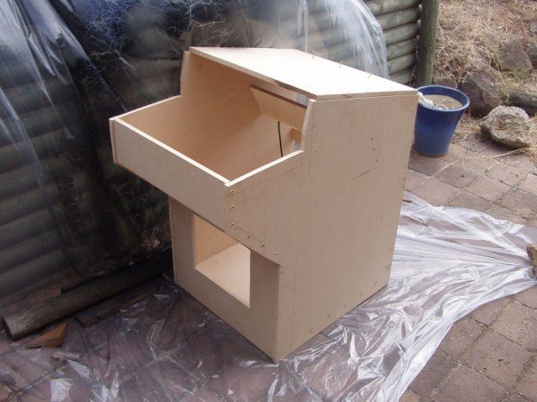

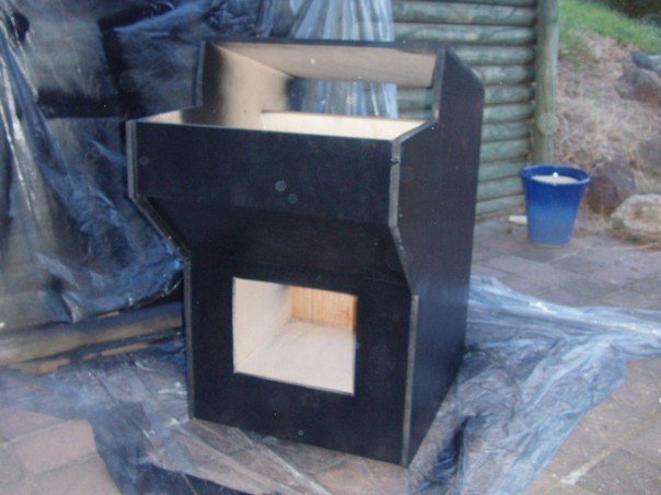

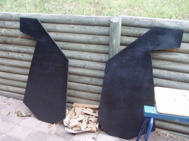

    Side panels getting some paint...

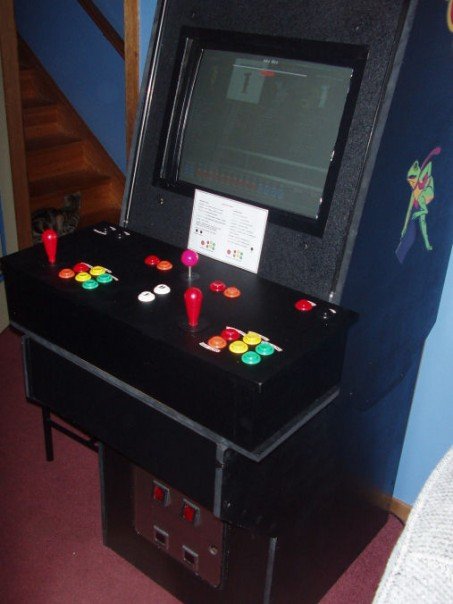

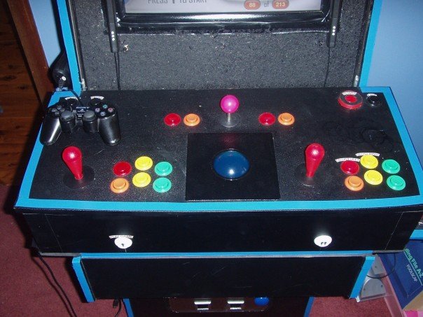

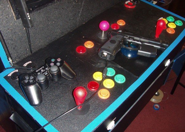

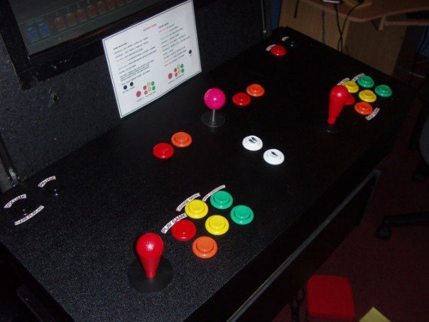

    Updated control panel. Moved P1 and P2 and installed a Trackball.
    Some Vinyls...

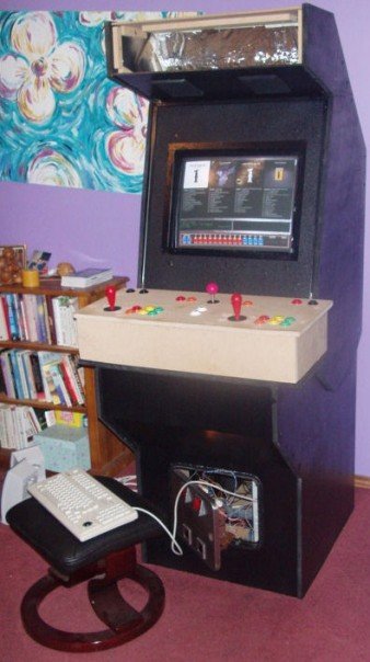

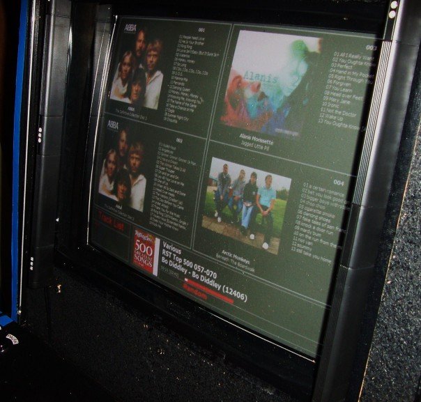

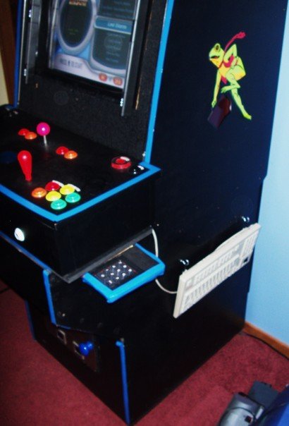

    Keyboard numpad for the Jukebox (Gives that Pub feel :) )
    LCD TopGun Gun. Has Recoil!!!

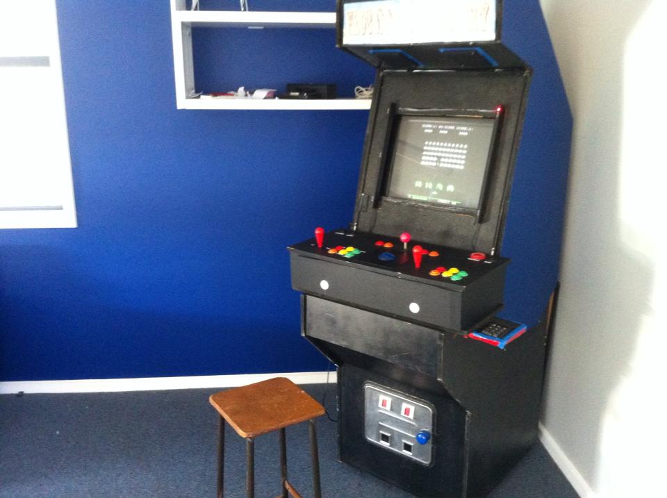

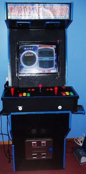

    Final resting place at my works... Will dismantle soon as we are moving offices and will likely convert to a cocktail size.... Full size cab is just way too big... I tend to build big... Can't do small!!
