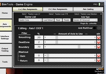

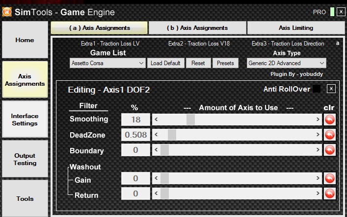

    Been tweaking forever now but the sim will just spike out even at 20-25% smoothing.
    If you guys dont mind posting some screens of the SMC3 And the axis setup and filters for your id be must grateful.
    Thanks!

    Yep. Doing all my testing in asetto corsa (and checking in rfactor2 to make sure) making minor changes. It's somewhat random. It can happen in a crash or when I just drive 40kmh. Suppose the latter could be an error in the track though. Surge seems to be the worst offender. Its just odd with such high filters and even dz of 3. All usb Chords have ferrite magnets. It also happens on my bottom motors that only has heave on them, though not as often.

    Could you please post pictures of all of your settings, and if possible a video of the seat in action which also includes the game screen at the same time.

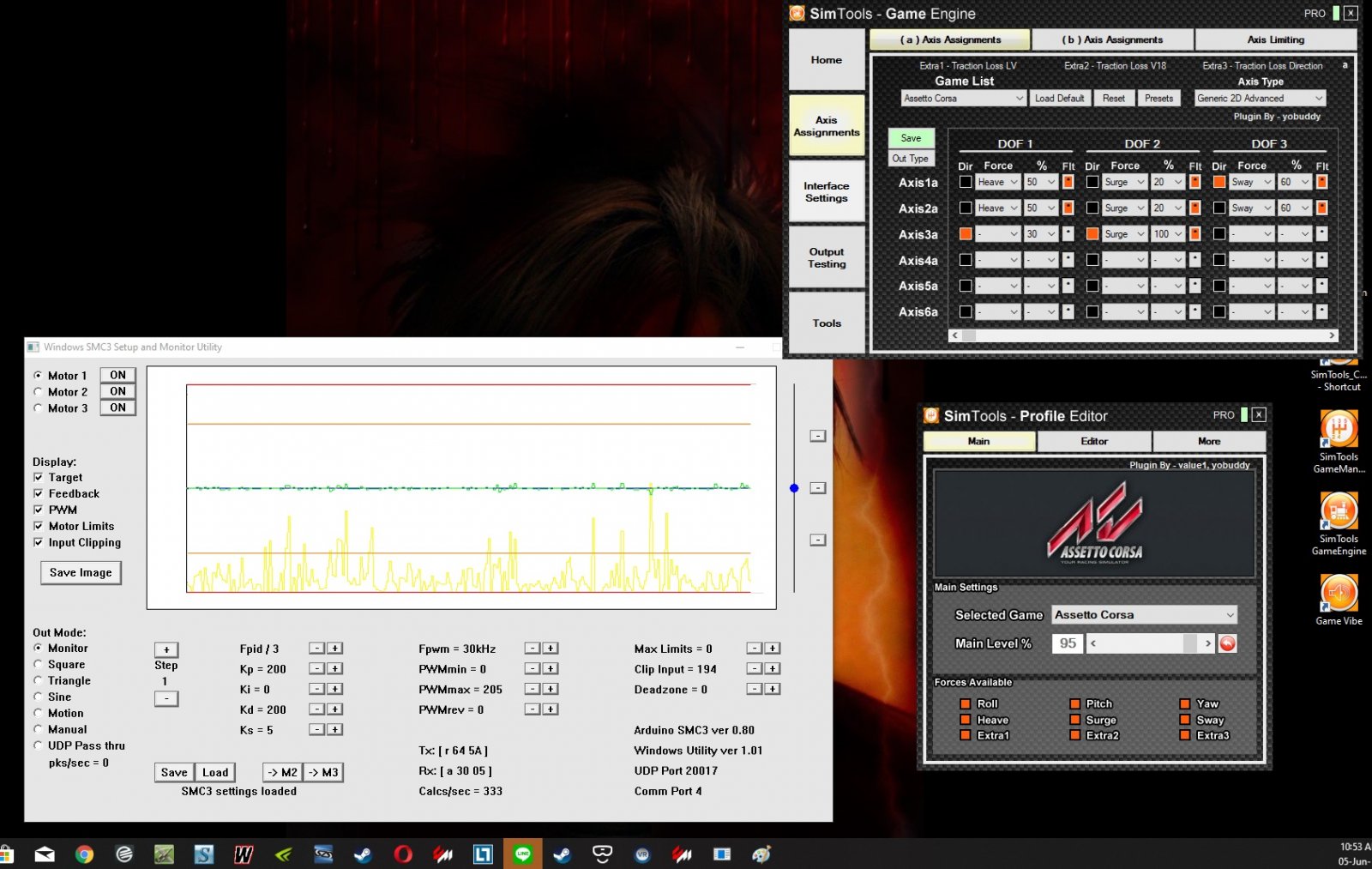

    Made a video in AC driving around nordschleife
    In this video at around 1:33 you can see the back just stops working. in reality this is at the end of the lap but the video is cut down. There's hardly anything going on.
    On my previous lap the right motor started to oscillate fast aprox 5 mins in when just taking a slack turn. The video got corrupted so i dont have it. The settings were the same.
    Axis are more than 100% combine but they have a boundary. Setting under 100% combined makes no difference. Bottom motors have much less but same thing happens but not as often.
    Previous:
    Bottom motors: Project cars 2 in the pitlane riding out. Trying to hold a motor position but suddenly stops working. One flap can stop working for no reason on slow or fast driving but they are more stable than the back.
    I have not used KD at all before but the symptoms are the same as with any setting ive tried.
    PS this was supposed to be a settings comparisons post not troubleshoot so see this post for other settings and reference. https://www.xsimulator.net/communit...ion-stops-working-mid-game.13338/#post-178385

    Looks as though a board or PSU is tripping out.

    Update.
    Ive been playing around with the KD on 200 and KS at 6 and it can usually keep going for 10-15 minutes now @sebring in RF2 with the AI driving. . It has however been sitting at idle with the sway axis about 80% up and the noise on the hall sensor (due to the KD, noise gets worse with higher numbers) caused it to start oscillate hard. Its much more common for the axis to start to oscilate, sometimes slow, sometimes very rapid. I suppose that could be a PSU issue.
    Im using 2 Meanwell 40 amp 400w psu's. 2 motors each trough 2 sabertooths 2x32 with aprox 10-13 amp peak load on each. These are set to send voltage over 13v to the resistor packs. Honestly though i do not trust the electricity where i live to be pure so i cant say for sure that its not that.

    Another update.
    Using the curve generator tool and looking at the graph on sabertooth im not sure if the PSU is actually capable of providing the continues power that is needed. The reason for this is that the motors slows down and speeds back up again on a 200ms sine. I dont see any spikes on the graphs when it does fail but i dont think it can be anything else at this point due to the somewhat random nature.

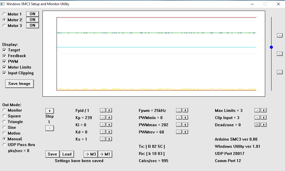

  10. SeatTime
    28,370Coins
    +2,844 / 38 / -0
    Fi. As posted before in a similar thread, I have basically the same setup driver wise. Your Feedback/PWM is very noisy. Here is mine - all powered up:

    Thanks that was probably my other thread. Like mentioned this wasn't supposed to be troubleshoot so excuse the double.
    It's something I'm looking at. I've added some ferrite magnets and still waiting on shielded wire. Potentiometer signal is 80% noise when off free but the honeywell hall sensors has the same amount of noise when everything is powered down and on usb power so it dont appear to be affected by any outside source that i can see. I tested the signal with using the 5v from the sabertooth before and it has the same noise. Also when not close to a magnet. Im also getting the same noise when i connect it to my laptop. Could it be a grounding issue? It's leaving me rather puzzled.

  13. SeatTime
    28,370Coins
    +2,844 / 38 / -0
    Don't know, but a PWM signal that active when your system is supposedly at rest cannot be a good thing.
