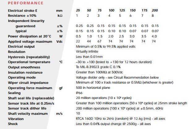

    I am slowly piecing together parts for my seat mover motion rig.
    Today at work I was chatting with our chief mechanical design engineer trying to pick his brains for any improvements in my design. He's an amazing talent who's been around forever and pointed out a few things and really got into the whole 'simulator' concept.
    An hour later he comes up to me with a couple of these linear displacement sensors that are used in various motorsports for datalogging suspension movement which are surplus to our needs (used on an older design). :)
    They are a 5K potentiometer with 125mm stroke with a guaranteed +/- 0.15% linearity, a maximum shaft velocity of 10m/s and life expectancy of 200 million cycles.
    On paper, they seem like the perfect thing for a motion rig but was wondering if anyone has use such a beast on their rig?
    Is tracking linear position of the seat 'push rods' better or worse than gearbox motor rotation (ie hall pot)?
    What advantages or disadvantages are there with each type of pot (ie. linear Vs rotational)?
    Cheers
    Paul

    I think there should be an advantage using linear sensors with a rotational actuator because they will measure the non-linearity of the movement. A pot attached to a motor shaft appears to have linear movement even though it isn't. A pot would require an algorithm to accurately measure non-linear movement.
    Edit: That is assuming levers are being used.

    is it a "Linear Variable Differential Transformer"?
    in this case, it is a top quality, >100$ piece of equipement
    which would suit perfectly for simulator use

    Our design engineer said they cost 'a couple of grand each'... Sounds a little high to me but we're a defense company and we never seem to buy anything cheap :)
    @SilentChill - I will be running the Motion Dynamic motors with 60mm CTC levers so figured these 125mm sensors would be sufficient. What stroke are you running?
