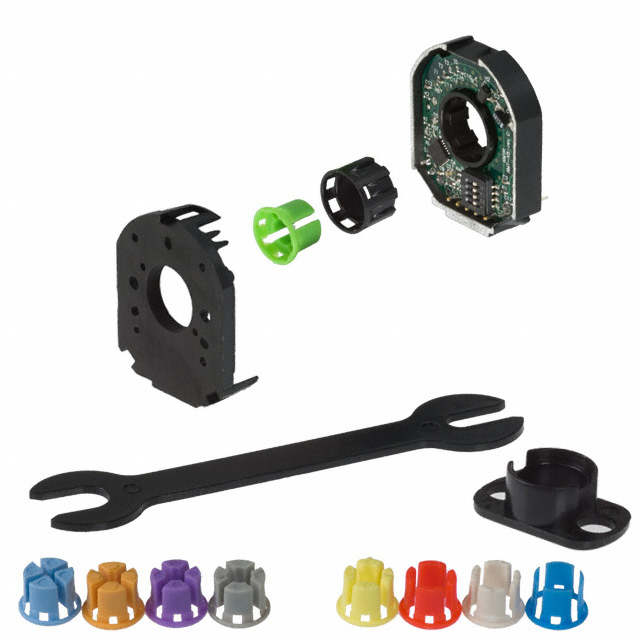

    Have modified a couple of my motors the accept these encoders AMT 103 kit
    less than £16.00 each + £3.00 for connecting cable
    dip switches for setting pulse counts, adapters to fit various diameter shafts, alignment tools for installation.
    Working ok on a test bed, with homing switch on output shaft
    regards Terry

    Looks like a nice product. Here is a video..unfortunately I do not speak German but I get the point. Nice idea for the shaft connection. Would love to see a picture of your homing switch set up. The Kangaroo provides for limit switch inputs and also has a connection for a "index" or homing position.

    Looks like the AMT103 has the index output "Z" ?
    http://datasheet.octopart.com/M313X0001-CUI-datasheet-15696199.pdf
