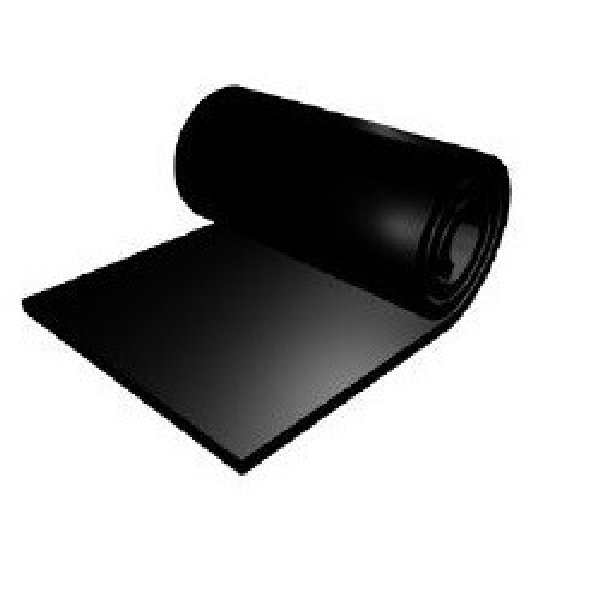

    Neoprene and a type of rubber used to make silent blocks and also sold in roll format with various sizes I own use roll. Sorry my English but I am using google translator

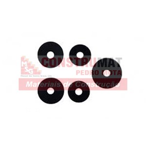

    283Coins
    Simple neoprene shopping in roll format and cut the monitor bracket format. The neoprene will oxilar it makes sinobloco effect and so and avoiding the vibration caused by the wheel .simples you can always use these seals used in hoses wc also make the same effect
