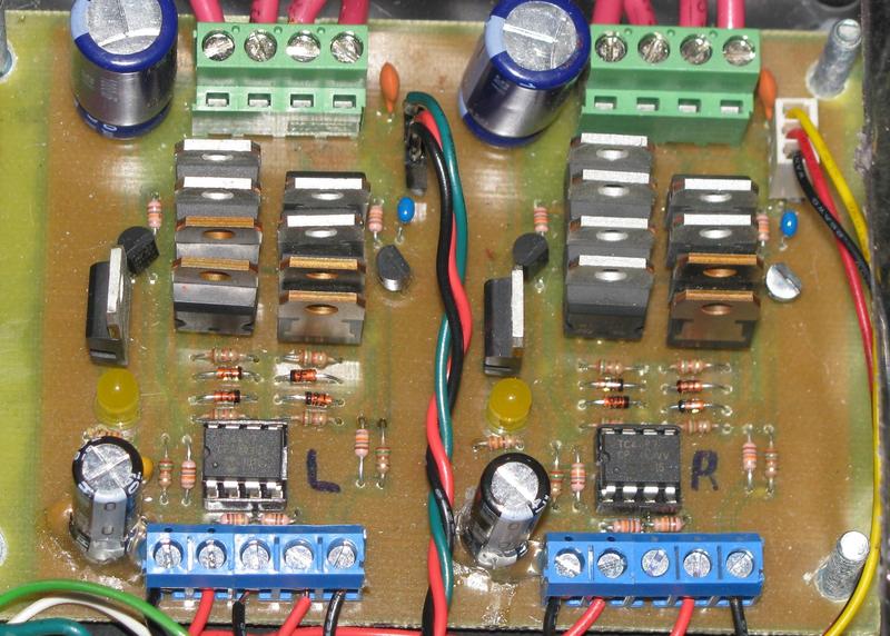

    Hello @prilad @speedy and other electronic experts!
    Could you please tell me what do you think about this Hbridge?
    This motor-driver is an H-bridge circuit that was designed to drive a single DC motor at up to 30amps at 24vdc. It incorporates a simple design utilizing parallel mosfets to allow a higher amperage rating and requires 4 wires to control each bridge, 2 digital and 2 PWM capable.
    (ultrasonic PWM frequencies possible (32kHz tested))
    http://prototyperobotics.com/projects/2x4-h-bridge
    Is it nicely designed for our purpose? Does it look cheap or expensive?

    you are best off with BTS7960B boards that are on ebay for 11€ per drive ... 27V and 47A ...
