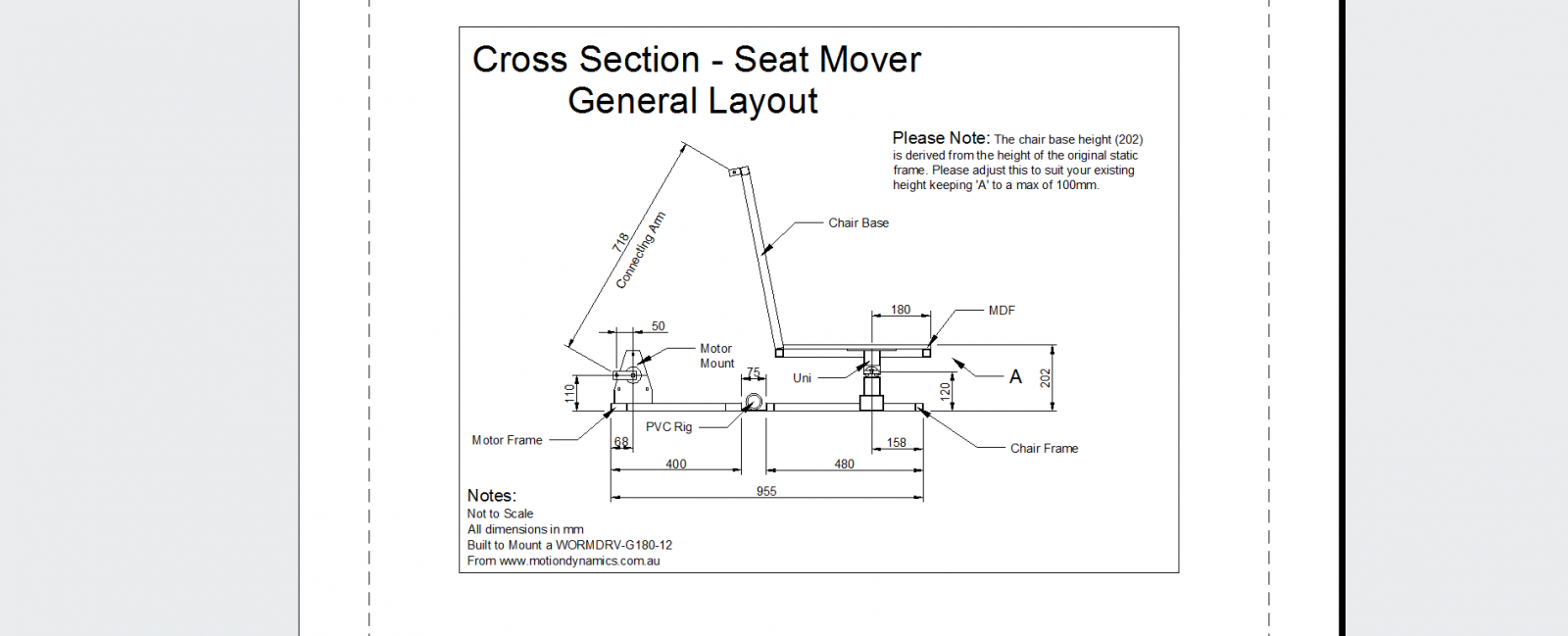

    Near has a full set.

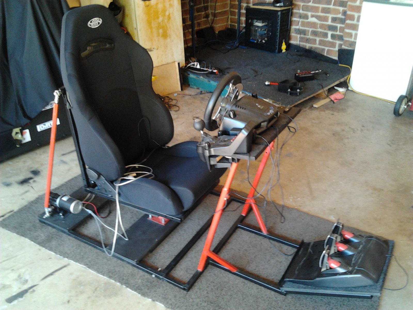

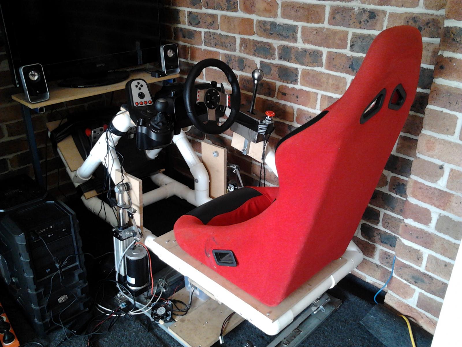

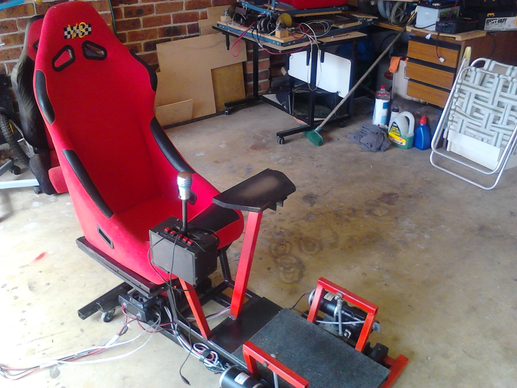

  13. bsft
    seat mover/shaker , yes with SCNs or in our case , DC motors and JRKS.
    Also Archies foot motor sim designed off my build for ages ago.
    Heres the foot motor

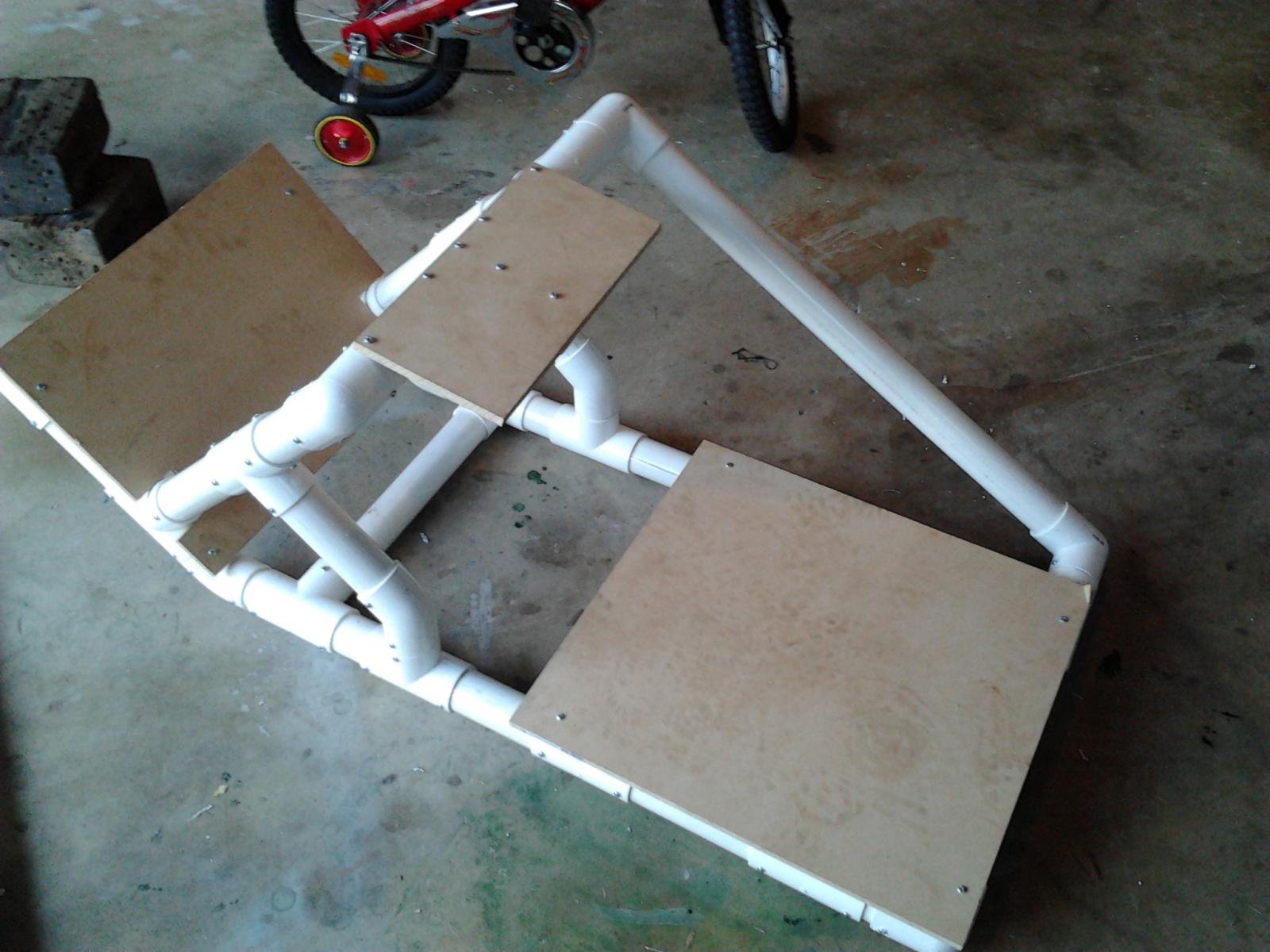

    Or a PVC full frame could be an option as well, the one pictured has actuators, but DC motors will do fine.
    I also sent you a PM
    Cheers, David.
