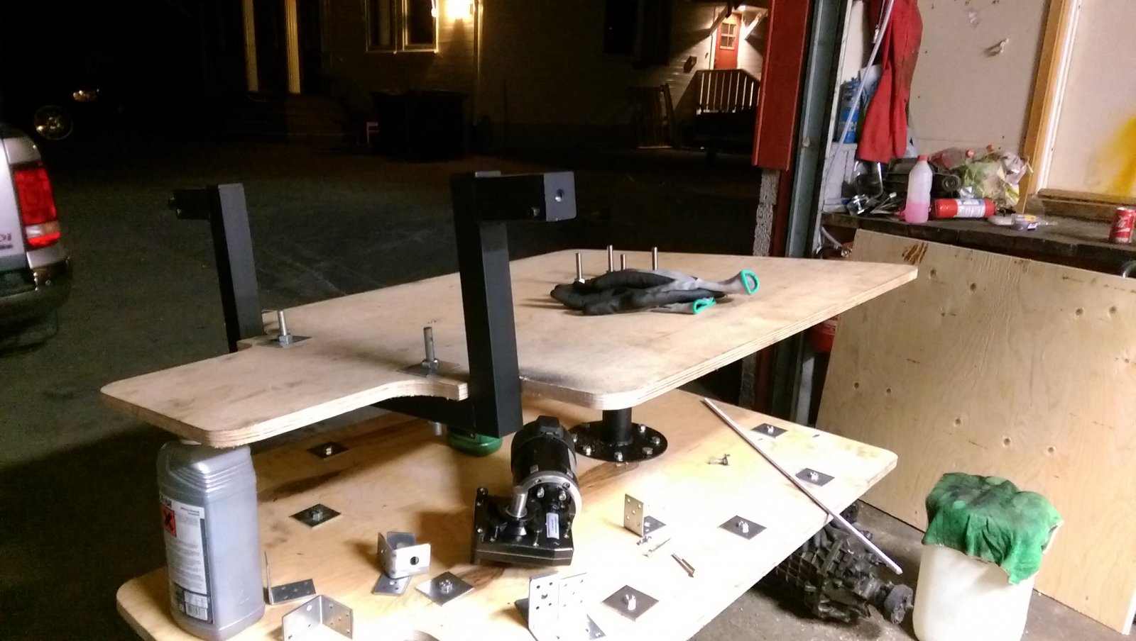

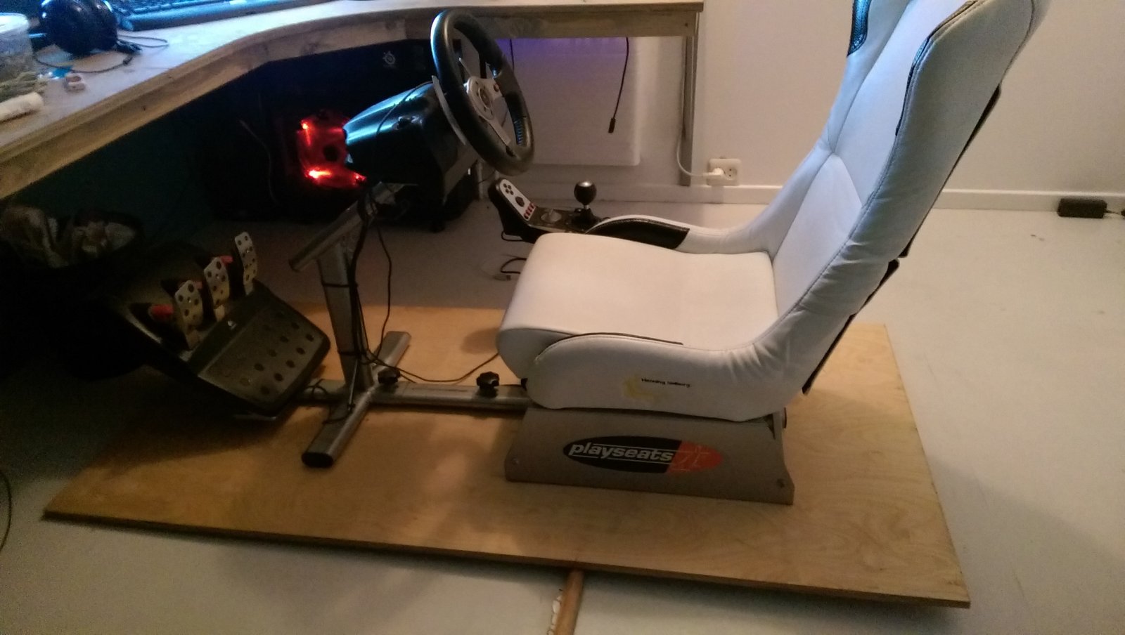

    I will build a 2DoF first, and later convert it to 3DoF
    The motors will connect to the front and not up high on the back of the seat. (space issues in the room)

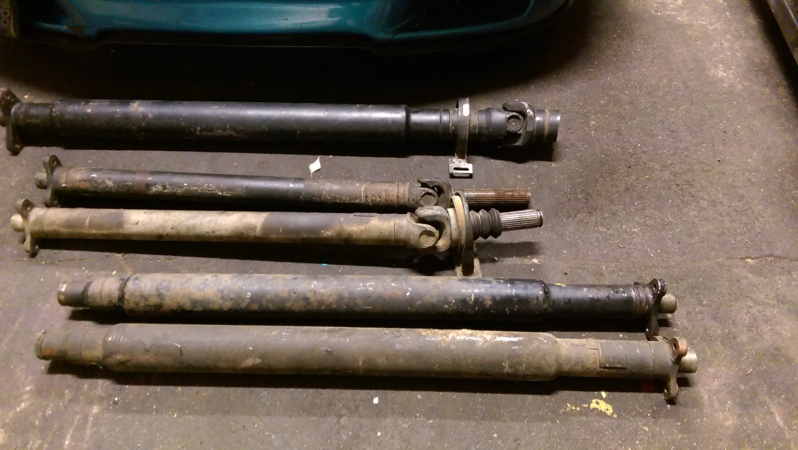

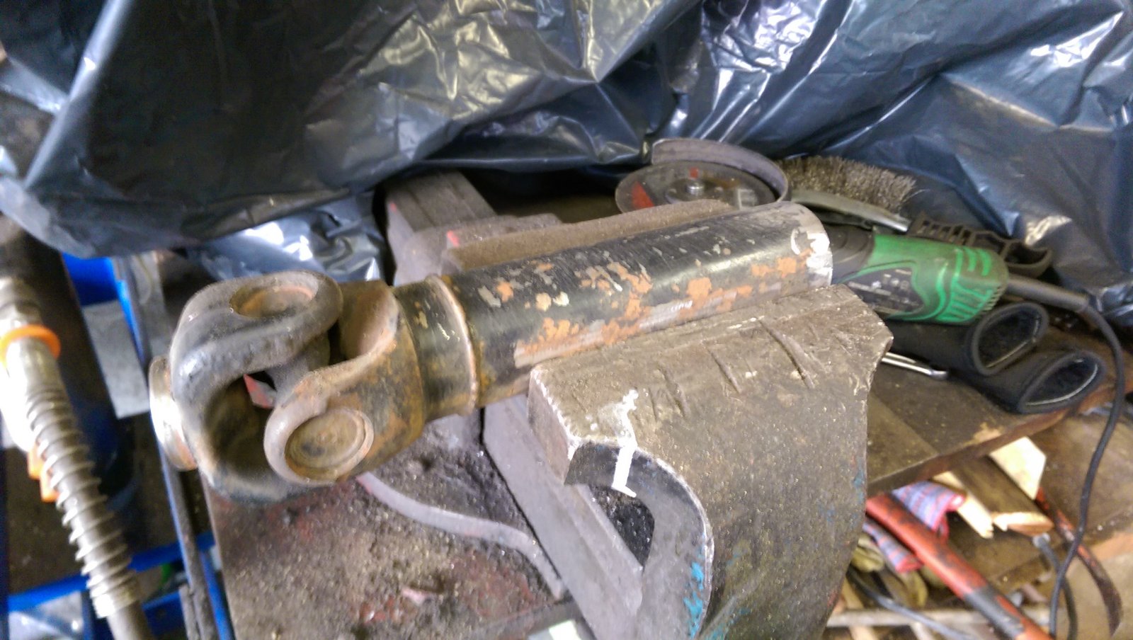

    I've started the build, and used some leftover parts from my drift car.
    Pictures says it all basicly...

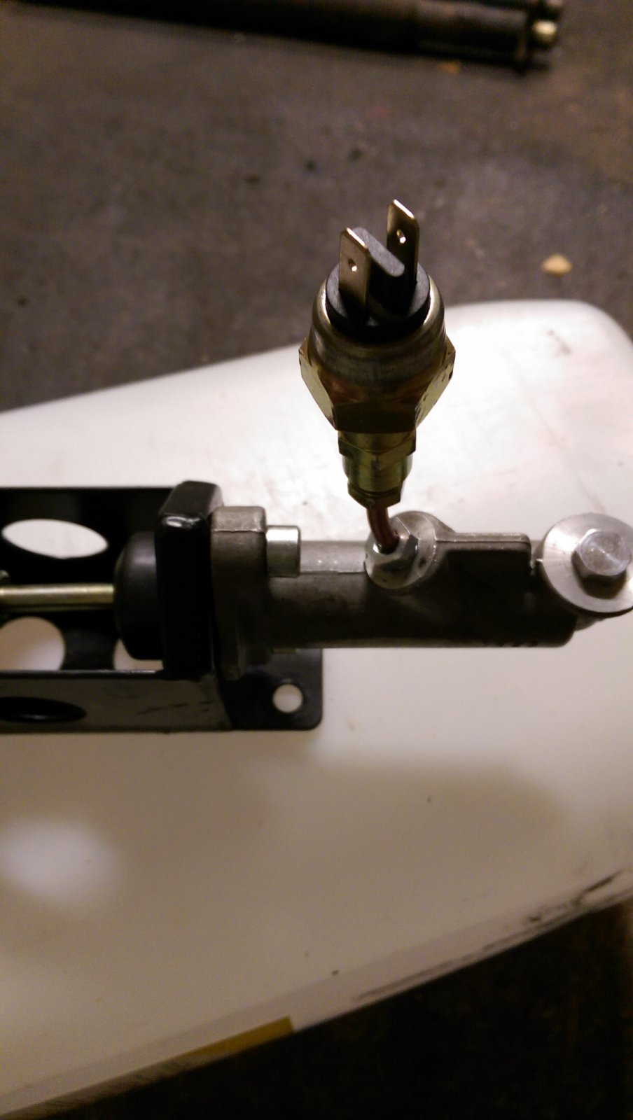

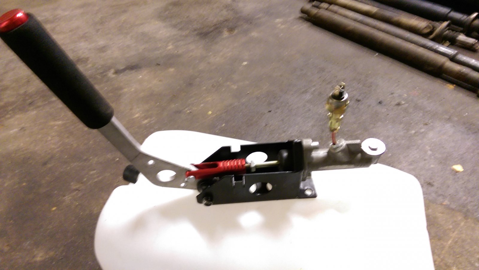

    I have converted my old hydraulic handbrake to be modded on the sim, by using a pressure switch from a motorcycle that will be soldered into one of the buttons on my G25.

    Should the motors be positioned any specific distance from the pivot point?
    Should they be at a 45 degree angle to allow for the same movement in all directions?
    More questions will certainly rise, but at this stage I think that is what I am currently uncertain about.

    Anyhow, this is how the hydraulic brake looks now, I might mod it a little more to allow for some more feel, right now there is nothing to "flex" so it feels like a "button" , no feel, just on / off.
    I might add a lenght off copper tubing and leave some air in the tube (not bleed it) to allow for some compression of the air to take place before it reaches the pressure that is needed to activate the switch.

    Thanks for the extensive background to your project.
    You obviously have a design in mind and it pays to post that, even if it is just a photo of a hand drawn plan. That gives members a good idea of what you mean and in some cases they will point out things you may not yet have thought of.
    There is no specific distance that motors are placed from the pivot point, that is a matter of the design criteria, but the greater the distance the more the leverage effect that is possible.
    Angling the motors is possible but not necessary as a good motion profile allows for mixing movement between axis and forces. Other design factors have more significant effects, as @Archie notes here, but even then a good motion profile will play to the strengths of a particular design and minimise its weaknesses: http://www.xsimulator.net/community...owered-by-12v-electric-jacks.7601/#post-90783
    For the Oculus Rift is pays to aim for fast and precise motion rather than slower large axis movements.

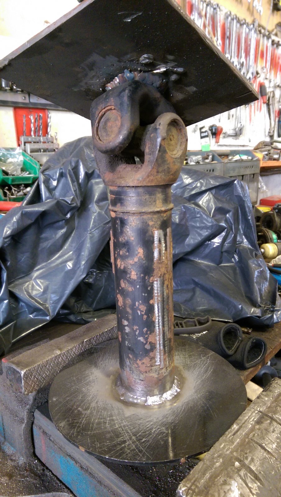

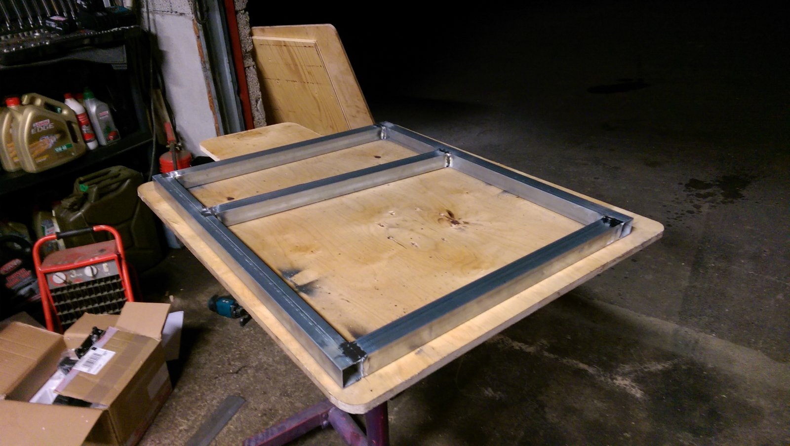

    The quick and dirty description is that I will use the frame already built
    The shaft joint is at the balance point with the playseat on top.
    The motors will be in the front, and am planning on welding a bar to get the connecting points higher up, approximately at the height of where the knees are, that should be pretty close to the center of mass/roll point.
    I might modify later so that the shaft joint get closer to the bottom of the seat, the way the Playseat will sit on top off this frame gives about 20cm between the joint and the bottom of the seat. But I will try this first.
    I will keep that in mind (regarding the Oculus Rift's) and build it for small, quick movements. I will make a lever with multiple holes so that I can easily change from 40-60 mm.

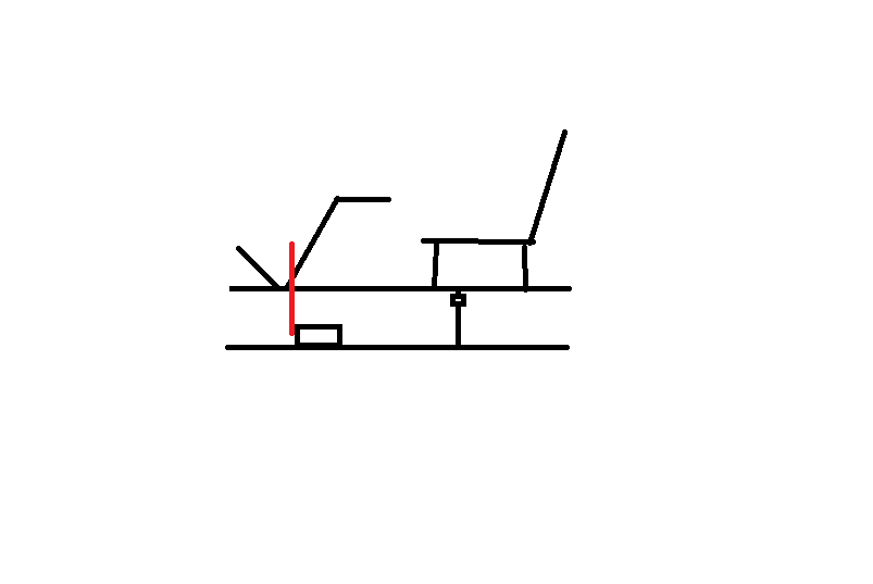

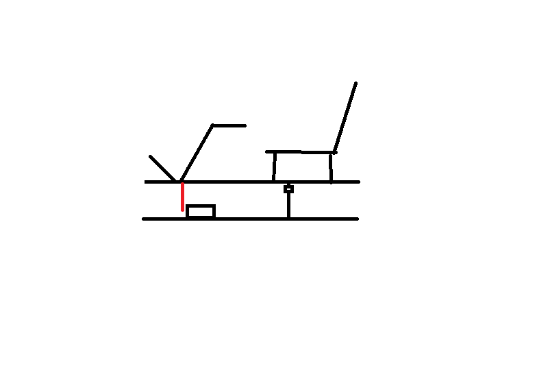

    Regarding the height of where one connects the motors, does it play a big role if they are mounted below the roll center?
    Like this:
    instead of higher up like this:
    21,511
    150,686Coins
    +11,018 / 55 / -2
    Mount the connecting point higher up, as per the second picture. It will put less strain on the motors.

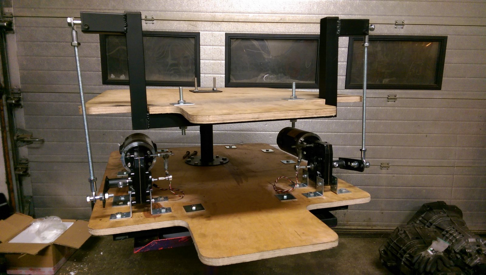

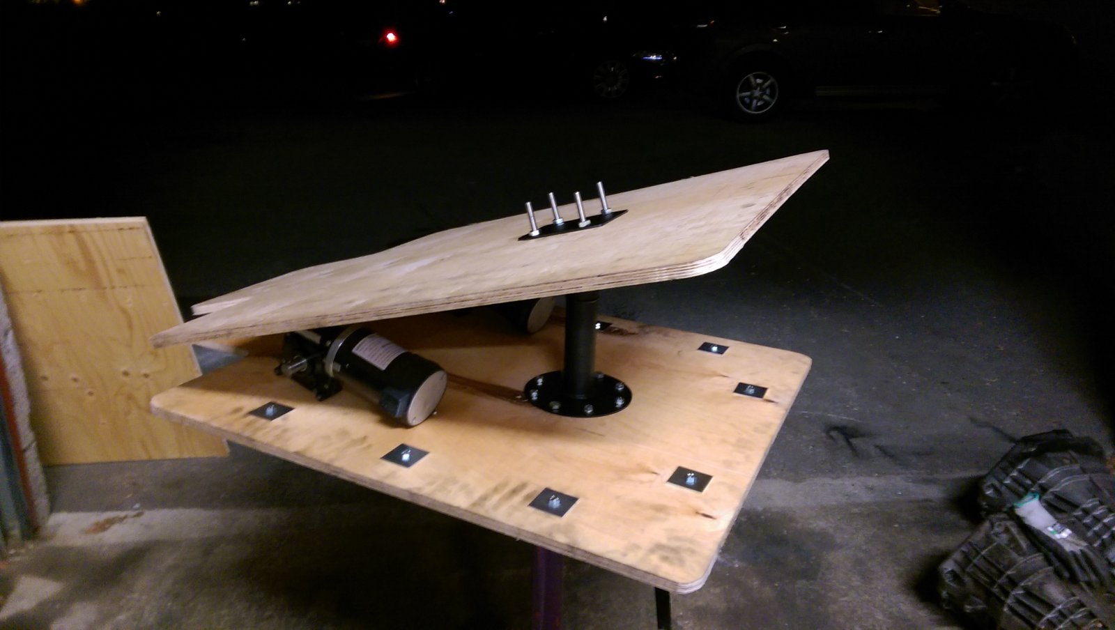

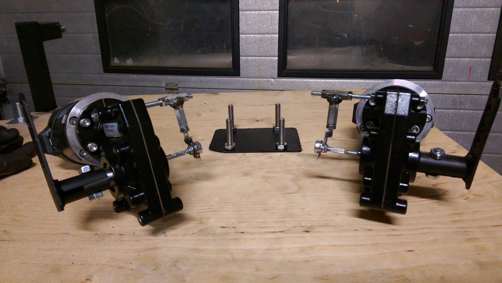

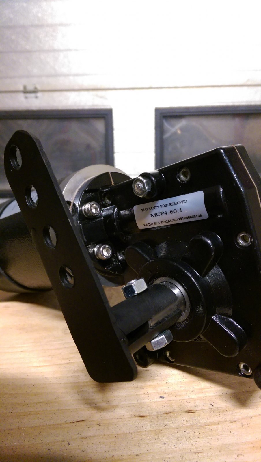

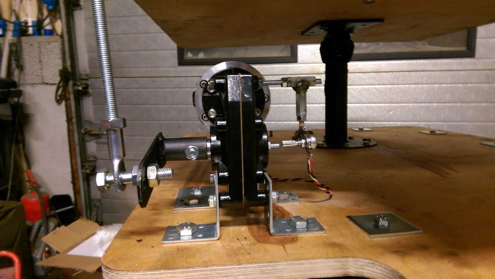

    It took a little longer than expected to fabricate these parts :)
    So I didnt manage to finalize construction yesterday, but pretty close now. Hopefully I will be done with the building tonight and can start to install the electronics.

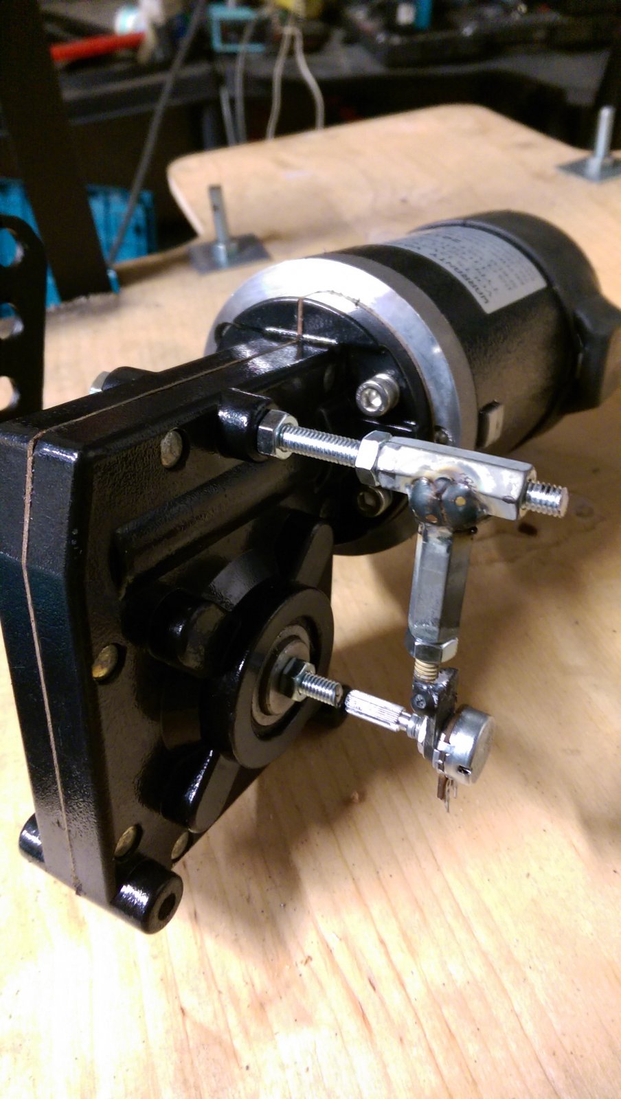

    I welded the strut to move the connecting point higher
    Then I drilled and tapped the rear of the motor shaft to M6 (for the pots) and built the connector shafts.
    I drilled holes at 40, 60, 80 and 100mm ctc to allow for testing. When I first drilled the 40mm ctc I felt that would not create enough movement, but guess I'll see when I fire it up.
    The tap in the motor shaft for the pots did not become 100% centered, so I am afraid that might give me some problems down the road. To connect the pots to the bolt I am planning on just using heat shrink tubing, that should be stiff enough to not flex much, but pick up the minor variations that might occour..

    Anyhow - I will be using cheap pot's , but was think about changing to Hall effect pots. I know the 6127V1A180L.5FS is good, but I cannot find them on ebay.
    Does anyone know of a good pot for our JRK's that is available on ebay? ....

    The connecting points are now aprox. 30 cm from the bottom of the chair, hopefully pretty close to the roll center.
    To mount my pots I welded together som M6 bits'n'pieces, pictures says more than a thousand words. Alot of adjustment possibilities
    The lever I welded from a tube with ID of 16mm, so had to split it up, but it is solid now:
    That was as far as I got last night because all of the sudden one of my switches decided to stop working and my internet died, which is not so good as I got a "smart house", and with no internet, no lights ;)
  12. Nick Moxley
    17,056Coins
    +2,506 / 30 / -2
    Very Interesting idea for the pot mount. Good job Bud. One thing i noticed tho. the lever's themselves look to be on the thinner side for material thickness. I would keep an eye on those for flex in the initial testing.

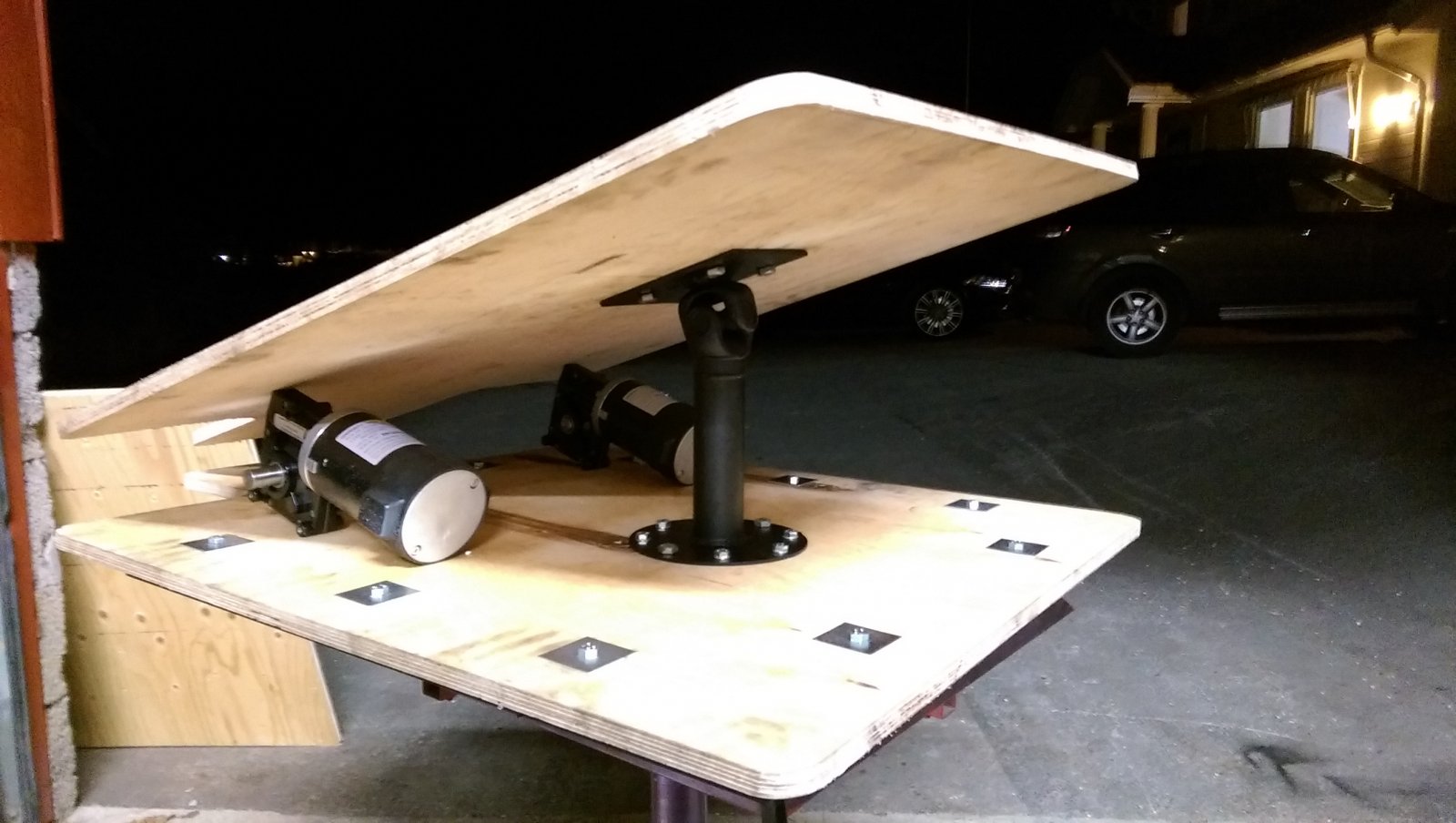

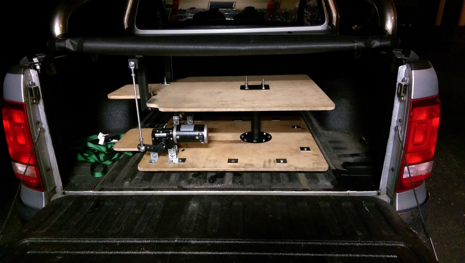

    I think you are correct regarding the material thickness on the lever's... they did flex a little when I took my monkey wrench (plumbers grip, dunno the english name for it) and twisted them... So I will probably have to reinforce them. But that is a minor problem :)
    Got the engines mounted and transported the beast home. Engines are mounted with M10 bolts into the steel frame under the bottom plate, so should not be any flex problems. Will change the flimsy M10 connectors with uniball's (rod ends) as soon as they arrive.
    Next up is wiring the electronics. Then hopefully get the thing to move :)

    Same goes for the mounting brackets, they are very thin material for the powerful motors you are using.
    I would suggest something like 6mm angle iron, 1 continuous mount per side rather than 4 separate right angle brackets.
    You will be surprised how much torque these brackets will need to withstand and a single bracket will help spread that load over the wooden frame.
  15. Nick Moxley
    17,056Coins
    +2,506 / 30 / -2
    For sheer referance, For MY setup on how i have my motor's bolted down, The thin angle was able to be twisted under motion, The Thick Angle....Lol not so much.

    Wow, is it that much force in action?
    Guess I'll upgrade the mounting brackets as well :)
    the load spread is no problem, as the M10 bolt goes through the mounting brackets, through the wooden frame and through the steel frame below the wooden frame, so the wooden frame is just for looks :)
    But I will most certainly improve the things you guys are pointing out :)

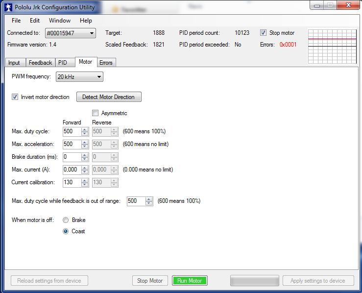

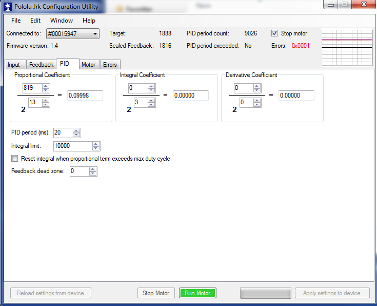

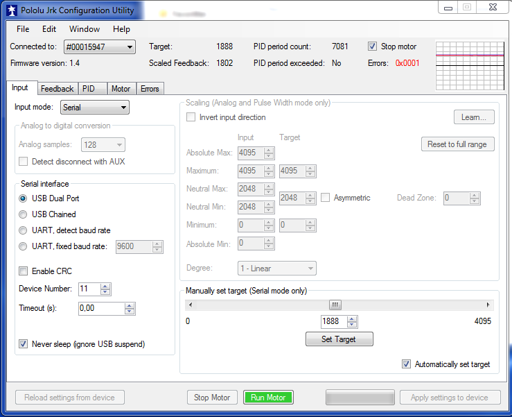

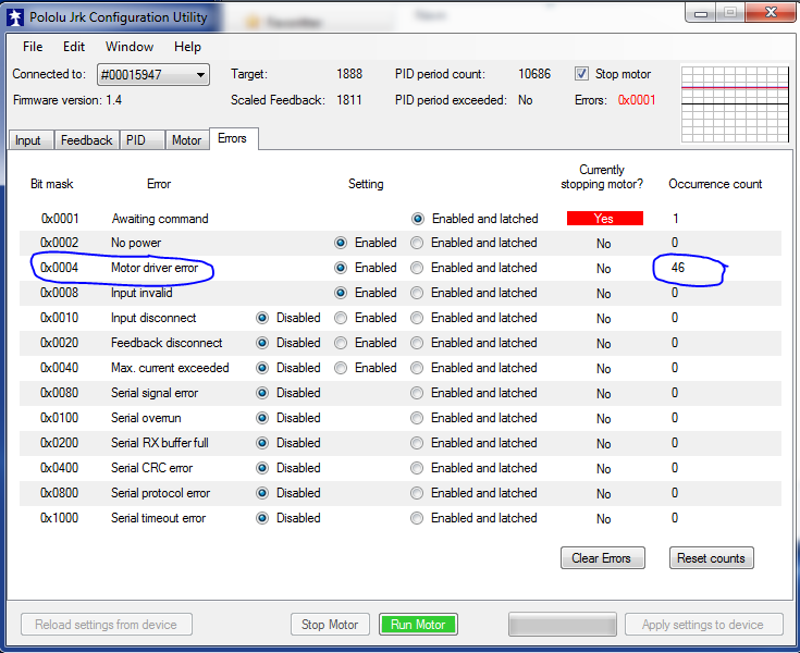

    Got the JRK's running, updated firmware so that all 3 is running 1.4
    Configured the pots and feedback looks good.
    But when I drag the slider back and forth quickly in the JRK configuration utility, the motors sometimes "stutter" and freezes in one direction. also makes a sound almost like the sound you get if you connect AC to a DC motor (trying to move back and forth really fast).
    I've followed eaorobbie's guide: http://www.xsimulator.net/community/threads/playseat-to-2-dofseat.5401/page-2#post-56352
    If I change the max duty cycle value to 200 (max is 600) I only managed to provoke this behavior once, while at 300 and above it is easy to provoke this behavior. Limiting max current to 10amp also worked, but both of these "fixes" resulted in slow movement.
    There should be plenty of power available as I use 2 x HP DPS-600PB 47A in parallel with current share/balancing and the test is with no load on the motor. (maybe that is the reason, not enough resistance on the motor?)
    In case of issues with the power I can put in a 1 fahrad 12v condensator left over from my car stereo, that should definitely fix any supply issues.
    So for now I'll just go ahead with the build and installing simtools, maybe this behavior is only in the JRK utility and not in real life with weight on the motor levers.

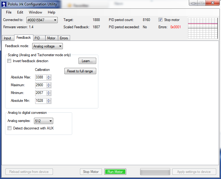

    Downloaded and looked at bsft's JRK guide.
    Started working with the values, but already at 0.1 P I managed to provoke the stuttering/twitching. Error 0x0004 Motor driver error occur at the same time as the stuttering.
    Same goes for both motor's / JRK's....
    I'm thinking that either the cheap pot's are to blame, or the power supply's.
    Didnt have time for much trouble shooting yesterday so will continue today by measuring voltage drop, a new pot, and so forth.
    My JRK settings, including the error page:
  20. noorbeast
    21,511
    150,686Coins
    +11,018 / 55 / -2
    The deliminator on the PID seems to be a , so have you tried a . instead? I am not sure if it makes a difference in JRK settings but I know it does in SimTools so give it a try.
    Just to start with try P = 0.39 I = 0 and D = 0.5
    If that seems OK go through @bsft's increments again.
