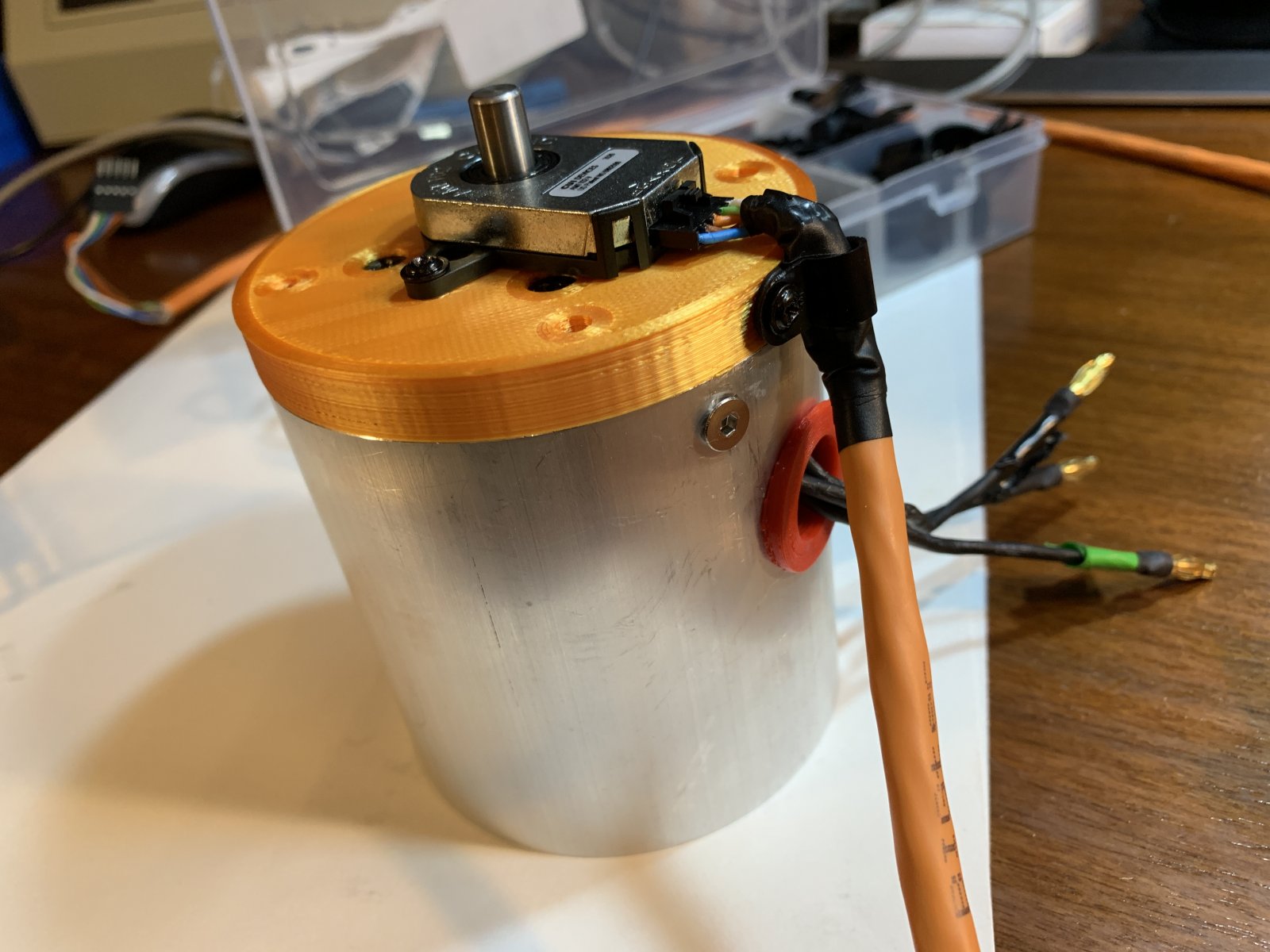

    I connect the Odrive, downloaded the shipping-configuration and tried to compare the json-file with the one supplied by SilentChill. First i wanted to adjust the settings to the current firmware but after I Saw that SilentChill used the same hardware revision I flashed it with the supplied firmware , loaded the json , changes some minor parameters, installed FlyPt-Mover, NoLimits-2 and … it Motors starts calibrating and then turning. So far so good.

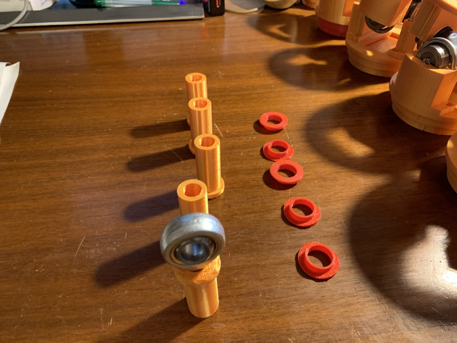

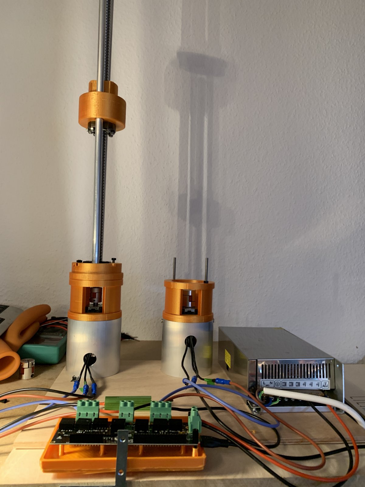

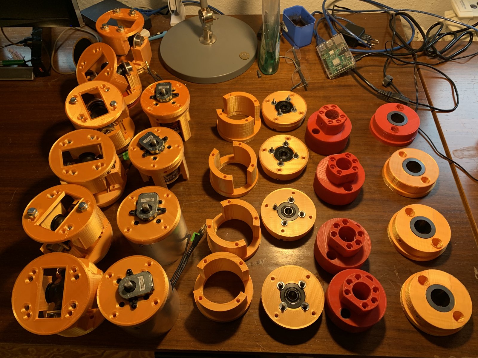

    Some progress:
    I finished printing :) and yesterday I got the last missing parts (ball screws).
    Build a test station with 2 Motors and one drive. Thanks to files provides by @SilentChill FlyPtMover runs on the first attempt.

    Teststation. Everything is fixed on the wooden plate. The drives have a lot of power. On the first test I forgot the reduce the power in the oDrive setup. Without screwing the drives this could have gone wrong.
    For further testing I will reduce max power .

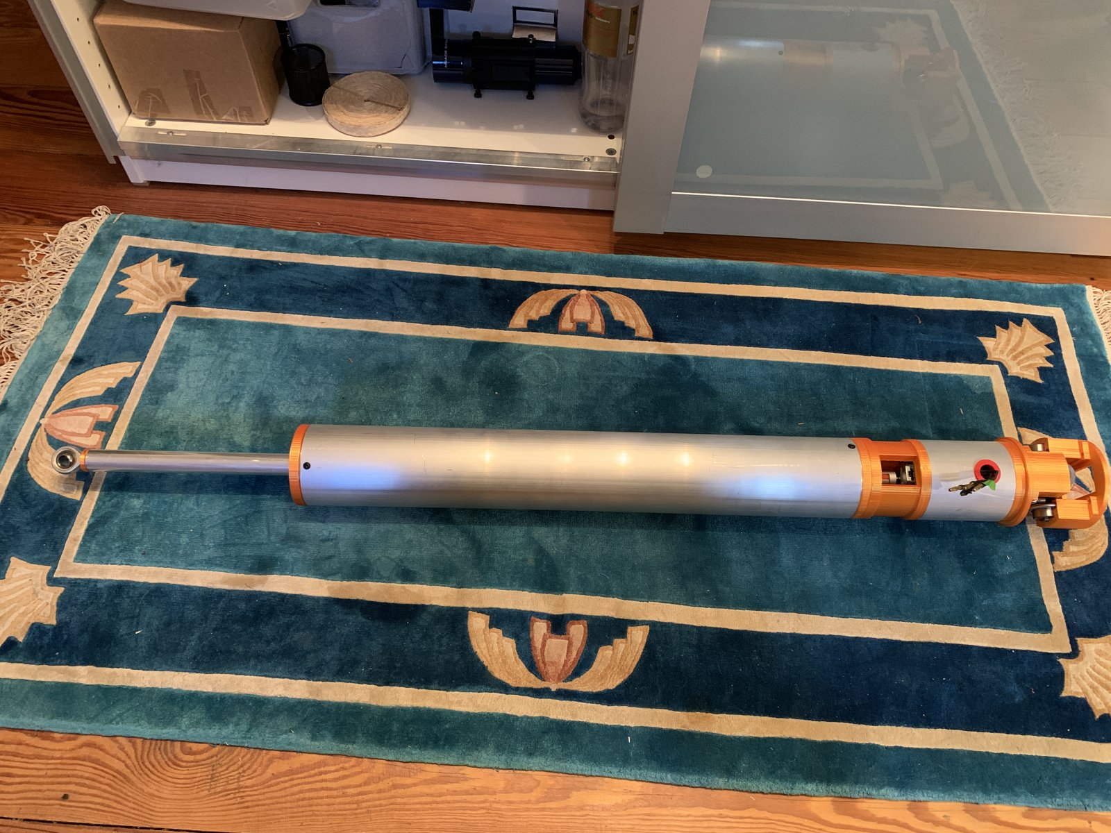

    First one finished :)

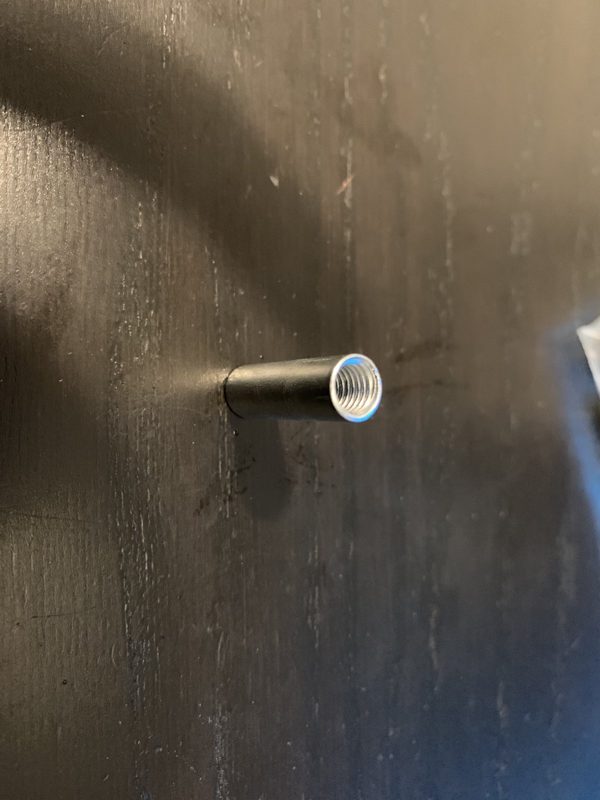

    Hi guys - possible a daft question, but whats the black part in the photo below? I can see it on the Sketchup but not in the parts list, so I'm not sure if its a 3D printed part or a bearing.
  16. EricSteijlen
    EricSteijlen New Member
    Jan 1, 2017
    26
    Lembras, France
    986Coins
    +25 / 0 / -0
  17. dsr999
