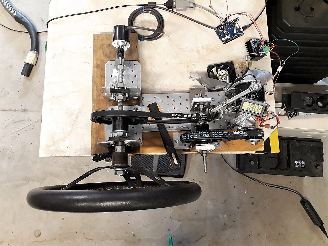

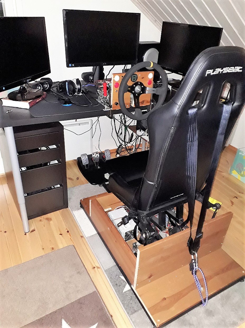

    Hello everyone!
    After reading all the great stuff of Arduino based FFB-Wheel, i started my own project.
    My steering wheel, for many years has been Logitech G25, which i've been very happy with...although i hardly even used ffb with it. G25 has very annoying rattle-noise when effect-level raises.
    Low-cost is the key here.

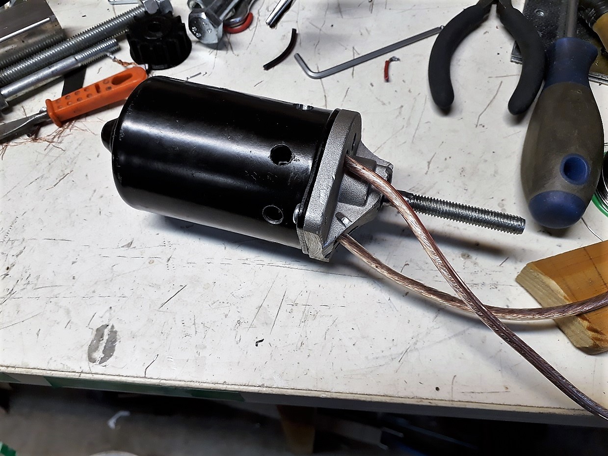

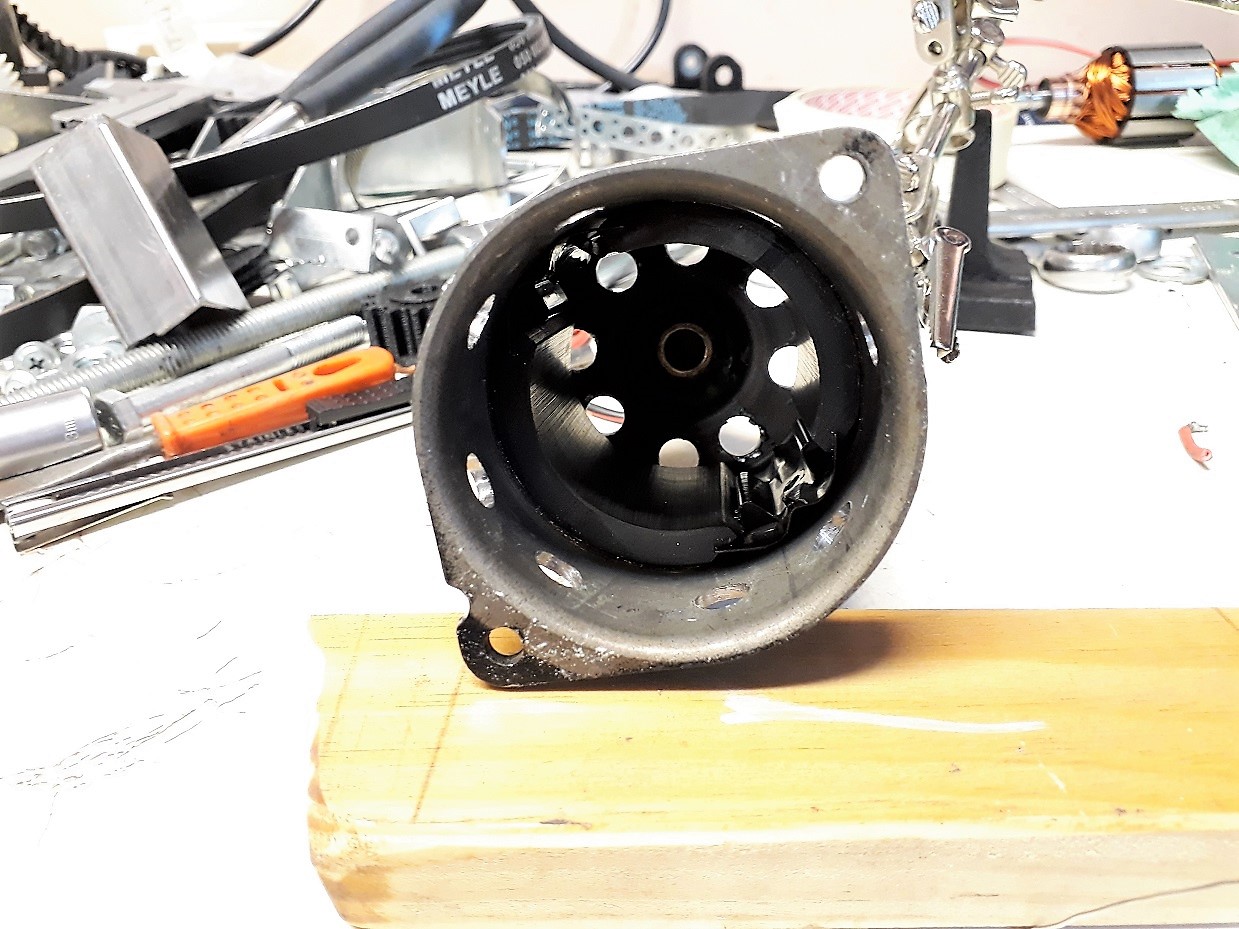

    Started with ordering Leonardo-board + some stuff like encoder and prepairing my wipermotor (~40w) for DD-test.
    DD was fail. Barely no torque at all -> So i did quick winch-motor test (power about 1kw) which suprisingly had almost equally low torque at 0 rpm....it did draw lots of current and got hot instantly -> no go.

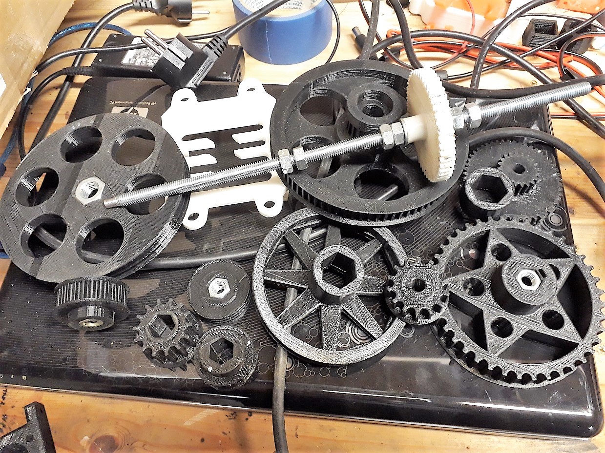

    So, after few iterations i did gear reducers for wiper motor with 3d-printer (gears, v-belt- and finally tooth belt pulleys)
    In the same time i did some research of games that were good with ffb and playable with low-end laptop, which i used in my workshop. Supprisingly this very old racing title rFactor came up with plugins like RealFeel + Leo's FFB... Just amazing, how different that made game feel and i mean it felt better in all terms (in my opinion even better than PCARS/PCARS2/AC).
    Final gear reduction is about 16 and on my 350mm wheel that means a bit over 6kg stall-force, measured on outer side of rim.

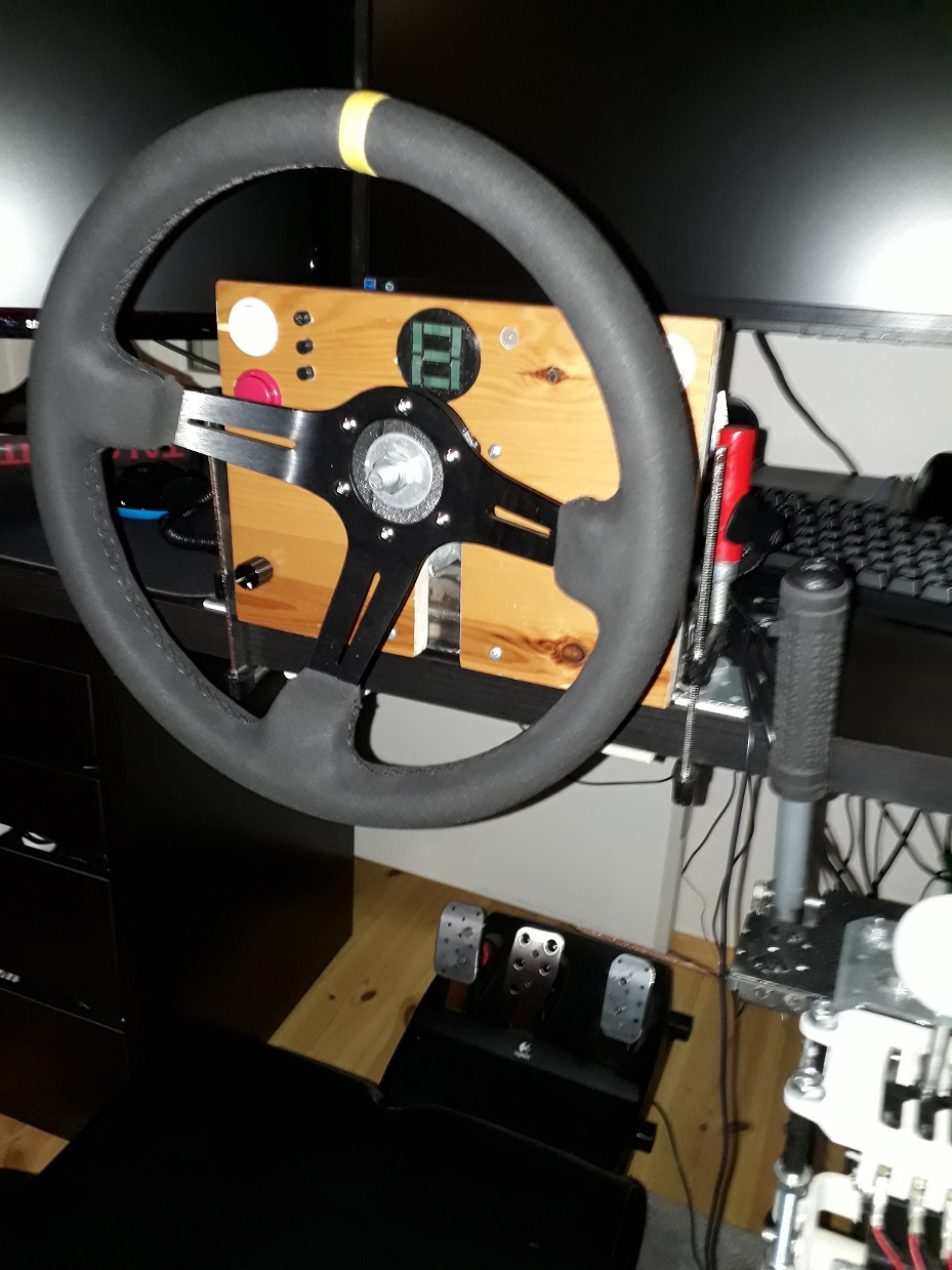

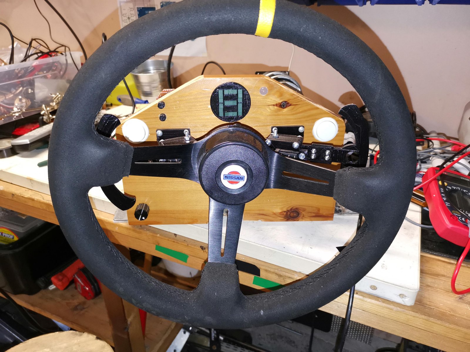

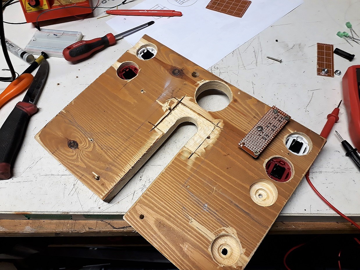

    I integrated another arduino-board for shift-light + gear-indicator, which i put on face-plate.
    Pedals are from G25, shifter is another project mixed with metal / 3d-print, connected via zero delay usb-board to pc.
    After extensive fiddling, all started to work quite well together, although the looks of the wheel is VERY clumsy.
    I may add some pictures/info later, but it is what it is ;)

    Hi!
    I have been burning several Leonardo-boards lately. Finally i concluded that it was because of misbehaving sim-motor... When sim-motor had major erratic movement (basicly sparks on carbon brush, misalignment) -> burnt leonardo on other usb port, sigh...
    Well, after fixing things, i have been driving and tuning wheel and sim.
    Usually i have around 60% max power in use. Some games has lots on inertia in their force, then i have tune that down and other has lots of static friction, so sometimes that needs reduction, otherwise quick steering is too hard :)

    is that 3d printed pulley..??
    what is reduction spec..??

    nice setup btw...
    my wheel only 3kg on 13inch wheel (4.6 Nm max) on 500watt motor...
