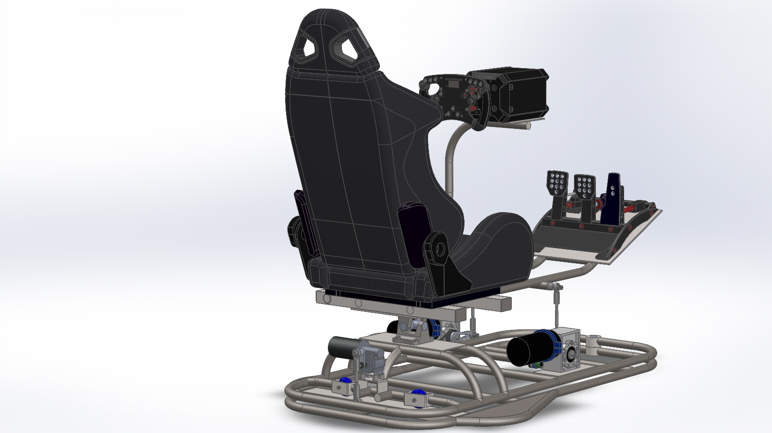

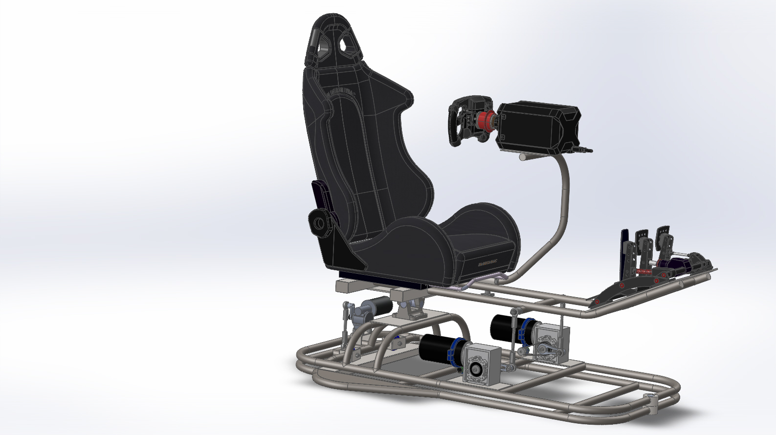

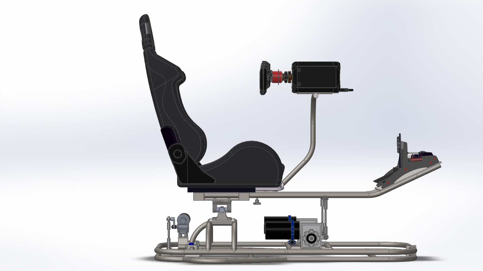

    Almost done with the design. Still have a couple odds and ends to clean up but I'm liking it. Would be awesome if you veterans would look it over and alert me of any issue you may see.
    It has the following for motion range.
    Pitch= 15 degress
    Roll= 25 degrees
    YAW= 15 degrees

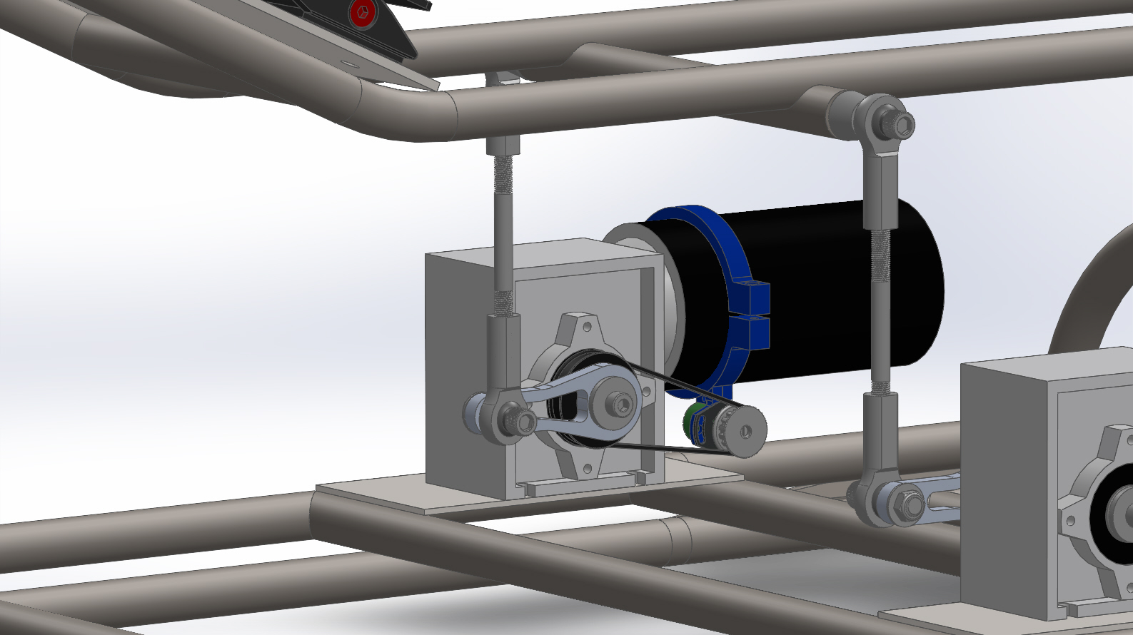

    The front motors are 24v 300W with 30:1 gearboxes @ 100 rpm rated speed. With a 70mm lever, that gives me 733mm/s.
    The rear motor is a 24v 100w with 20:1 gearbox @ 180rpm rated speed. A 40mm lever gives me 753mm/s.

    Hi. Nice project, I keep my fingers crossed for it to come into being. Everything's fine, but how will the rear engine work?

    Yes, that rotation into translation, it's not going to work, unless you do a curved base for the wheels.
