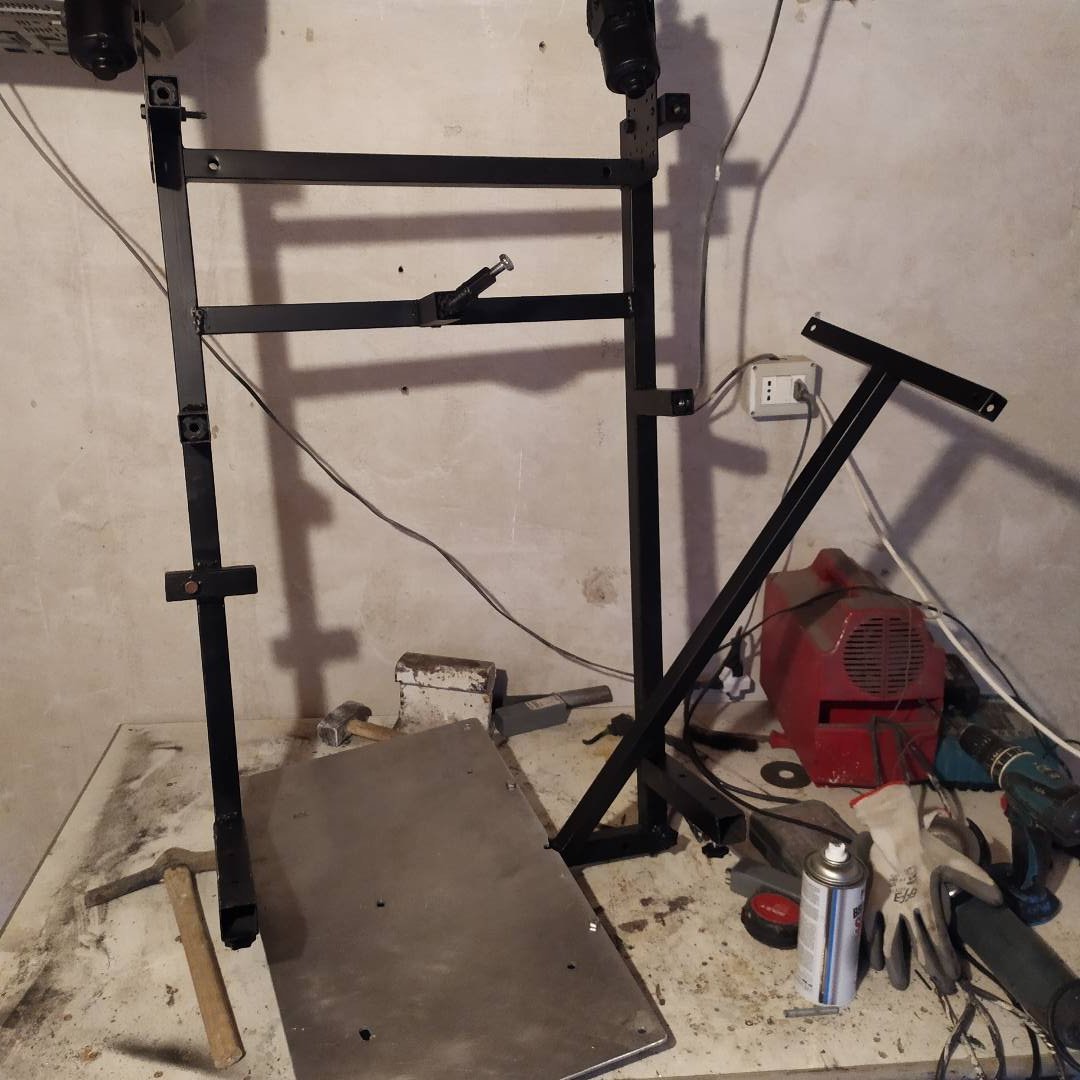

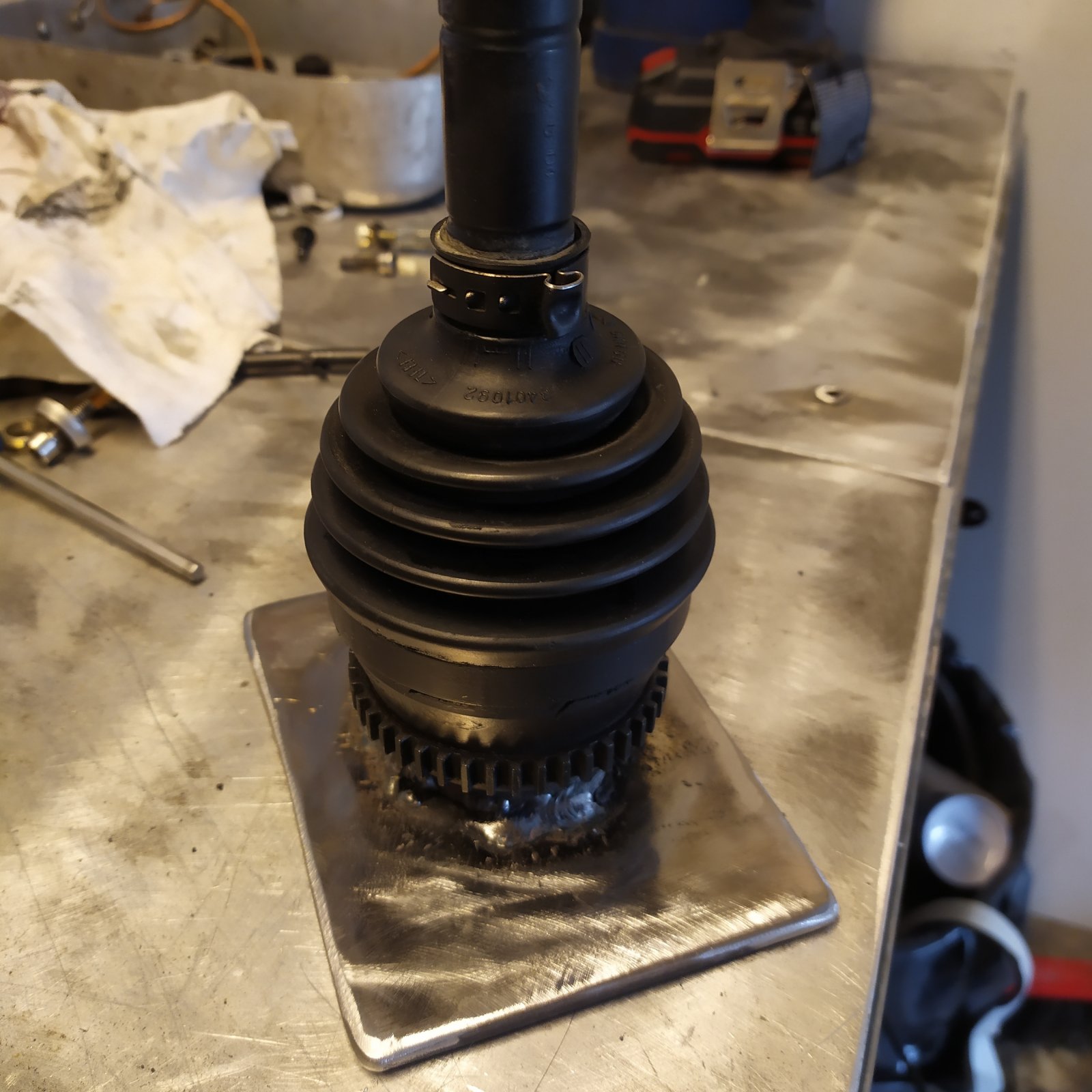

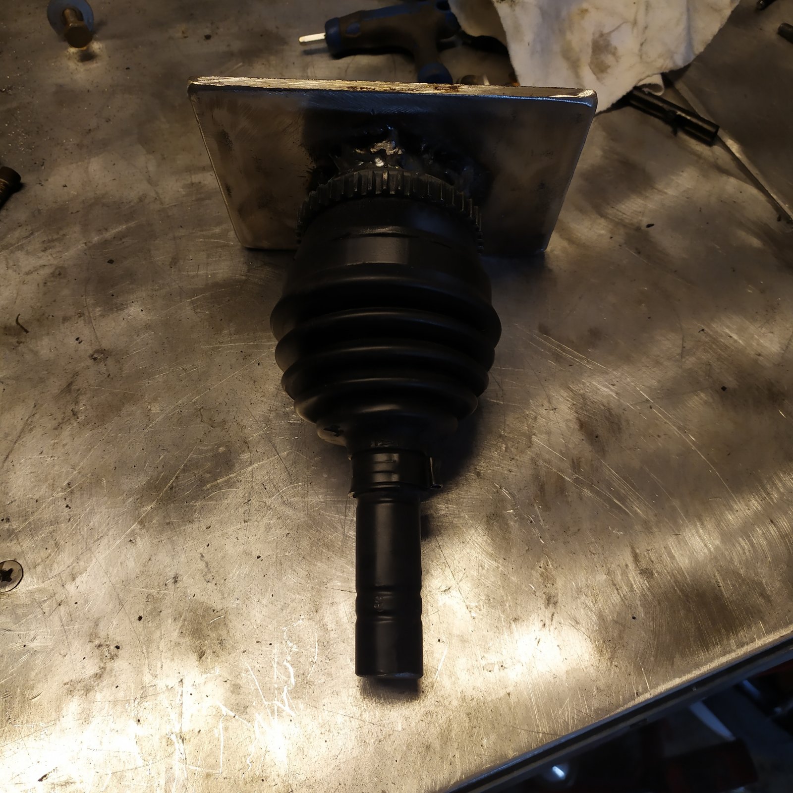

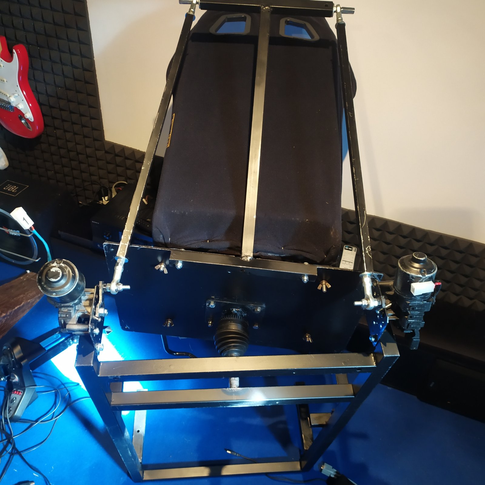

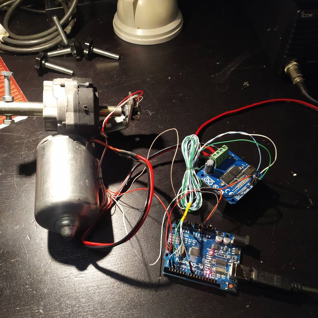

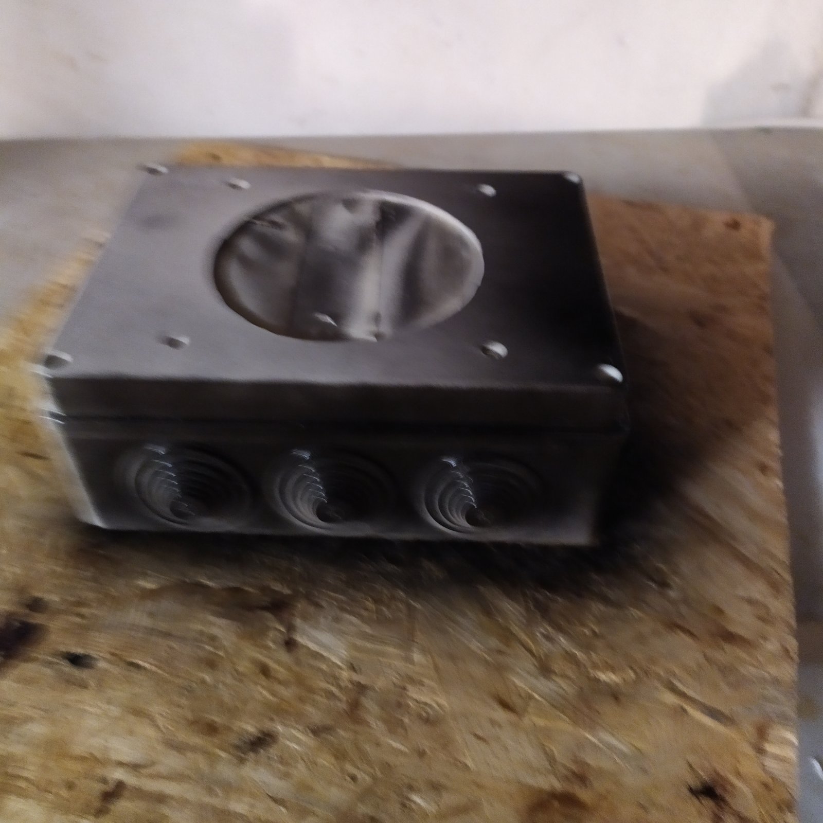

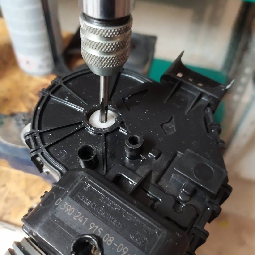

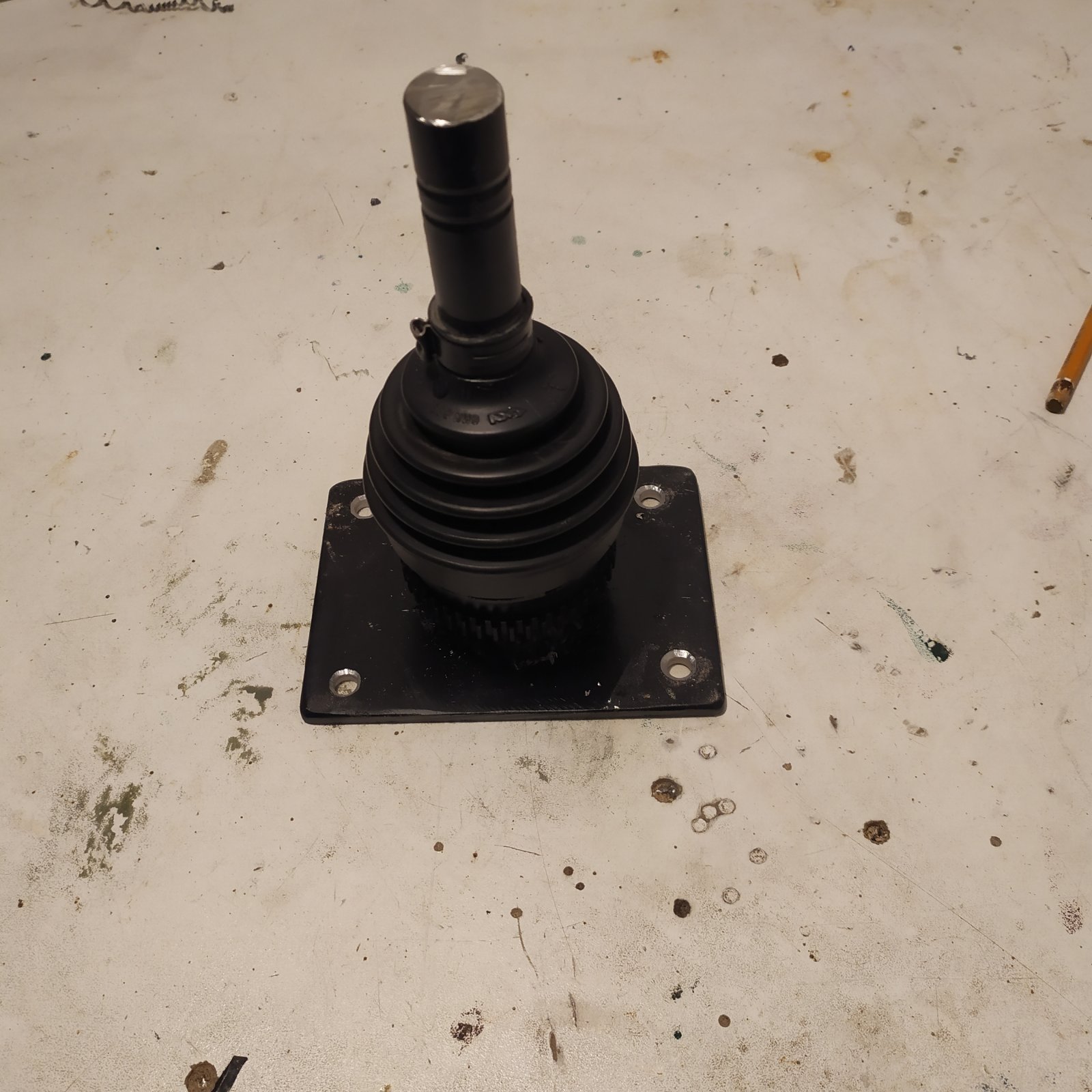

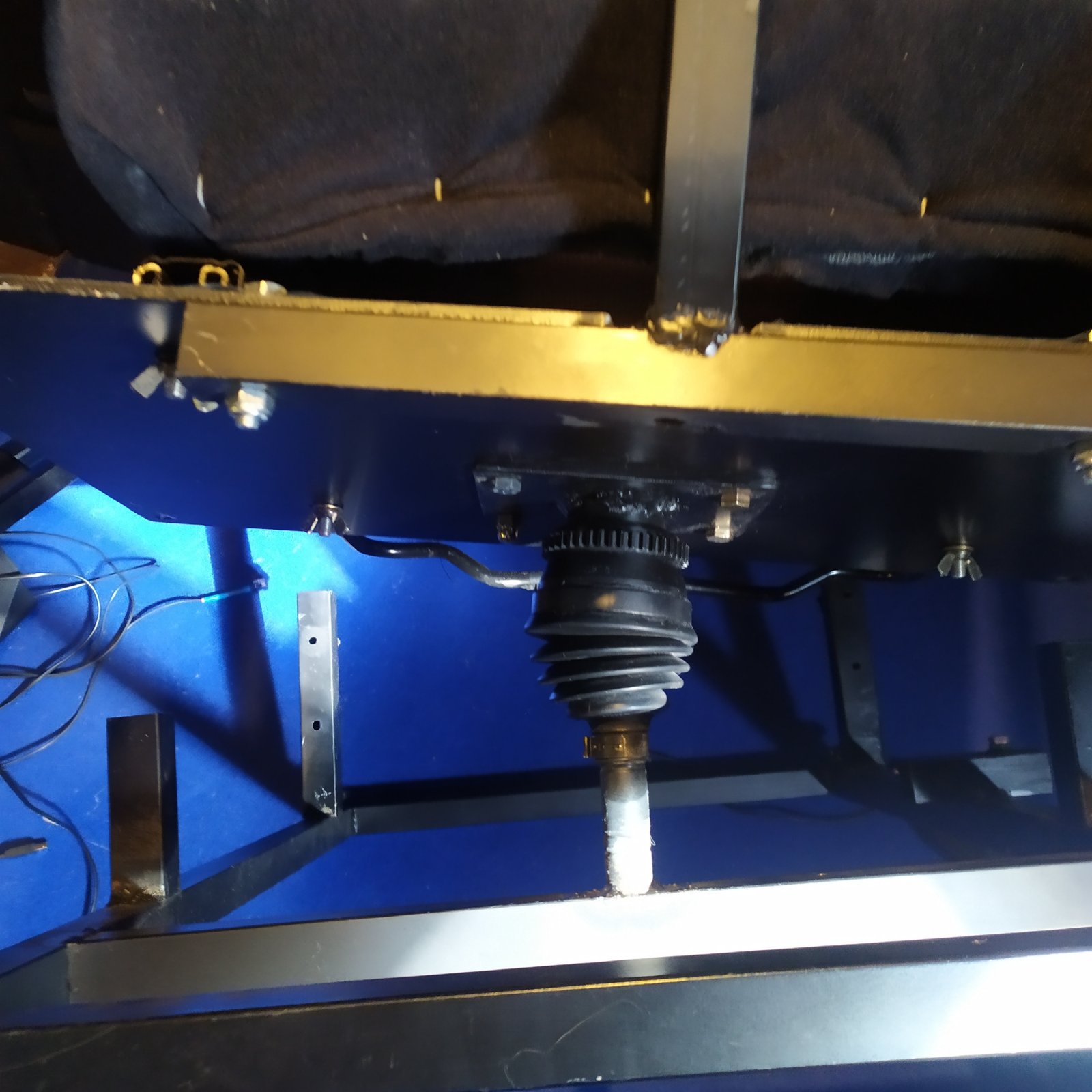

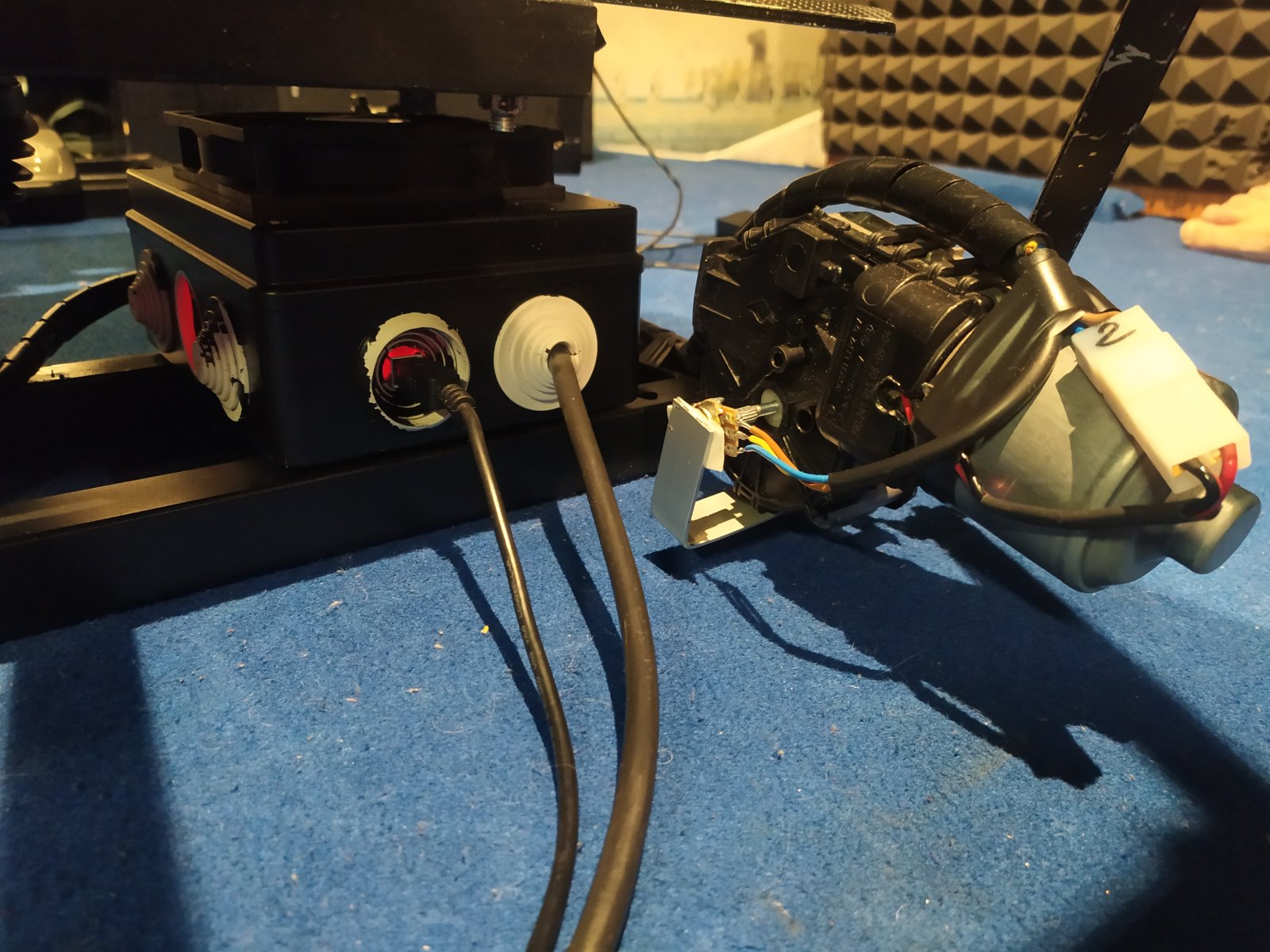

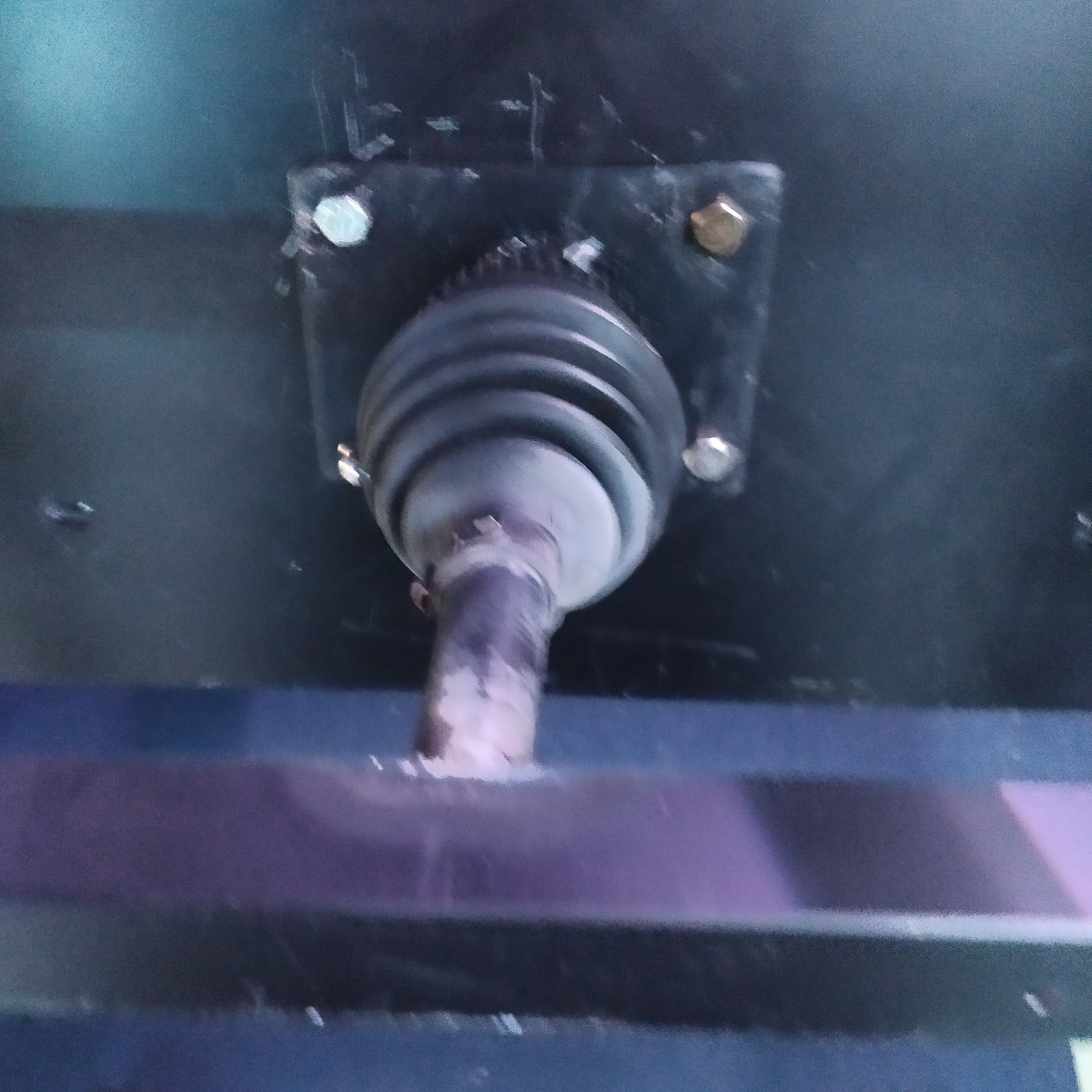

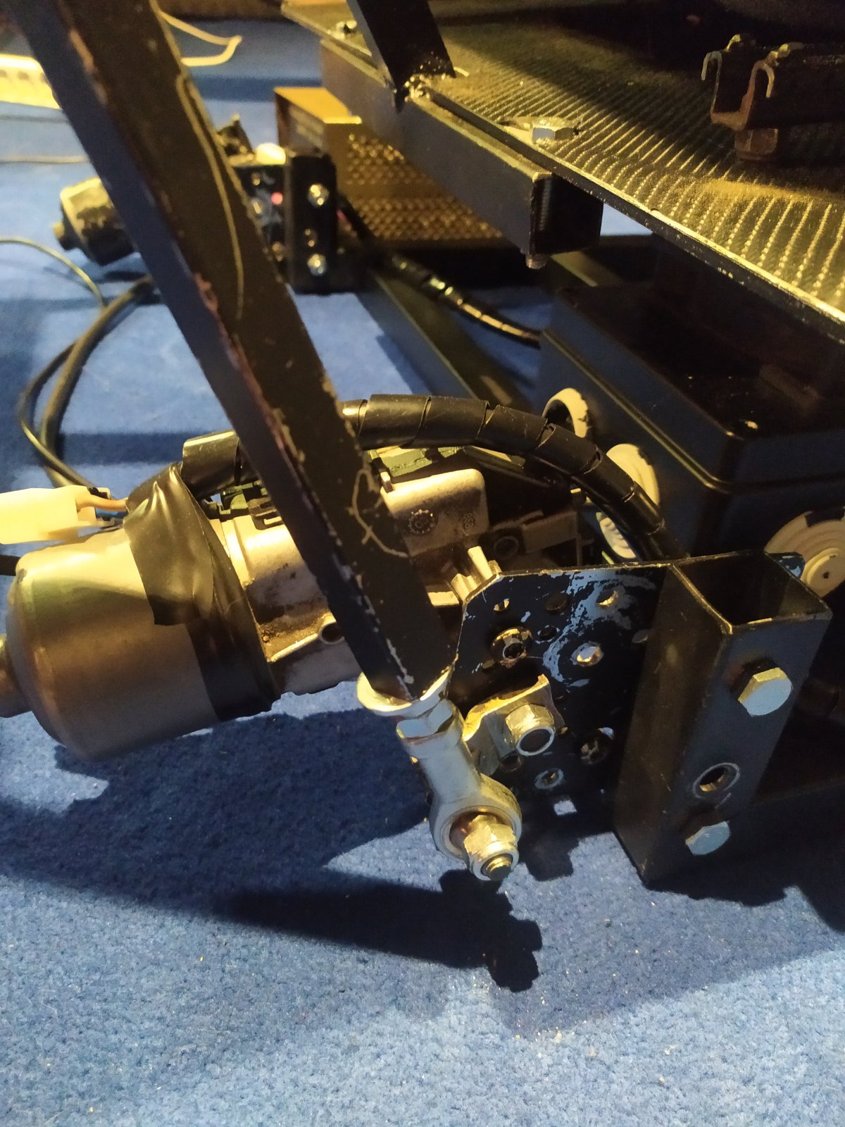

    hello guys a picture is more than a thousand words and here is the efforts of a beginner who has succeeded in the enterprise.
    abbraccio:

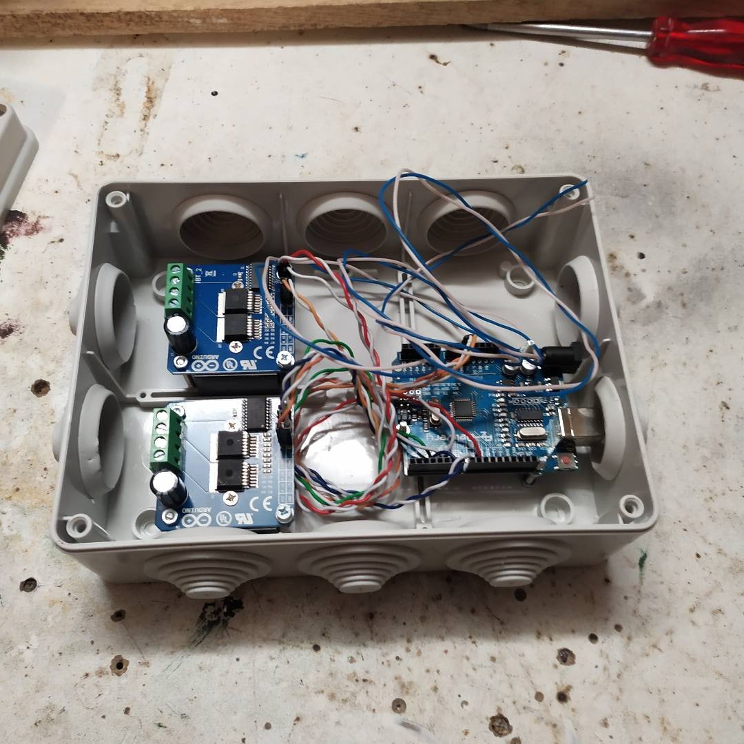

    arduino+smc3
    ibt2 BTS7960
    wiper ALFA 159 BOSCH
    drive shaft FIAT PANDA
    seat SPARCO JUNIOR
    and a lot of iron.
    special thanks to NOORBEAST for the help :cheers

    Nice work, thanks for sharing your rig :thumbs
    Are the motors ground isolated?
    Is that double sided tape holding the pot in place, if so does it flex?
    Any chance of a video of your rig in action, when you have the time?

    this is the link video:
    it was a problem ground isolated of the engines that made me waste a lot of time but I managed to solve it.
    the double sided tape is a temporary solution I am considering to modify the bracket and fix them with their nut.
    sure that this is easier to calibrate them.
