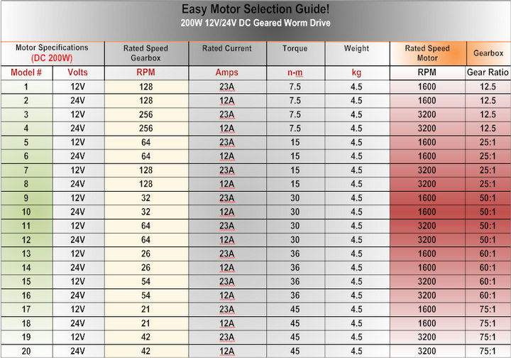

    Hallo,
    I 'm reading the selection guide of their dc worm drive geared box https://www.motiondynamics.com.au/1...ve-geared-motor-200w-21-256-rpm-7.5-45nm.html
    But I don't understand something.
    In this r selection guide they specify that motors are 200W . The 12V motors are 23A rated current and 24V motors ara 12A rated current
    Ampere = Watt/Volt correct?
    200W/12V=16,66A and not 23A
    so if the 23A is correct for 12V motors this should mean the motor have 276W and not 200W
    as 23Ax12V=276W
    What i do not understand?

    what you get from calculations is the operating current ...
    The term rated in any electrical equipment,whether its RATED VOLTAGE or RATED CURRENT means it is the maximum value of current,voltage or any other parameter beyond which the motor will not be operating according to its desired operation.
    Rated current is the capacity of the equipment it is designed to operate safely.
    The operating current is the actual current drawn while in operation.
    Beyond the rated value the motor may have some faults or damages in winding ...
    Also it is not acceptable to run the motor on the rated current for a long time ...

    Hi speedy thanks for your reply.
    RATED CURRENT and NOMINAL CURRENT are the same thing?
    So please see the file i upload now. 12V 180W nominal current 23A - peak current 40A

    if Ampere = Watt/Volt
    Last question sorry...only to let me undertsand correctly.
    if Ampere = Watt/Volt ... a motor that have 180W/12V means that its current is 15A (180:12=15)
    The value that I obtain dividing Watts by Volts how can be defining? According to what you written it is not
    rated or nominal current. So how can it be defining?

    Normally manufacturers provide numbers and information that can't be easily measured or calculated like you did ...
    That's why you have two numbers now :cheers .
    Edit : They have provided the Watt and Voltage [then you can calculate the operating current] ... then provided the rated current [ where you should be aware of without actually damaging the motor ] ...
    You can also calculate the internal resistance if you need Voltage = R * I .
    That doesn't mean you can't go beyond RATED voltage or current limits for a few seconds then go back ... but that should be on rare occasions only .

    but the current that I obtain dividing watts by volts what is? 200W/12V result 15A . What is 15A? rated or nominal current? probably no, as in the data sheet they specify that their motors 200W 12V have 23A rated current.

    IT IS THE OPERATING CURRENT

    There is efficienty to . Motor delivers 200w and ask 23 amp rated
